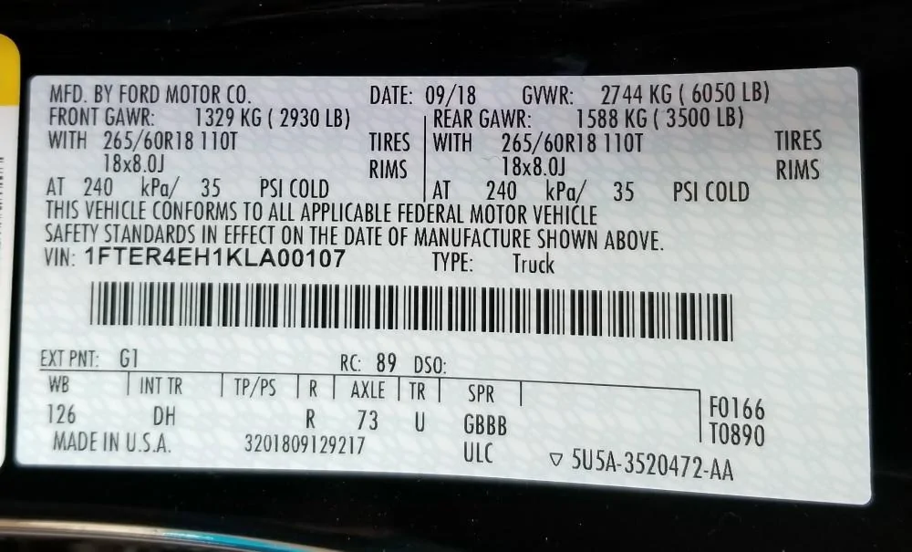

I have a February Build, but how do I determine the build date? I checked all my paperwork and short of calling the dealer to check for me...is there a way I can determine if my build was after 2/11/19...I suspect it is as I do not have any severe symptoms as described in the TSB... I tried my contacts inside the company but they were not able to help me.
best,
Phil Schilke
Ranger Vehicle Engineering
Ford Motor Co. Retired
Can't you refer to the FMVSS Certification sticker on the Drivers door pillar? By law it includes the vehicle build date. In the attached example, its 09/18.
Hi,
The TSB is very specific...My label has 2/19.... TSB is before 2/11/19...Month and year do not cut it for applicability.

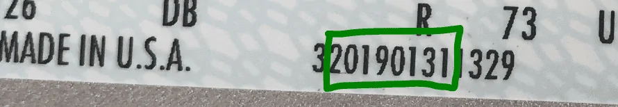

The exact day is at the bottom of the sticker. 01/31/2019 on mine.
And on the window sticker.
2019 01 31 (01/31/2019)
