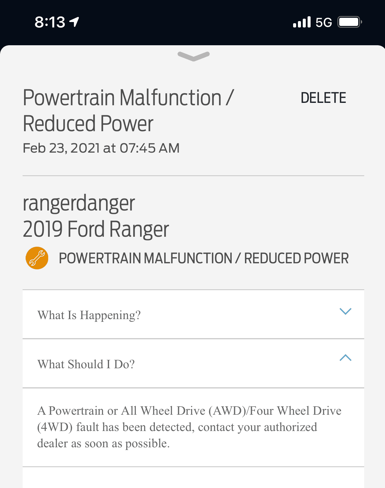

This has been happening for 6 months and I was going crazy thinking it would go away in Spring. But it's been in the 40s most mornings this Winter and today I finally got this lovely notification in my FordPass app.
I have an appointment to get this TSB applied tomorrow.

I got my truck back from the service department, I brought a printed copy of the TSB with me. They did a road test and were able to replicate the issue.
They applied the PCM update and it shifts so smoothly now.

What caused the MIL?
rangerdanger
Oct 9, 2018
194
3,487
2,660
SF Bay Area
The rear wheels were slipping due to the sudden power drops and surges from the transmission. I also got Traction Control warnings too. So the system thought it was an issue with the 4x4 system.
