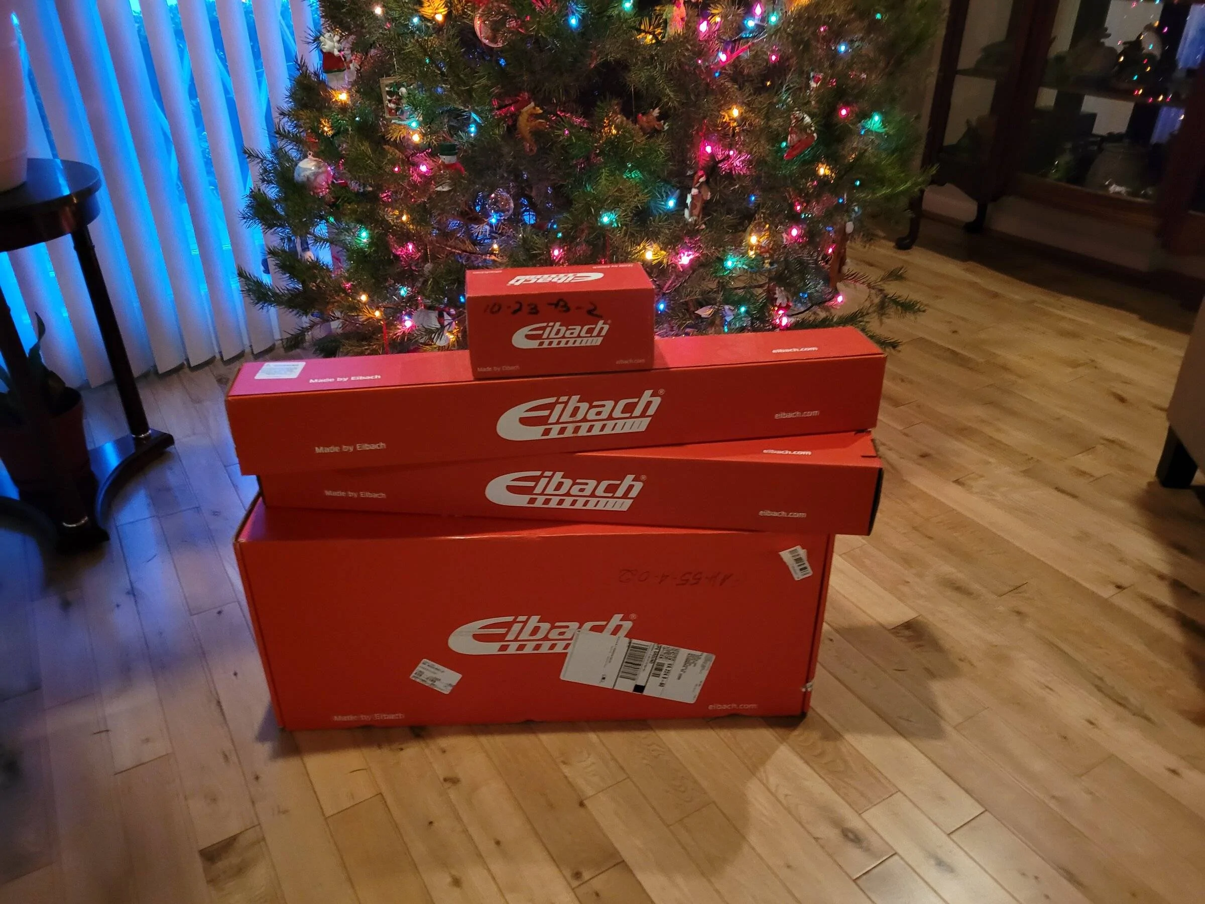

Installed Eibach's on my Ranger yesterday set at 1.5". Much improve ride!
Did you buy the kit already to install or the one that you have to disassemble your strut?
