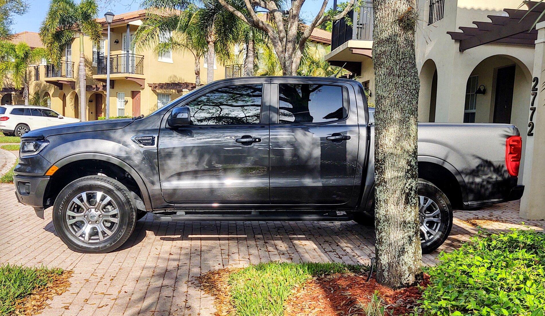

I installed the Eibach rears today. Noticeable difference in ride and reduction in wallow. If I pushed the side of the truck to rock it with OEM, it rocked 5 times before it stopped. Now it is half that.
Contemplating doing the fronts next. 2020 XLT RWD Supercab.

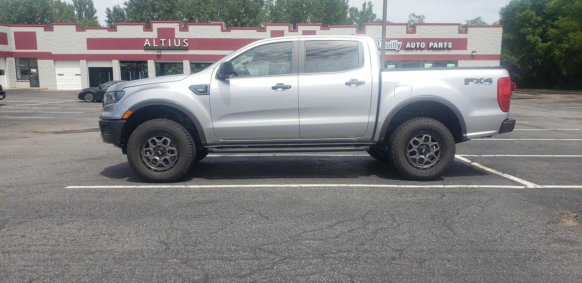

I finally got around to having a local shop install my fronts and doing the alignment. Worked out a cash discount ahead of time - most shops don't want to do work when they don't sell you the accessory so I had to shop around a bit.
The headlight alignment was easily done myself.
I obsessed way to much whether to go to the second from the highest snap ring setting or the middle one - it wasn't so much about the appearance although that had something to do with it ?- I wanted to retain some rake for highway gas mileage and in anticipation of towing.
Right now I feel I made the best decision - the middle setting with the factory springs and the pre-loading of the suspension it's a bit stiffer but the damping is very good. The personality of the truck's road manors is a little more rugged.
Interesting what just under 2 inches of front end lift has done for the perception of size of the Ranger from behind the wheel. Cornering is different too and now I want to get the Prothane swaybar bushings on to 'fix' the slight shift in understeer.

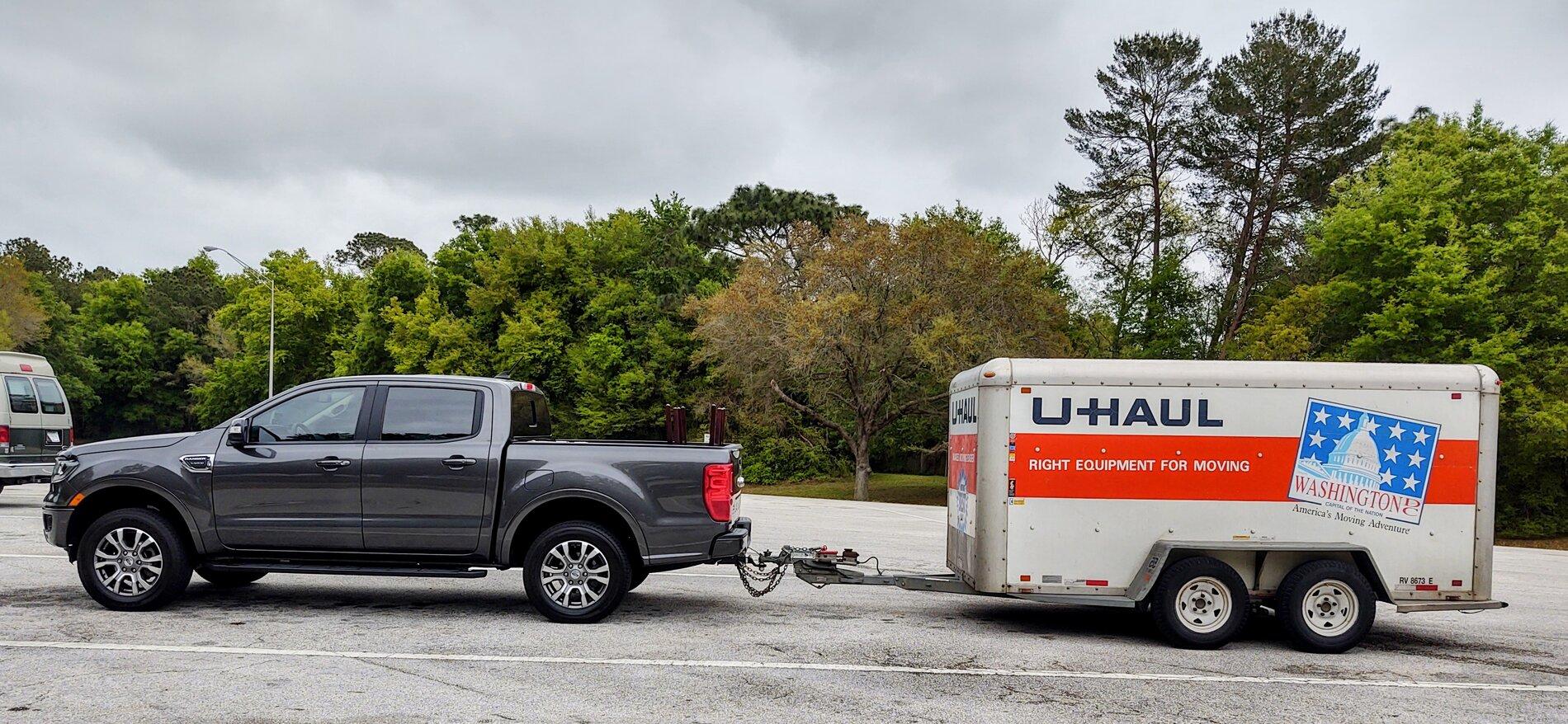

Following up I was only slightly concerned about what towing would do to the stance. (1.5 inch front lift)
No problem:

Any idea what your tongue weight was with that trailer?

Eh, the 6x12 was only rated for 2500 lbs I think? It was full end to end and to the top with a freezer, furniture, books and clothes among other things.

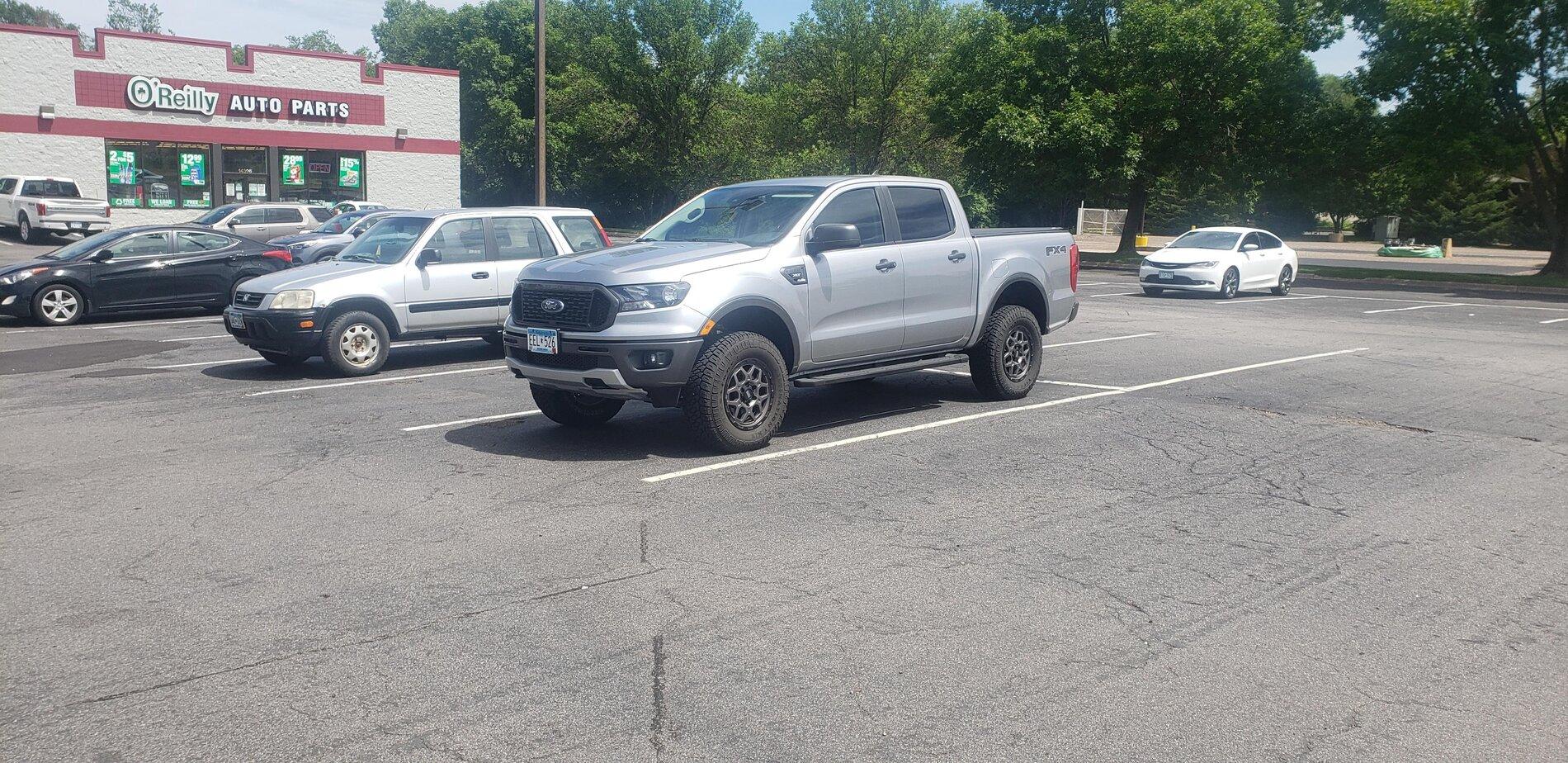

so for me i have had 5 f150s since 2012 all of them had shocks swapped for Bilstein, i have yet to like any shock ford uses. with that said i bought the fx4 and the shocks were so soft i hated the truck for it. it always seemed to be all over the road and never settled.
i waited for Bilstein and they didnt seem to have anything for the ranger
so we went with Eibach they sure look like Bilstein shocks. so for me i would rather have a road holding truck then a bouncy soft truck and the Eibach works great, you will feel the road, it is firm, but for me that is a good thing. firm does not mean hard, it means firm and it absorbs bumps very well. this truck will see off road almost never as i live in MN and we really have nowhere to go for that sort of stuff. so road manners for me is where i try to make my truck work. so this is with the factory springs and 1.5 lift, fits in my garage with about an inch to spare.
i will also add the kit with springs is a 3in lift only and the bare strut with factory springs gives you all the options for lift. do not buy the kit with springs if you dont want 3in of lift
Looks awesome! Do you mind me asking what size tires these are? Really leaning toward 1.5 setting
