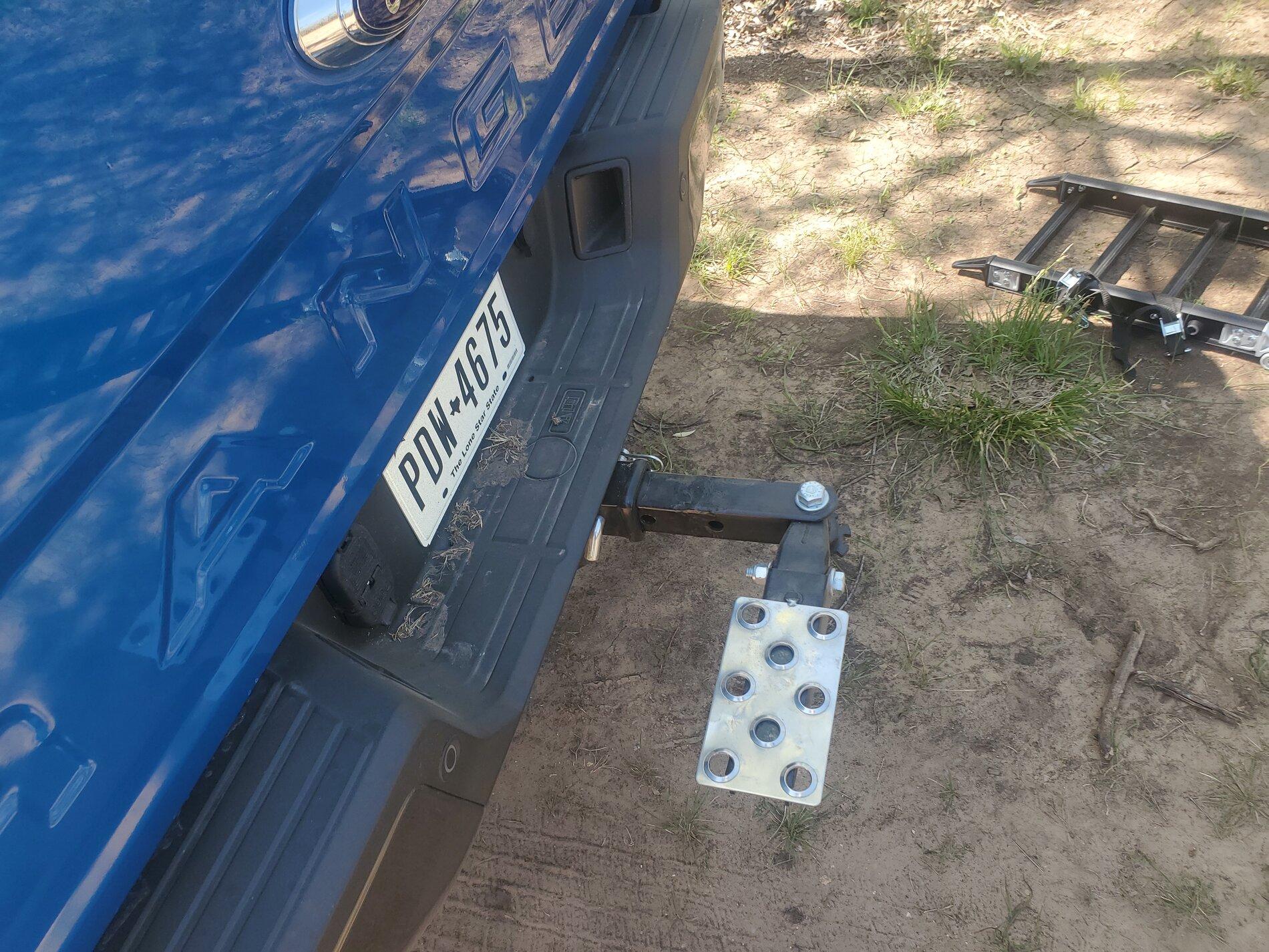

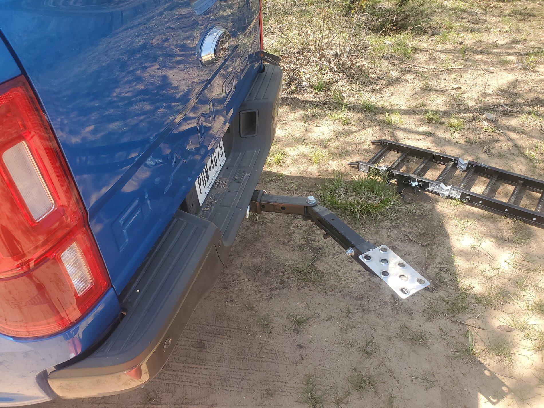

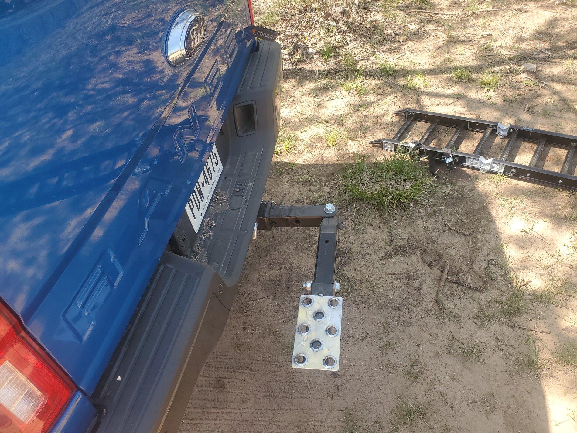

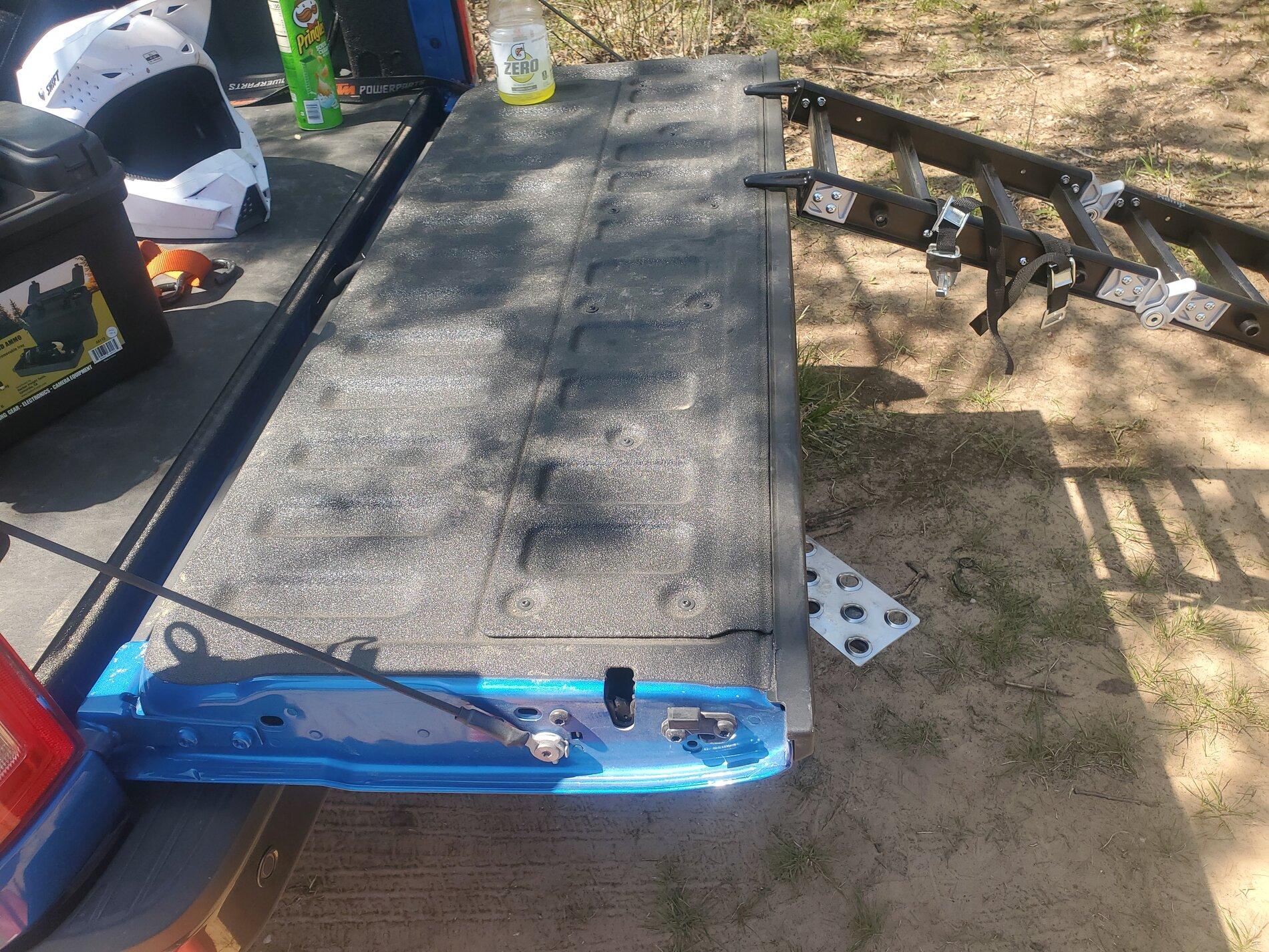

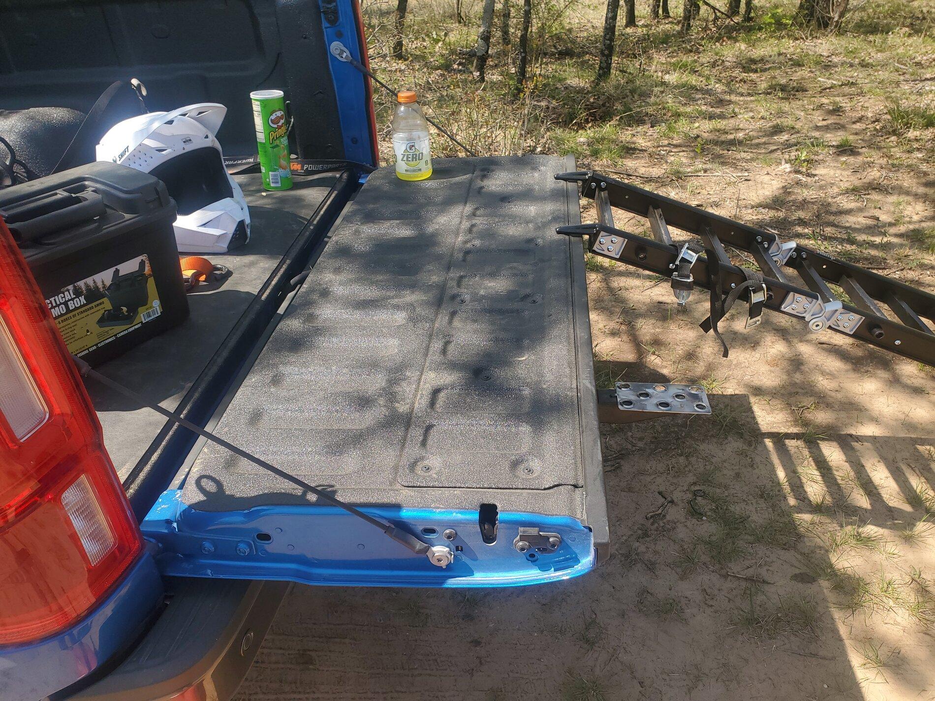

Here is my solution.. hitch mounted step made by BULLY, found in a tractor supply.
Please note that I lengthened the part that attaches to the truck by Welding a bit of 2"square tubing and drilling some extra holes. As it shipped, it only extended past the tailgate when it was straight, about as much as the picture of my extended one shows for when it is angled. And when folded it was about an inch away from the bumper. I can bring it in one hole, but I can't use the original hole because it hits the spare tire.
You could leave it in folded to the side all the time (with a locking pin). I just use it when hauling motorcycles, so I can step into the bed while powering the bike up the ramp.
