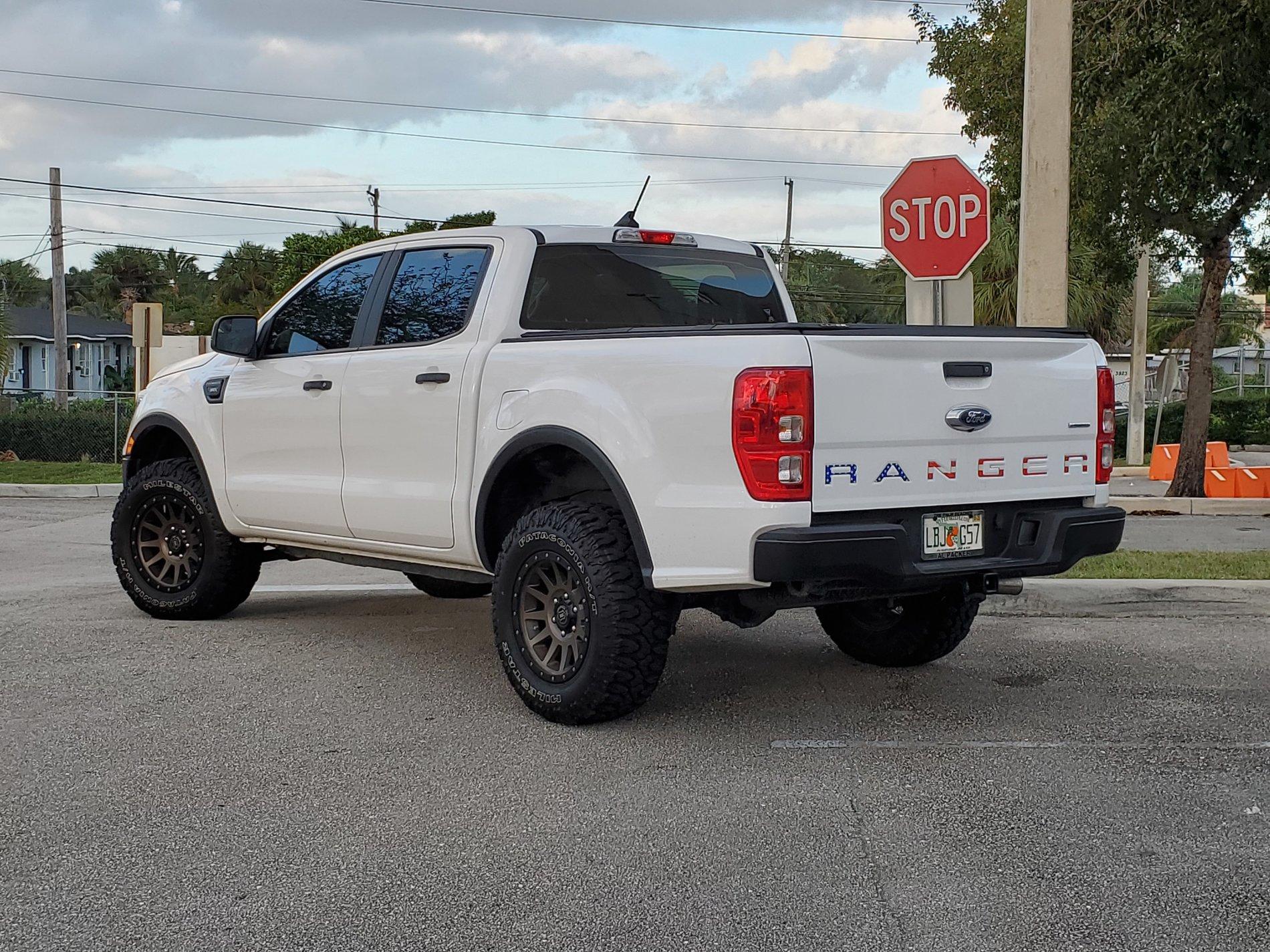

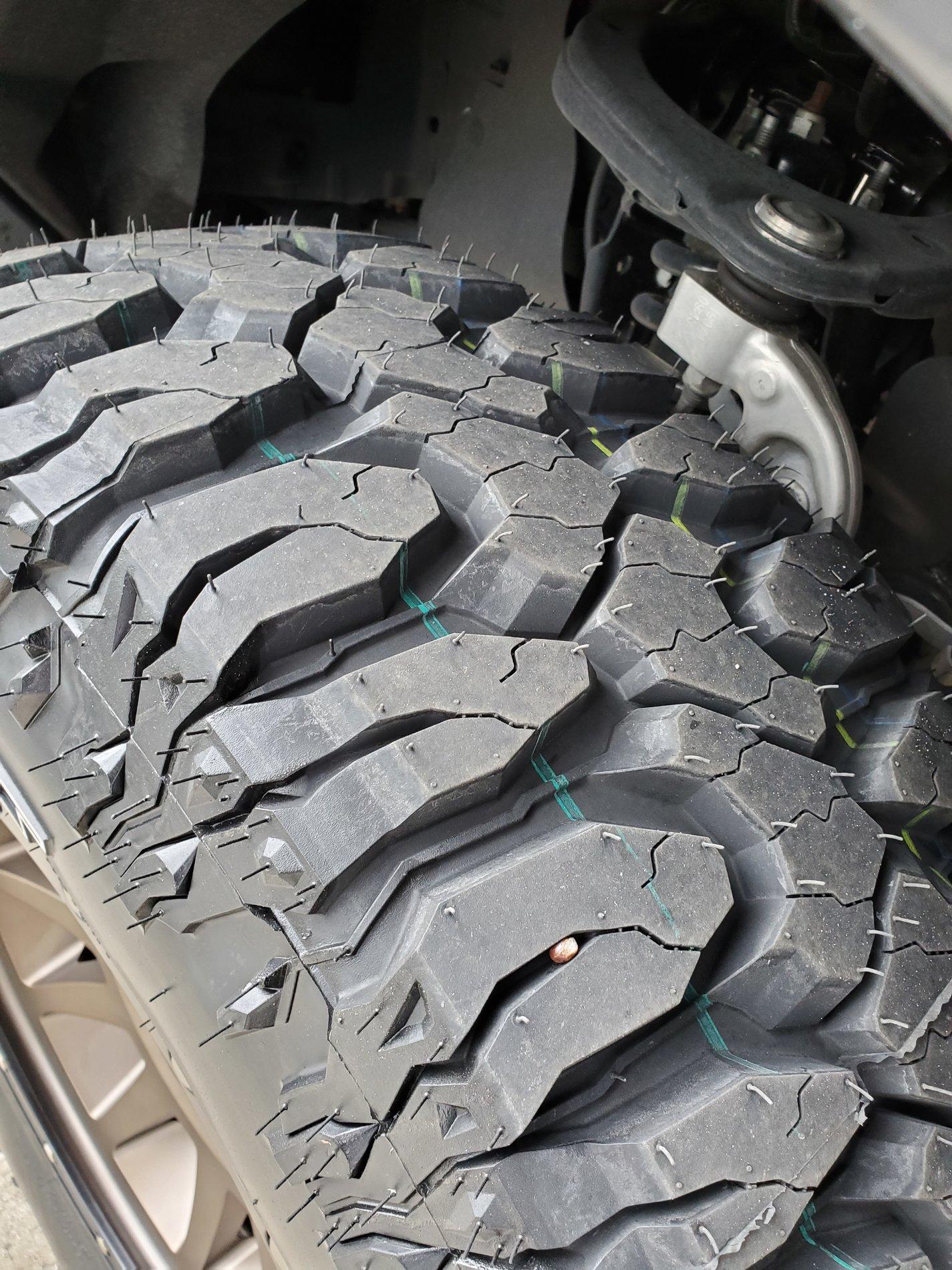

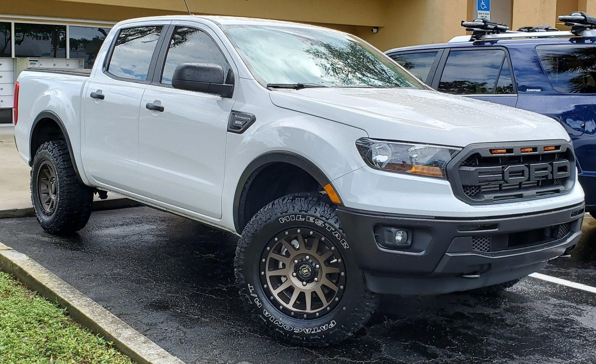

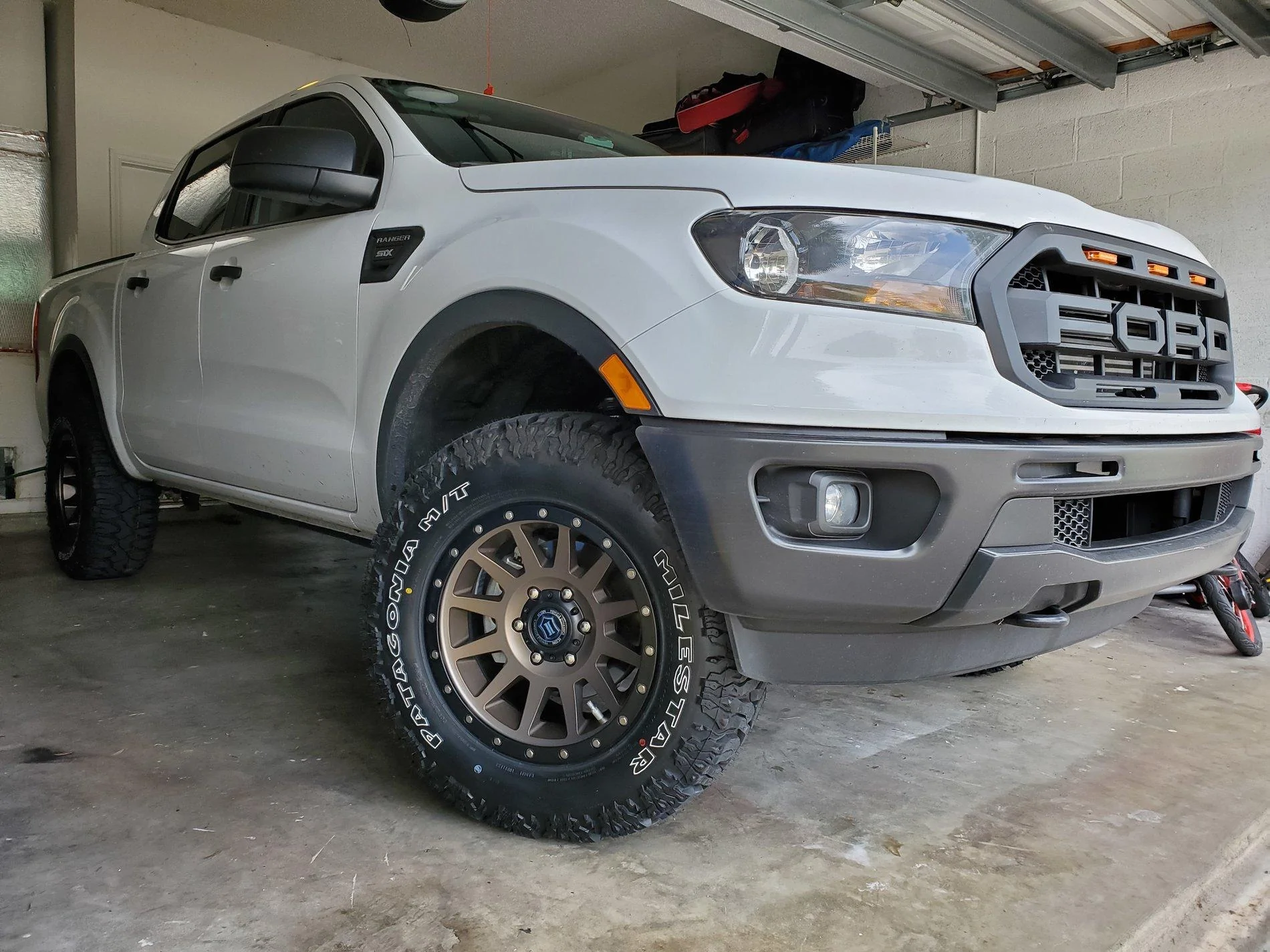

Well after running my setup for 2000 miles already, I figured I can post it as successful.
Level/Lift = SVC Collars (2" Level) (https://svcoffroad.com/collections/ford-ranger-suspension/products/2019-ford-ranger-leveling-collar)
Wheels = Icon Ranger Spec Compressions (2017858357BR) (http://iconvehicledynamics.com/shop/iconalloys-wheels/1354-compression-17-bronze-finish.html)
Wheel Spec - 17"x8.5" - 6x5.5 Bolt Pattern (Ranger) - 93.1mm Hub Bore (Ranger) - Backspace 5.75" - Offset 25mm. (Stock Ranger is 55mm)
Tires = Milestar Patagonia Mud Terrain (M/T) - 265/70/R17 - (32x10.5 equiv) - They weigh almost 60lb each. (Dueller HT 255/65/17s weigh 33lb each) (https://www.discounttiredirect.com/buy-tires/milestar-patagonia-m-t)
No cutting Bars No Rubbing at either lock. (Had to gently nudge one of the front crash bars forward with a hammer (Not bend, just slide it in the bolted slots), the other side was already forward enough to not rub.
The stance puts the top edge of the tread right at the wheel wells, the side-wall etc protrude.
All in all, I am happy.

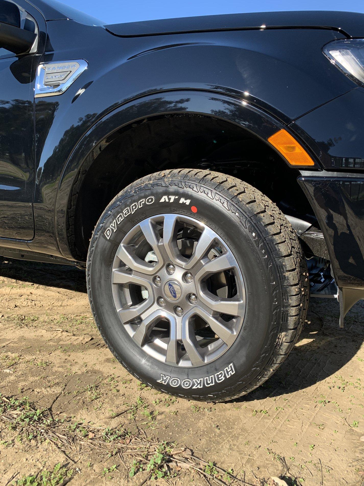

Here is how the 255/80/17s look

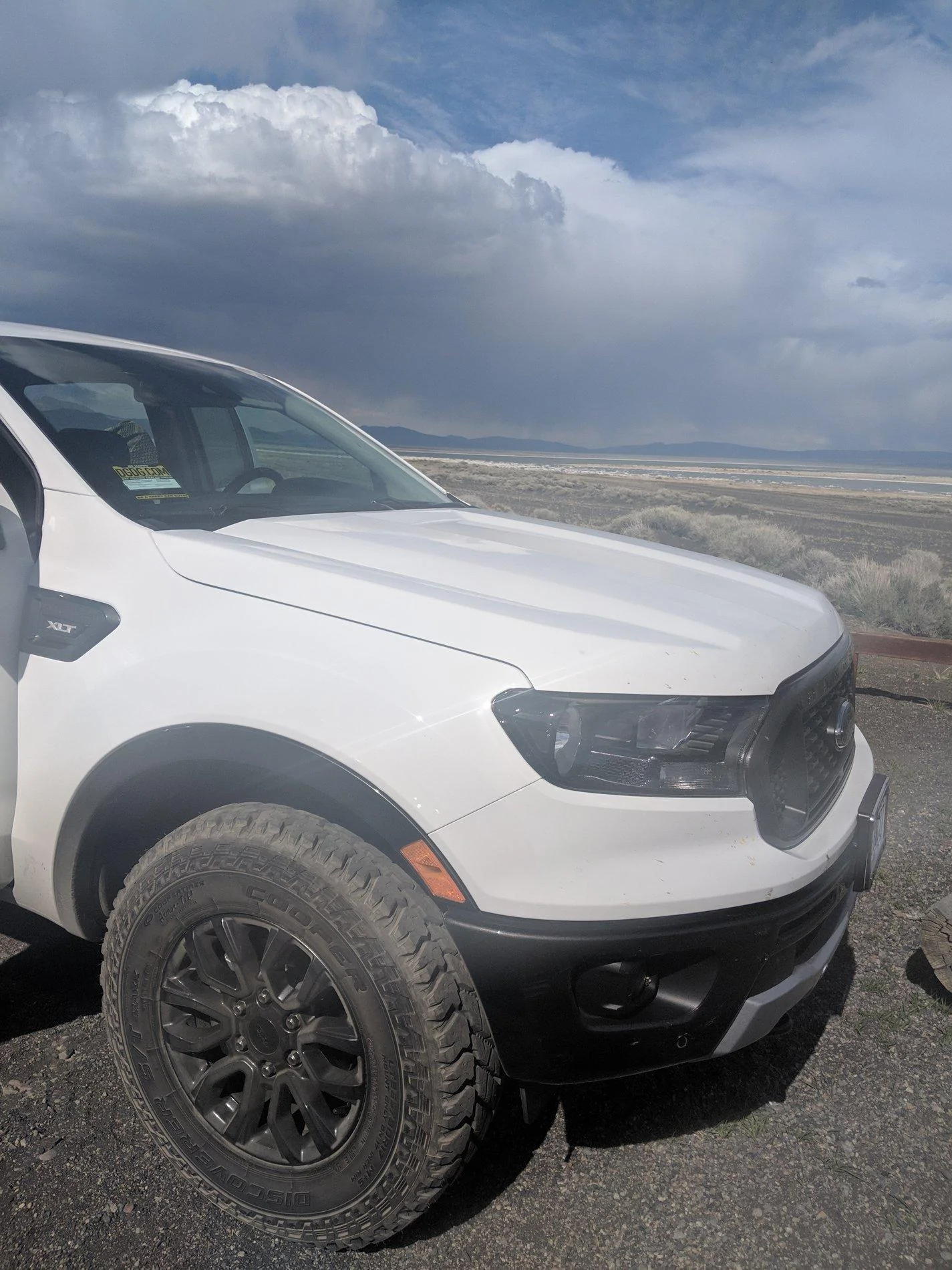

Hi, now that you have had these for a while, still all good with no noticeable rubbing? Also how is the transmission with these taller tires, gearing still decent?
At full lock, I sometimes get some rub in reverse, but it is super minimal and not on the frame. I really do like the setup and the truck is great on long hauls as well as offroad. I've done a large part of the maze district in southern UT as well as some of the reasonable stuff from the back entrance to Arches. I feel like it crawls just fine and this will be my tire size for a long while.
The only thing that has been hard to swallow is the tire weight. It does dull out the truck a bit, but I'd rather not get stuck when I'm out in CA, NV or UT's wilderness :) The spare has the same tire and fits just fine in the stock location. There is a set of wheels from Method that would cut the weight difference and probably make the truck more peppy again, but I'm not sure I want to go aftermarket on wheels.
