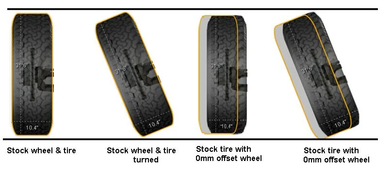

Nice wheels. What are the offsets? I wonder if the further we get away from stock (+55 for 18") the more chance of rubbing? I'm kind of new to this wheelfitment, but thats what i'm noticing, anyone with more exp able to confirm?

Nice wheels. What are the offsets? I wonder if the further we get away from stock (+55) the more chance of rubbing? I'm kind of new to this wheelfitment, but thats what i'm noticing, anyone with more exp able to confirm?
Thats what i noticed when researching what fit and what didnt..
Id get 4 out of 5 fit xxxx size tire..
The one guy that didnt fit would have wheel spacers or different off set wheels.
Have someone sit in the truck and turn the steering wheel lock to lock and watch the outside edge of the tire to crash bar.
Now visualize that tire being pushed an 1" or 1.5" further out and swinging through the same arc as before.. its now closer to those crash bars..
I also think larger diameter wheels will allow wider tires as the spindle tappers inward..
Downside is less sidewall for airing down..
It's just as @Nathan289 says - here's a picture to show you just how it works. The horizontal bars represent your crash bars - the shaded tire in the RHS pic represents where the tire is moved to with the change in offset. You can see how it hits the crash bar.
EDIT: Updated photo to inlcude 0mm offest wheel not turned.
