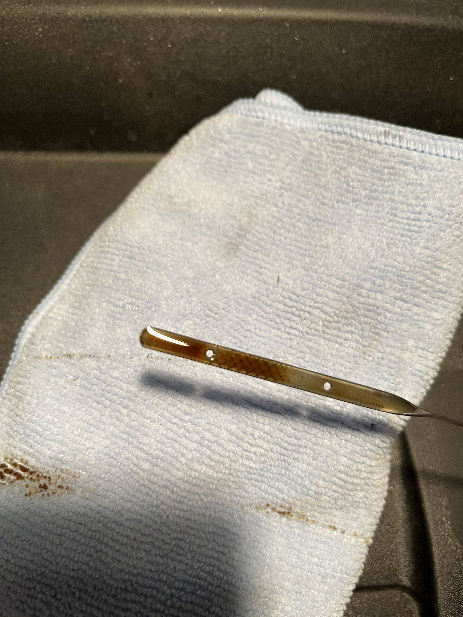

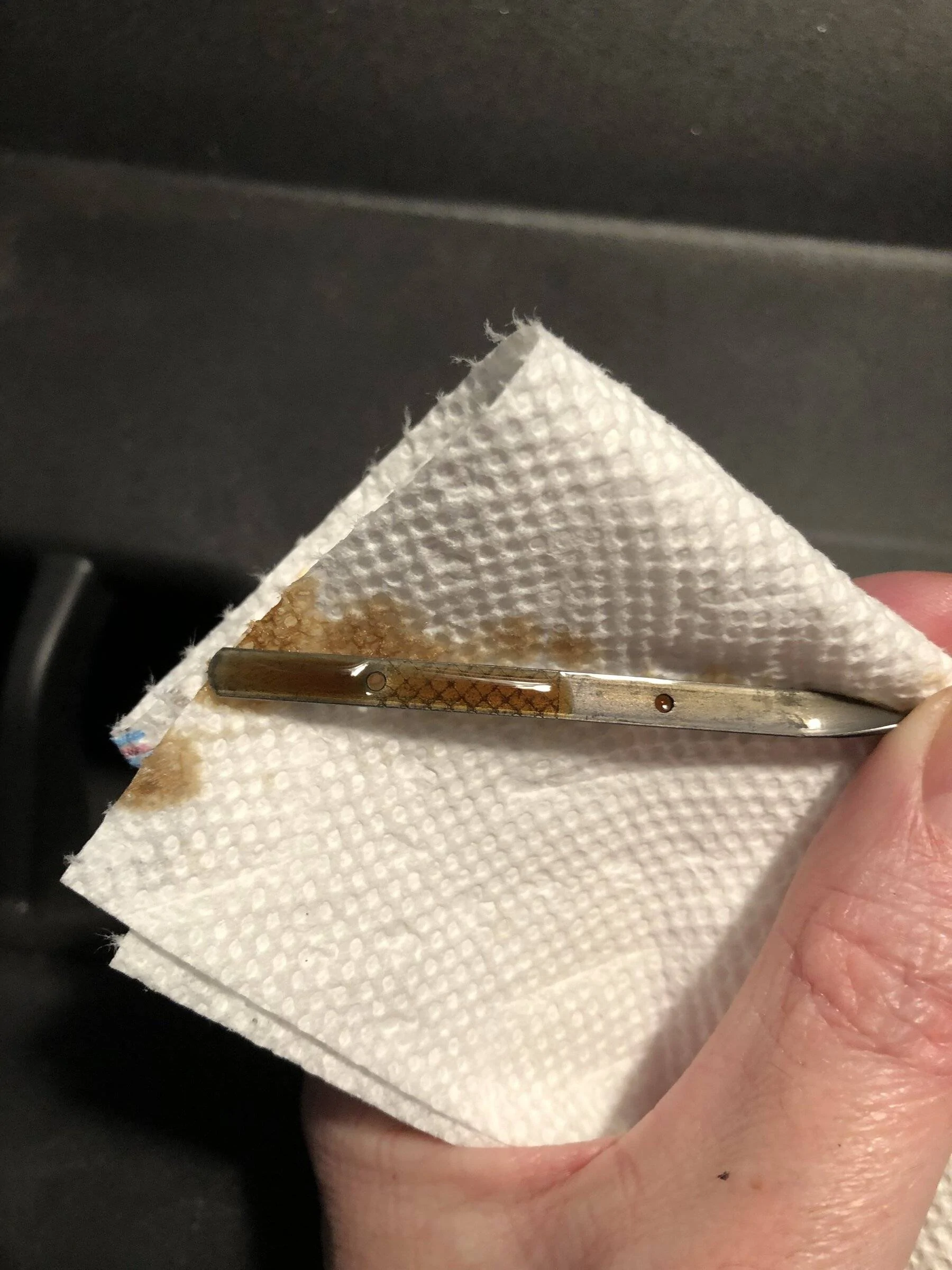

This is the way I drive my truck. I mostly drive it on weekends. I drive an hour and a half to my cabin on Friday and back on Sunday, with short trips in between. I have abut 11,000 on the truck and 3000 on my current oil change. The first pic was taken at 2000 on this oil change and the second was taken today (3000). Same level as when it was first changed and it just smells like oil.
Looks great to me! Wish mine looked that way. I changed mine last Saturday with 1960 miles on it. Factory oil was black and up to the bottom of the twist on the dipstick.
