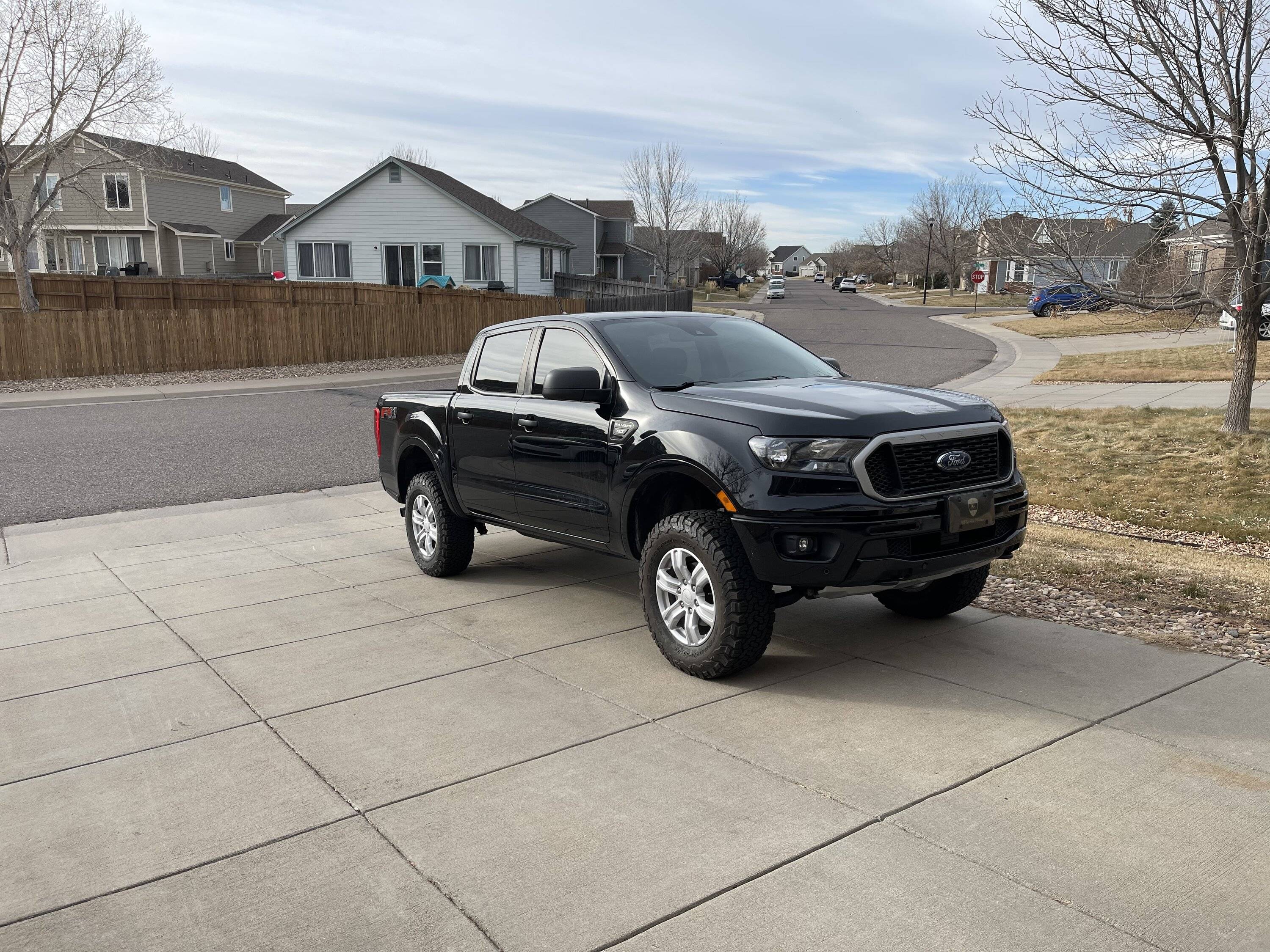

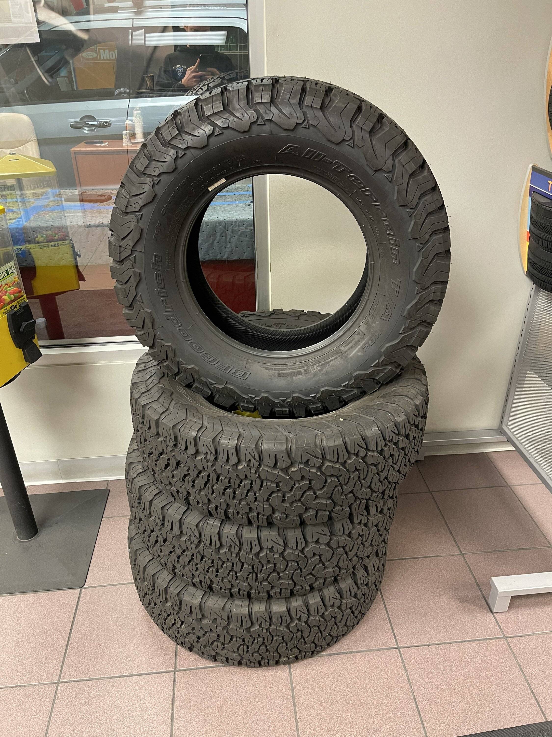

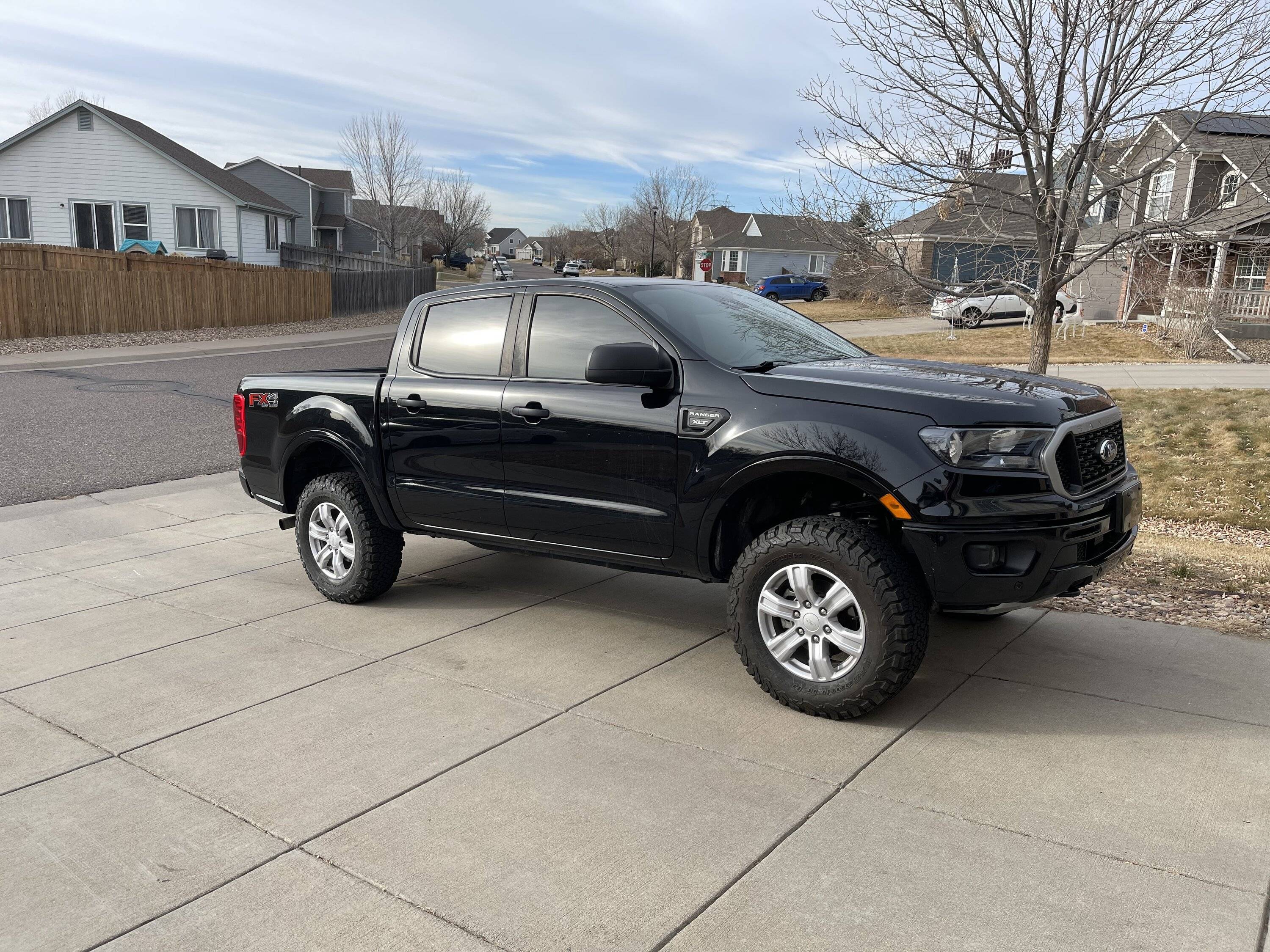

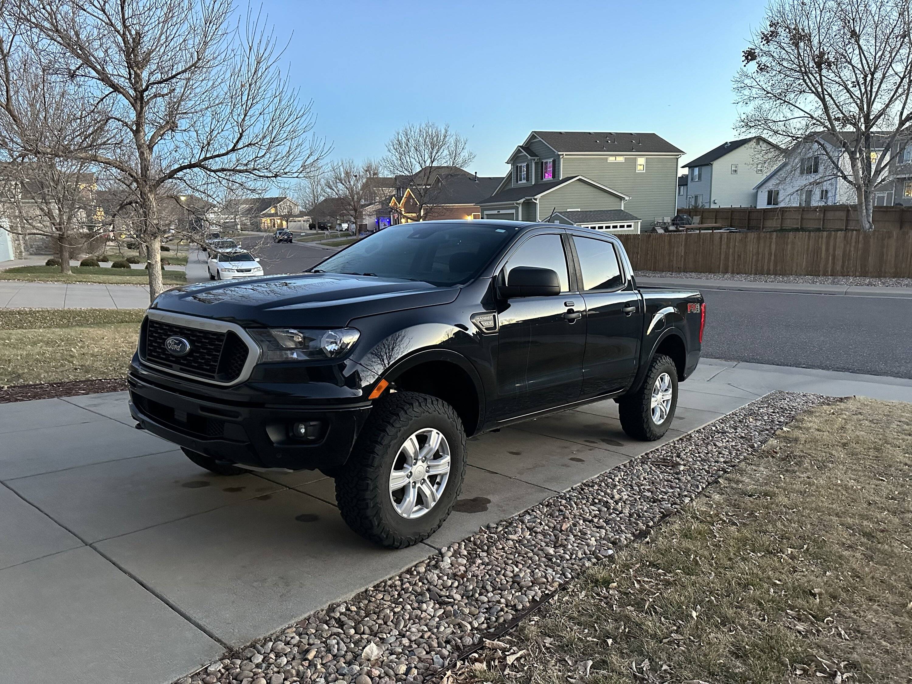

Quick update. Finally got the Fox kit installed with new tires and some window tint.
I see you’re well on your way Sean. Those new tires look great and I’m sure you’re enjoying how it rides with the Fox suspension.
Knowing your crash bars will be removed, I think some of the concern members are expressing about 33s and suggesting more lift has a lot to do with wheel well liners, fog lamp housings, and that weird plastic block against the wall of the cab .
Everything seems fine until folks start compressing at full lock on the trails. Then, they notice some rubbing on those items and realize it might not have happened if those things were up and out of the way by an inch or so.
Some have been lucky with 2” or 2-1/2” of front lift and just removing crash bars and using wheel offset or spacers, others have reported some issues. Others avoided pitfalls by going with a 3” lift.
The good news for you is that those bigger tires on your stock wheels really give it a great look and should be clearing crash bars and the knuckle just fine. I can’t tell from those pictures but did you throw in small spacers? Remove crash bars yet?

Thank you so much for the in-depth insight. I really appreciate it. As it sits I do clear crash bars and knuckles. Seeing that I just put these tires on I’m not in a huge hurry to trade them out. The whole idea behind the true 33” is for just a bit more ground clearance. From what I am seeing a little different backspace on the wheels I could be ok.

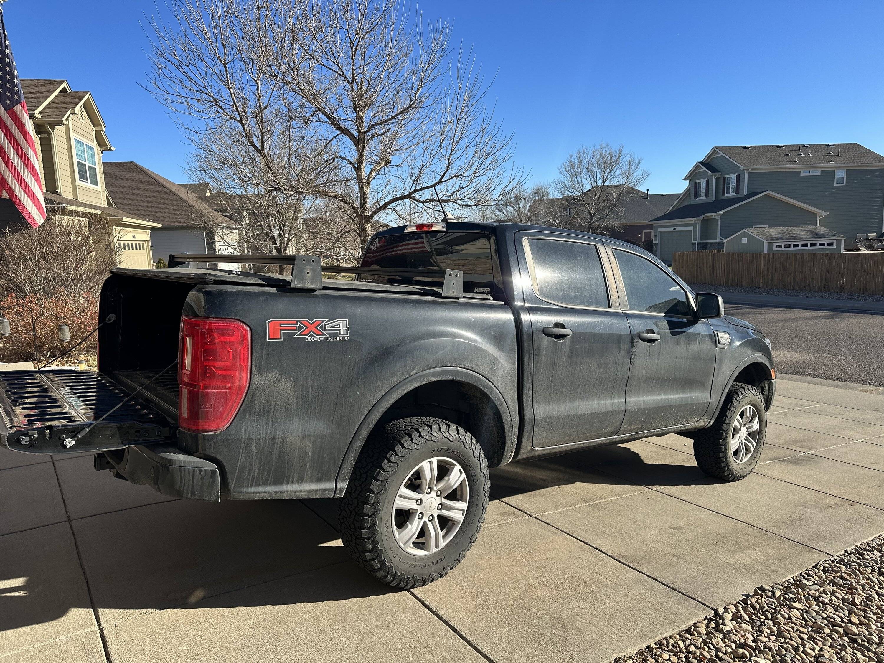

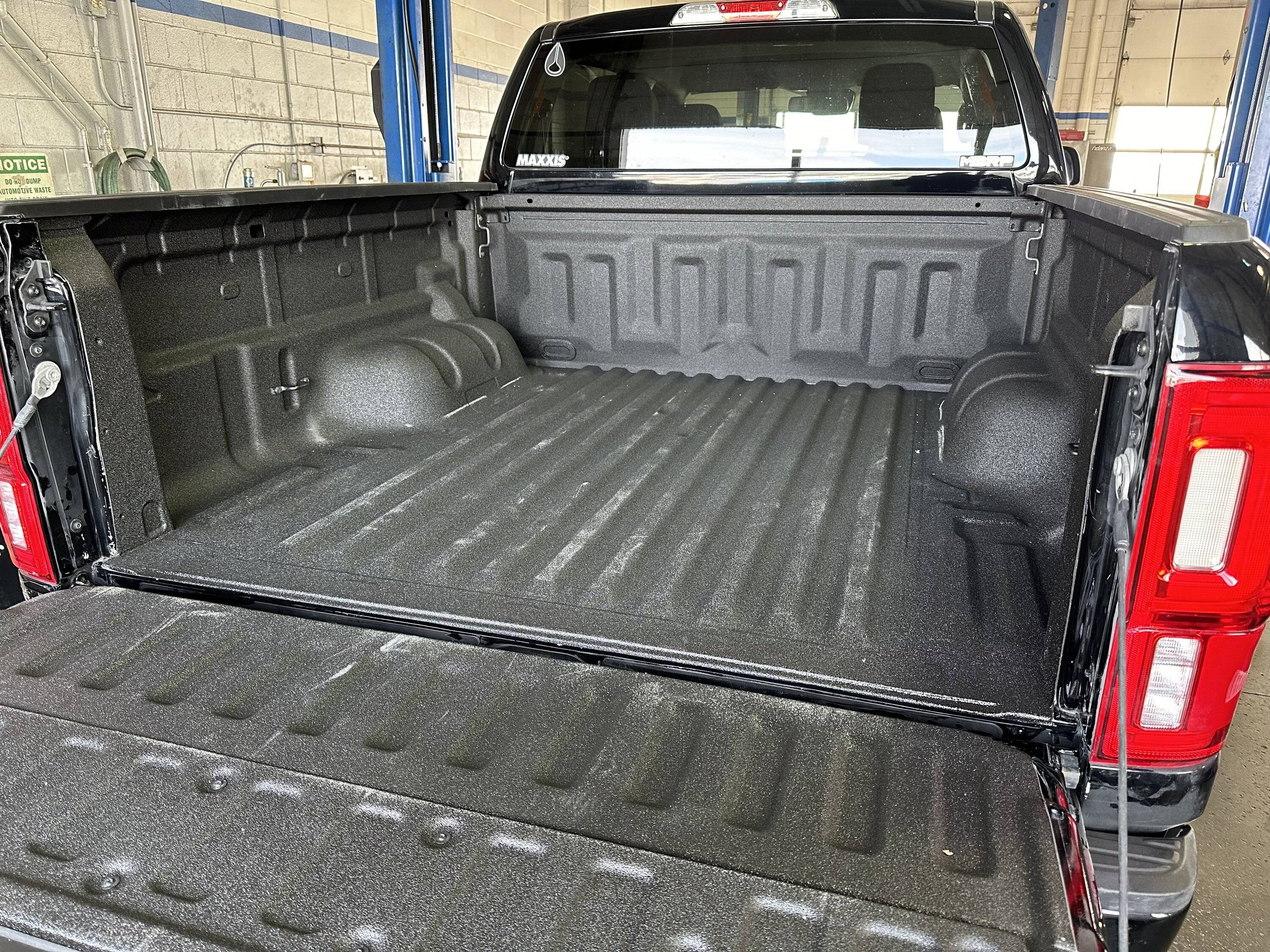

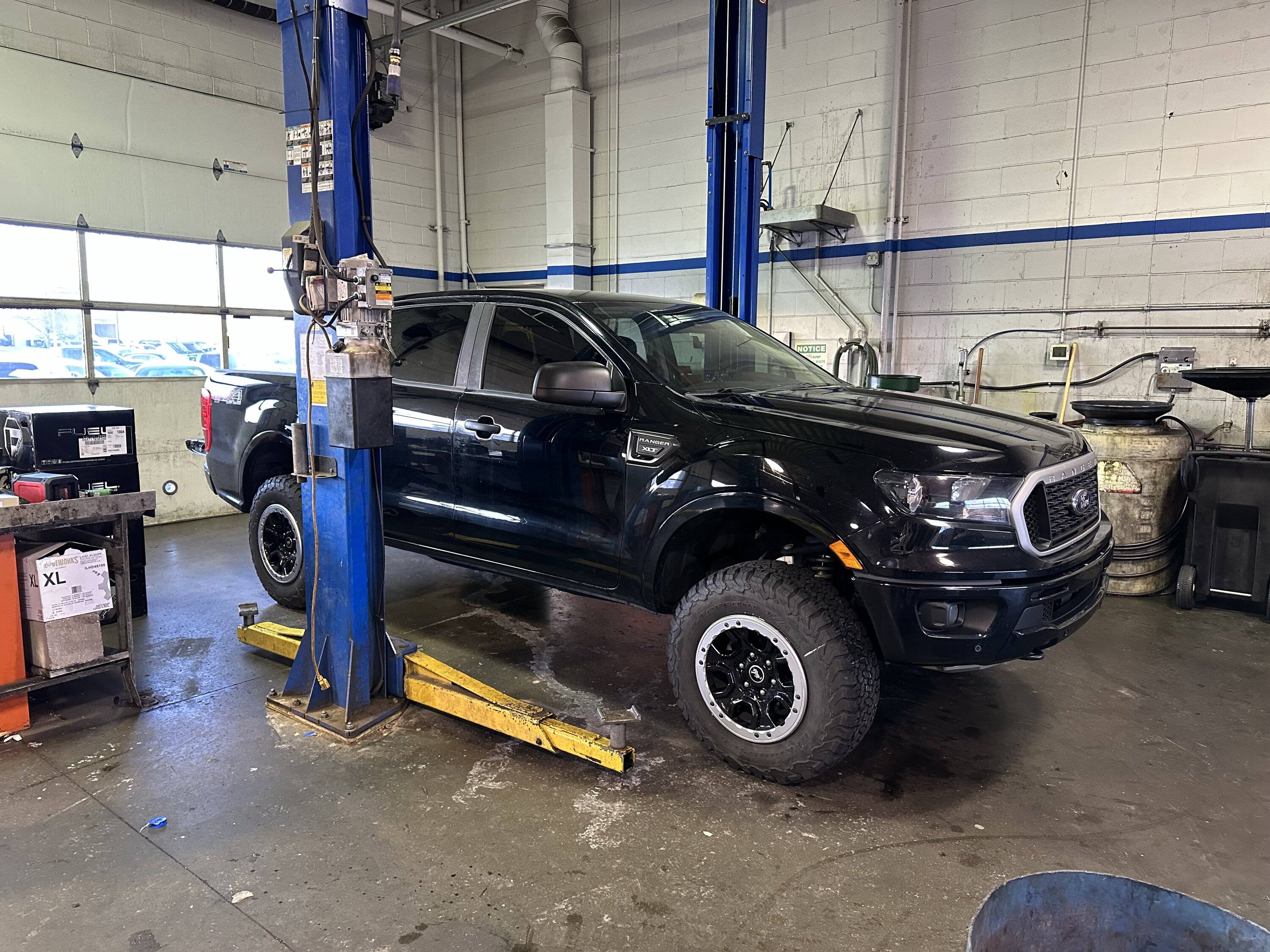

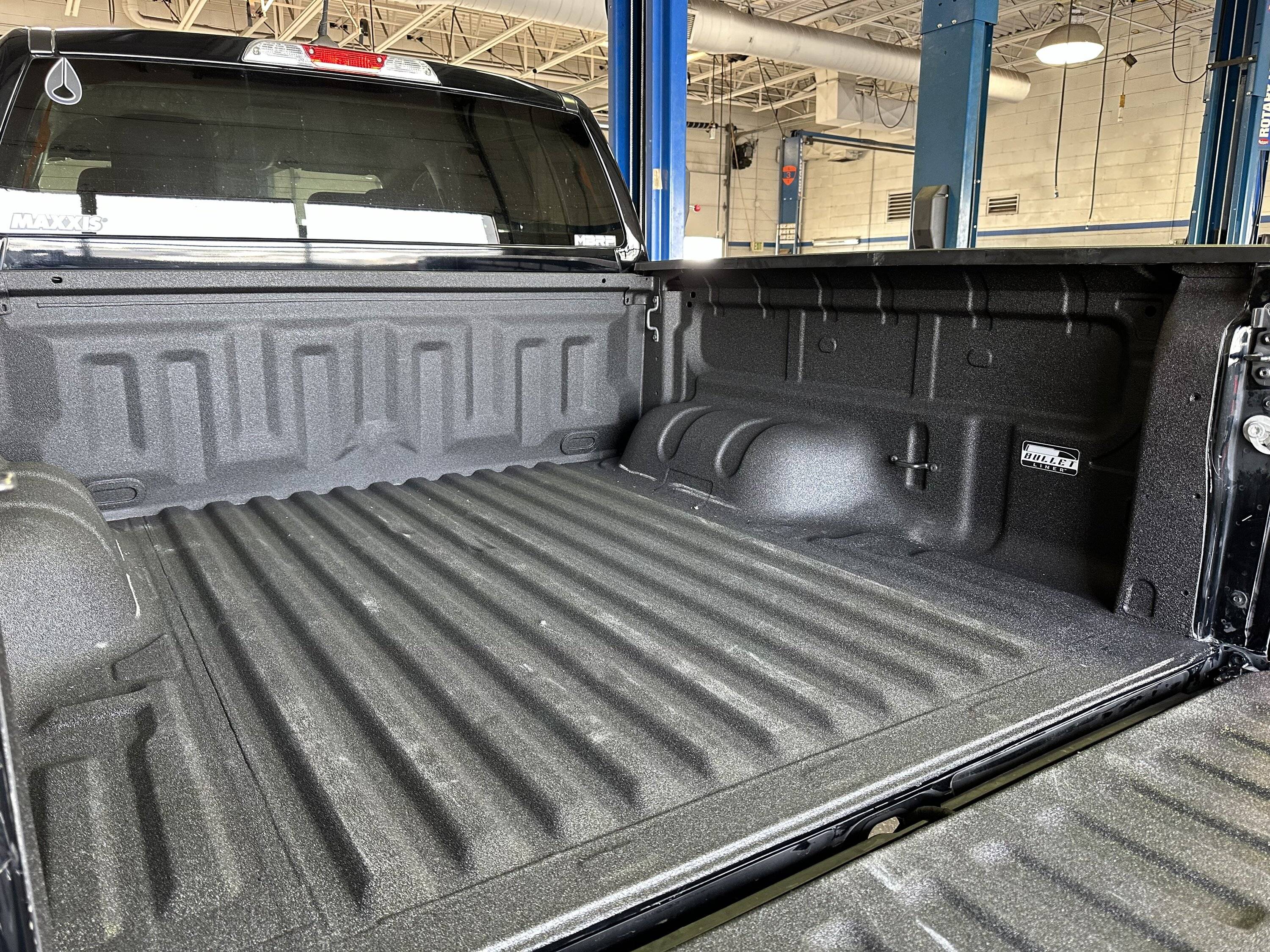

Finally got the bed rack installed then removed and cleaned up for a bed liner. Also swapped out for some Bronco Sasquatch wheels. Looks much better I think.
