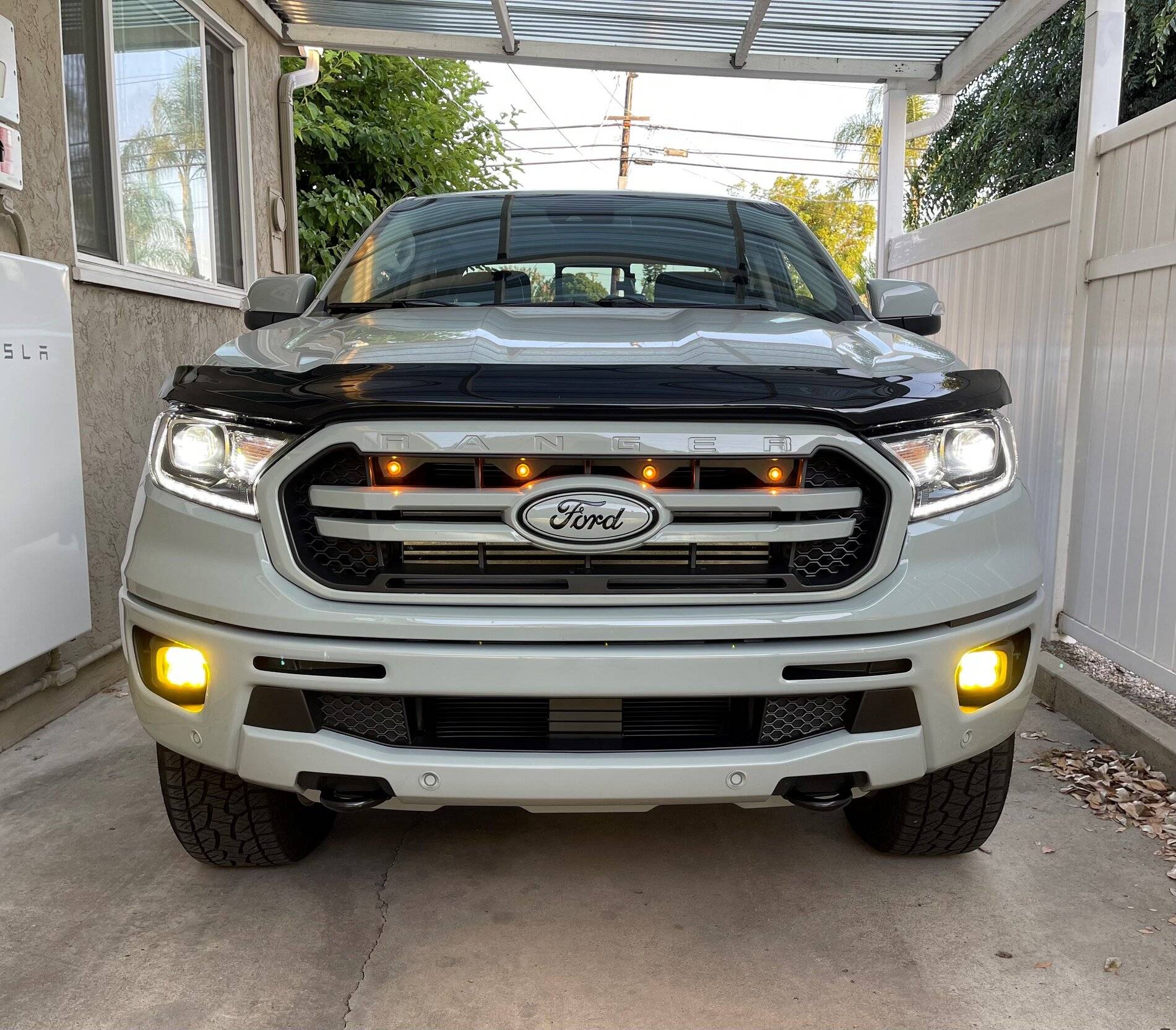

Took a better shot of the lights. I have the Diode Dynamics fog lights to install but the amber of the fogs will go nicely with the Raptor style lights.

Still awaiting wheels :crying:...In the meantime finally installed the Diode Dynamics Pro fog lights. A straightforward install but a pain in the ass because the space is super tight. FYI, I only removed the wind dampeners and reached my hand/tools up from the bottom. Oh, and whoever aligned/drilled the holes on the FX4 wind dampeners should be taken out back and shot! Decided in the end to delete those pieces since it was something I was considering anyway.

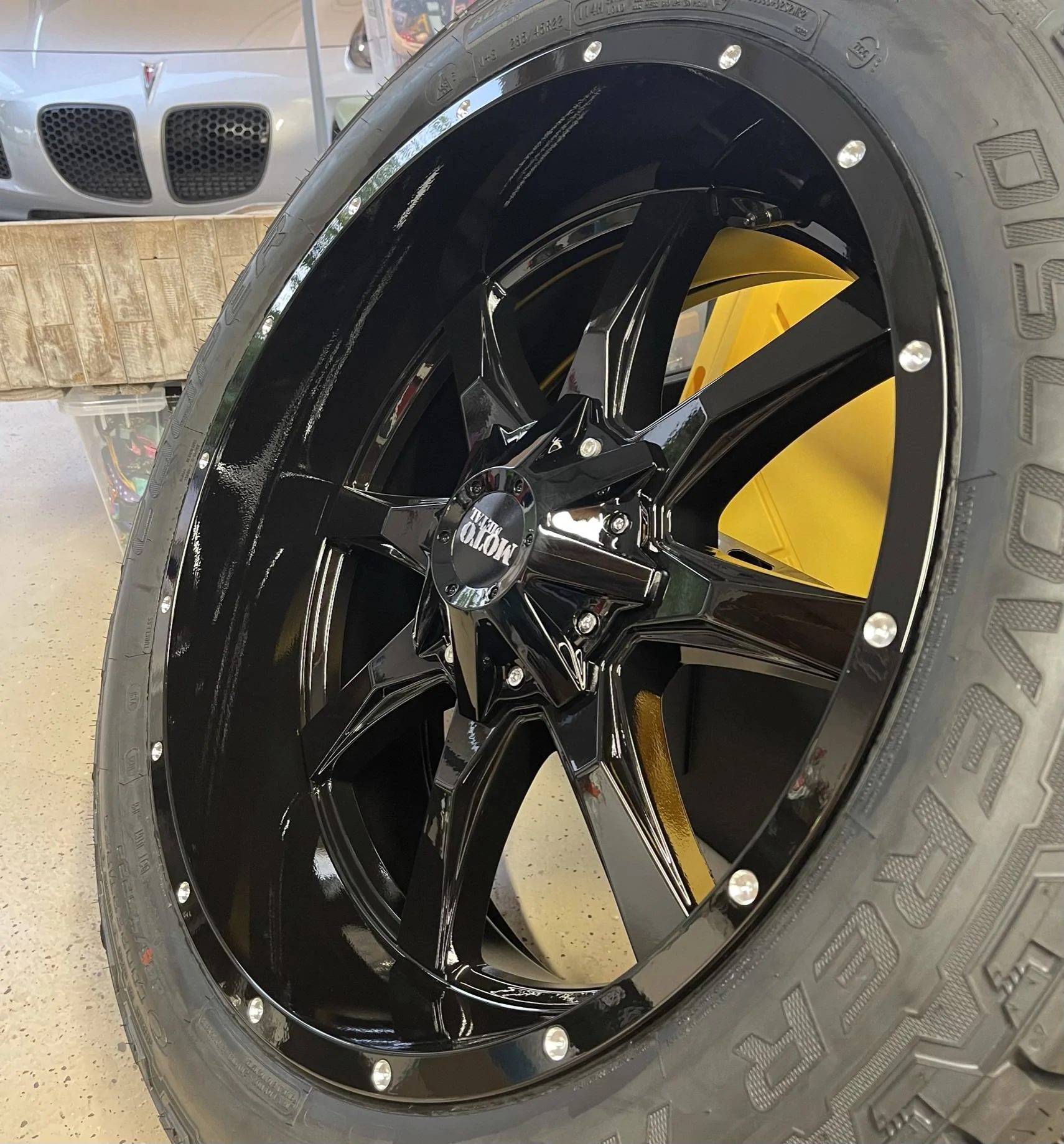

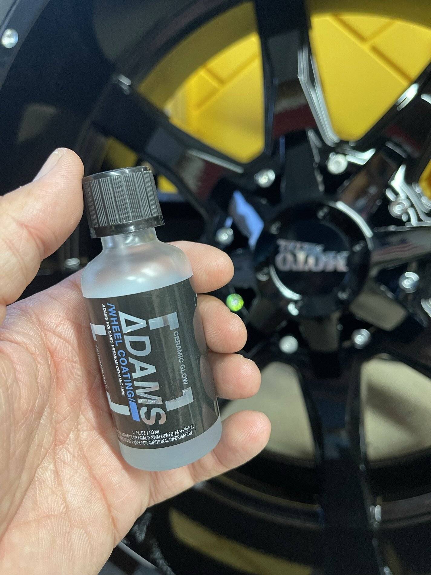

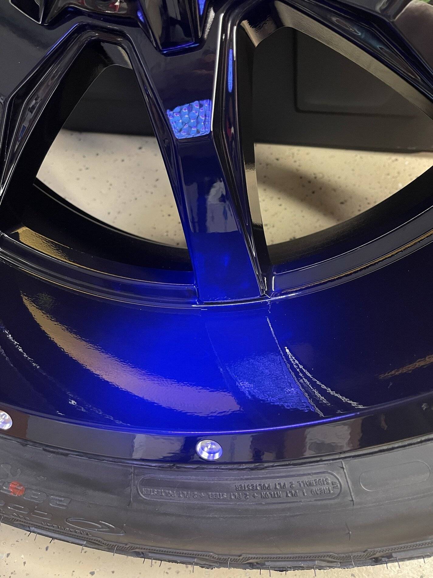

Ceramic coated my new wheels. Have a lot going on with work and family, so took my time doing one wheel per day. The Adams wheel coating is an awesome product to work with, a bit tedious but easy to use. The coating also glows when you shine a black light on it which really helped to ensure all parts of the wheel were covered and even. Although, this process peaked my OCD making sure every nook and cranny were covered. The coating also makes the black gloss stand out even more. Anyway, glad to be done and have the added layer of protection. Also decided to add MGP caliper covers when I mount the new wheels/tires...which of course also had to be ceramic coated haha.
EDIT: If you decide to coat your wheels, don't forget to do the drums!

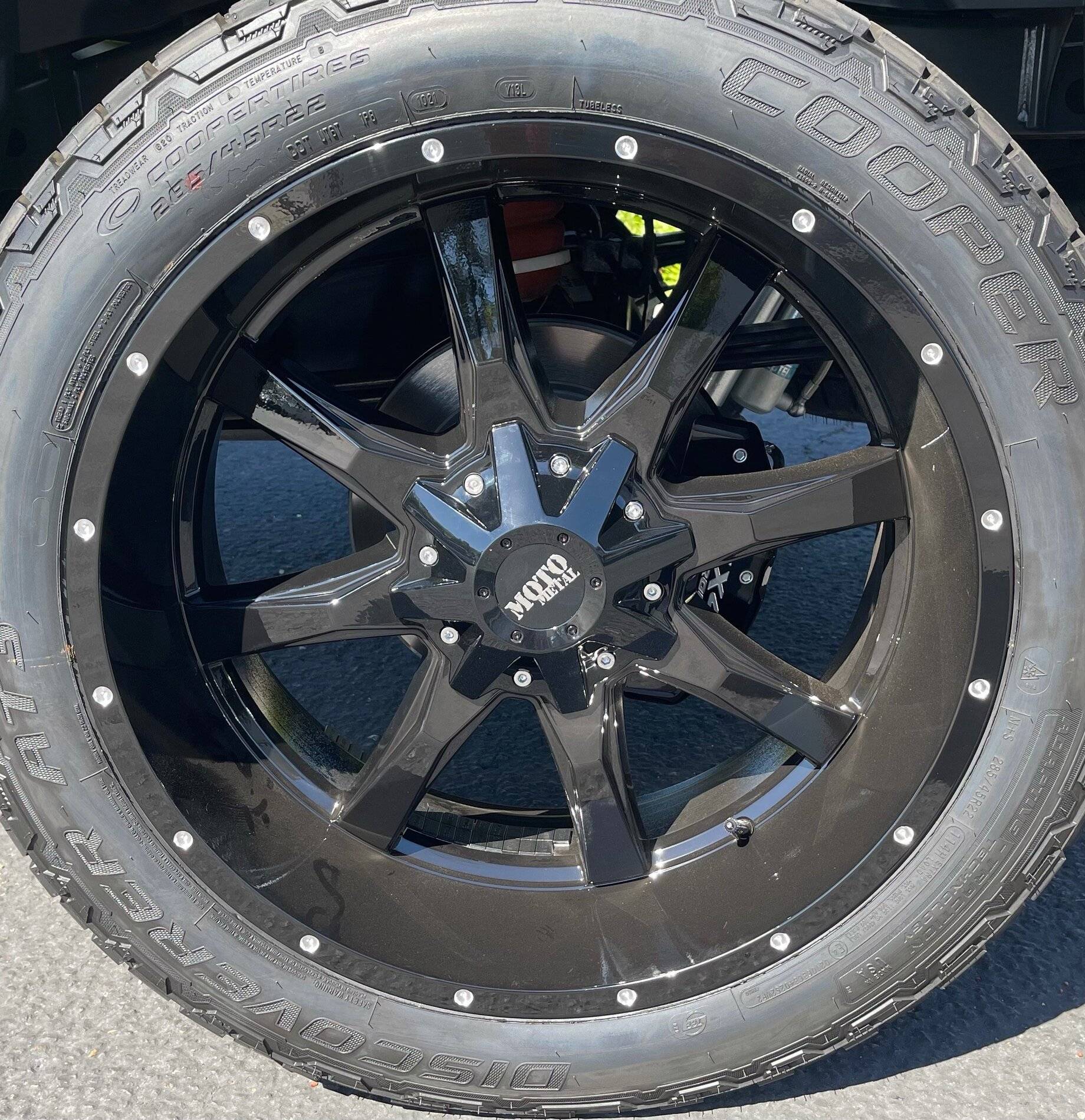

The deed is done. Discount Tire hooked up my ride and the fellas put up with my requests to be careful with the coated wheels and even put the center cap covers on in the direction I wanted. Yes all right side up in correlation to the air stem :crazy: It really is tough to find businesses that do things the right way and these fellas did great…to quote a favorite book series of mine, “how you do the little things is how you do everything”.
Here’s how the Ranger looks now…

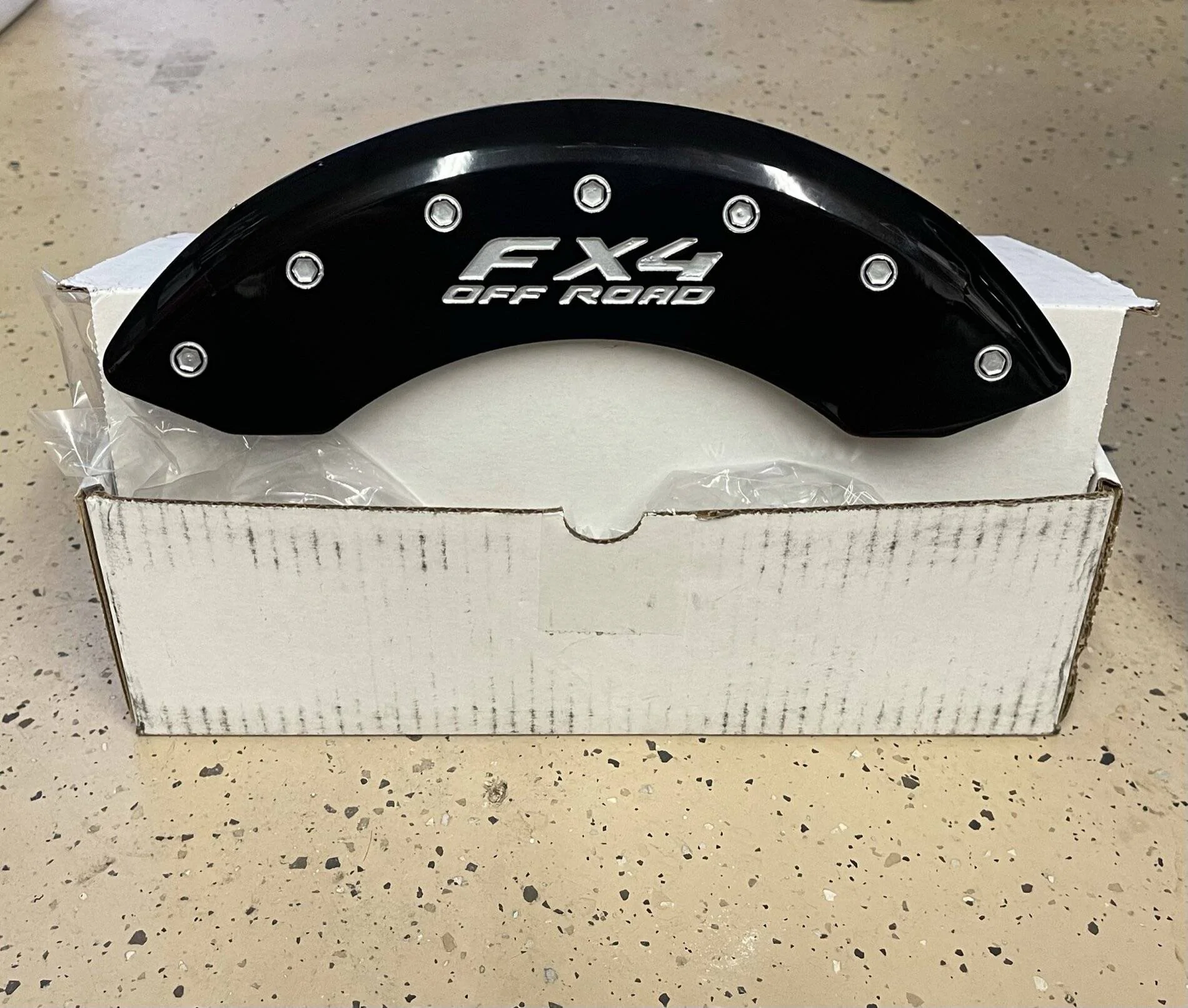

Couple more thoughts on the new wheels and tires. The height of the Cooper AT3 4S tire is 32” but at a 285 width there is an ever so slight rub at full turn on the rear felt of the wheel well. Plan on taking care of that although it's not an immediate issue. I do have a set of BDS crash bars, so the delete isn't forever now that I've confirmed there will be no rubbing. Also wanted to ensure that I wasn't adding a bunch of weight to each corner despite being inevitable. The stock Lariat wheels/tires are 66 lbs. and my new setup is 80.5 lbs., so I managed to upsize without adding a bunch of weight. The ride has hardened up a bit going from a 60 to 45 sidewall, although the ride is still very nice and the Coopers are turning out to be a great all around tire. They're as quiet as the Hankook tires and a fantastic deal compared to other brands as a 3-Peak Mountain Certified tire.
Today I didn't really mess with the truck all that much, although I installed the MGP caliper covers (https://www.calipercovers.com) and they came out great. Especially now that the big silver calipers are hidden. They're super easy to install and took me about 10 minutes or so.
