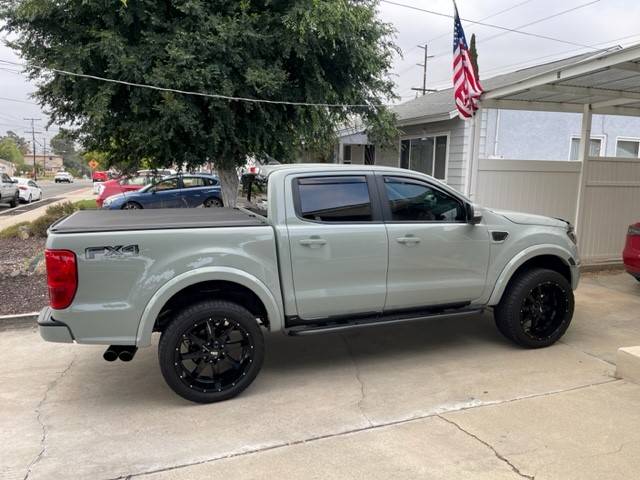

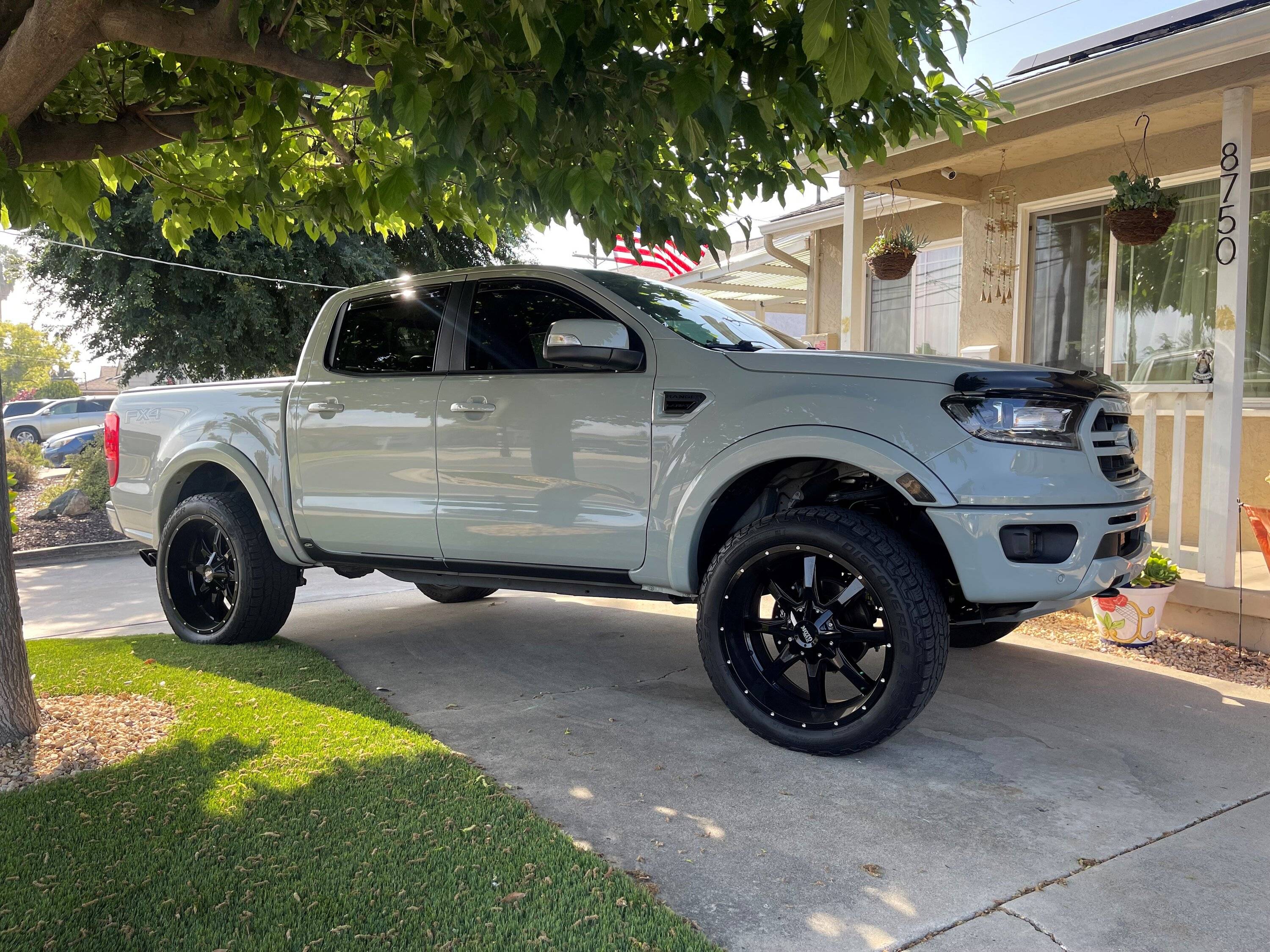

Will try to catalog the upgrades as things move along now that I've fired up Joi's thread again! Will definitely see folks around the forums since I'm sure to have many questions! Here's a quick picture of how the truck sits today...

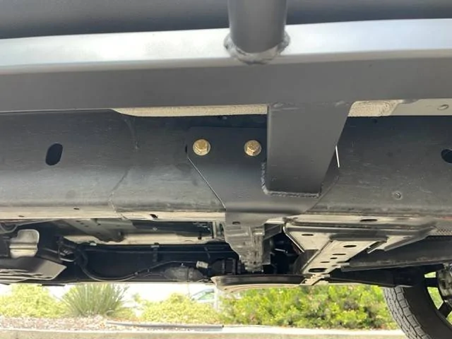

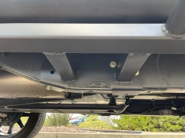

Quick update. The work on the fabbed rock sliders took most of the day and coming along great. The guy doing the work runs his business out of his garage, so it’s cool to have custom sliders.
Will be frame/bolt mounted. Due to the box frame, in order to achieve proper torquing, plates are being fabricated to disperse the load. This includes additional plates with welded nuts for the bolts to screw into. Avoids cutting into the frame. This setup will be plenty stout while still allowing me to remove them if needed.
Here’s a couple pictures of the fit up before final weld out and painting (Steel-It polyurethane). Final installation tomorrow and will have a few more pictures once completed.

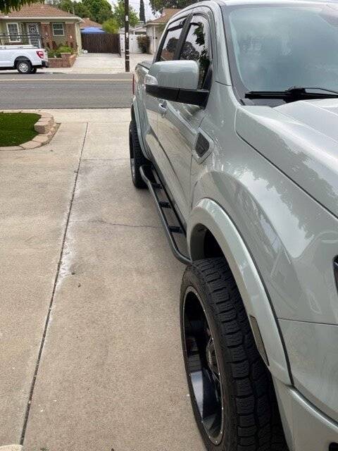

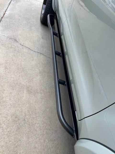

Rock sliders are complete and in. Love how they came out. Here's a couple pictures.
If anyone is in/near San Diego and interested in a custom set of sliders, let me know.
