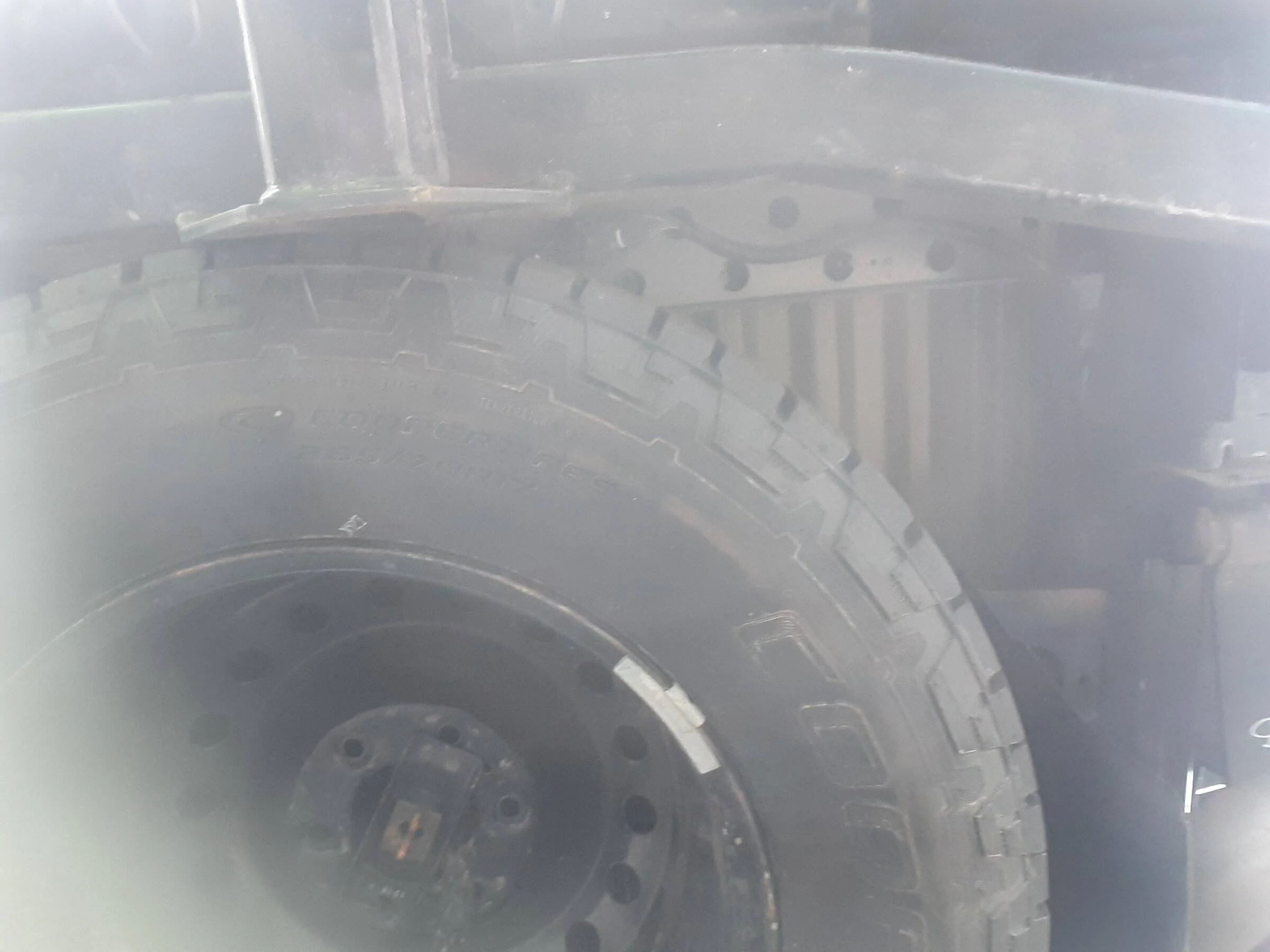

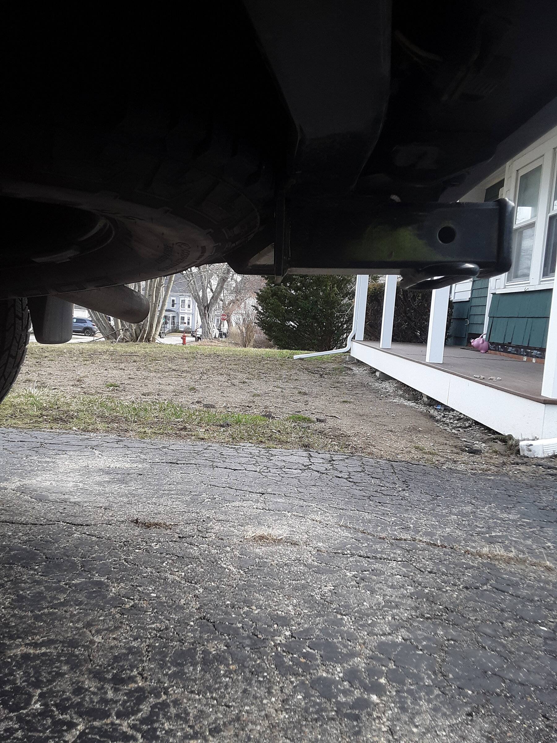

If I think of it I'll grab a picture of the spare as it sits on the truck now
Michel Jeanneau
Michel Jeanneau
Michel
Feb 23, 2020
309
916
Dover, NH
2024 Ford Ranger STX The Gray Ghost
And here it is:

So where it comes up against tour trailer is too tight for another 1/2", or is your trailer hitch ( Curt Hitch) longer than my stock hitch? I sure appreciate you laying down and taking those pictures!

I just climbed under and I have 1" between my stock hitch and the tire, but I think the spare will slid forward a tad, unfortunately I have the damn steel spare wheel, I guess I could investigate getting a spare stock wheel like my other four. At least Ford gave me the correct size spare. maybe just take a chance on the 265/65/17 spare.

The ford stock hitch should have no issues accommodating a full 32" spare. My Curt hitch is not the low profile one but the "HD" one (whatever that means). The Cooper disco in 265/70/17 lists a diameter of 31.6", and there is maybe 1/16" of clearance between it and my hitch. Like I said earlier, though, the stock 265/65/17 spare that was there before also barely fit there, especially after mounting my hitch, which requred me to drop the spare to get to the frame.
BTW, I did not need to lay down for the pics...I discovered the reverse camera-thingiemobob on my wicked smaaht phone a long time ago...that layin' down on the ground thing is for kids!

Michel, I have the same size tires as you (31.6) but they're Nitto's. The spare fits and is close like yours and I mounted mine with the valve stem facing down so I could check the air pressure. Yeah, I'm not going out there and getting on the ground either. Ya'll just have to take my word on it. lol ?

Gary, don't bother with a stock alloy wheel unless you plan to do a 5-tire rotation. The steel wheel does just fine as a spare. And yes, there is room forward for the tire to go, you just need to give it a nudge as you winch it past the hitch
