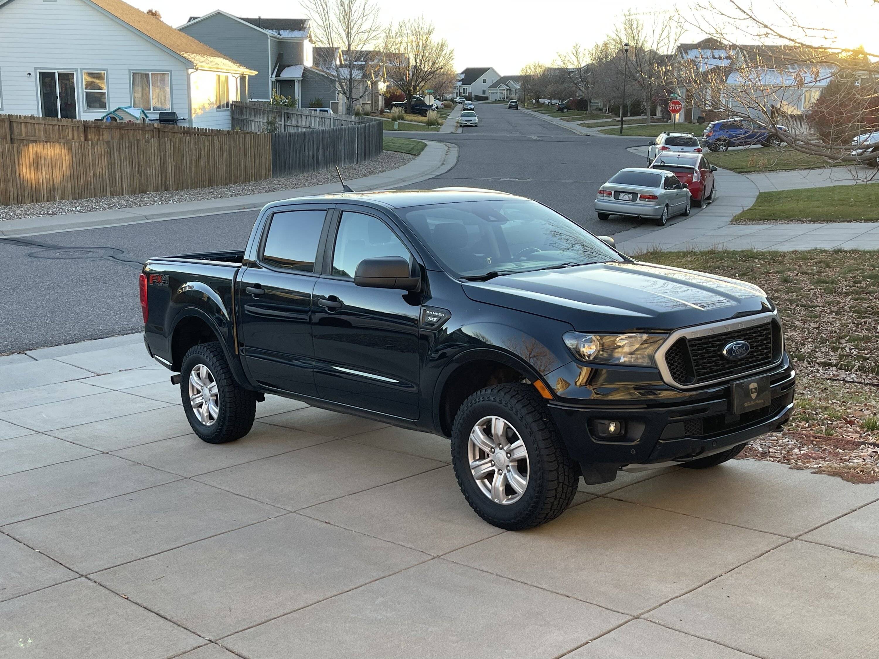

I took mine to a shop after doing a poor job of installing myself, they adjusted the preload from there. Iirc they come stock at 2.5” lift which should be about level. Adjusting shouldn’t be necessary.
What size tires are you running at the stock settings?
with the level, you can go as big as you want. The issues you’ll run into first are crash bars, fender liner, and wheel offset. I had 35s with 1.5 inch spacers and the fox suspension.
Thank you for the information. I was planning on deleting the crash bars. The offset and some of the other details is what I’m trying figure out and how/what needs to be done.

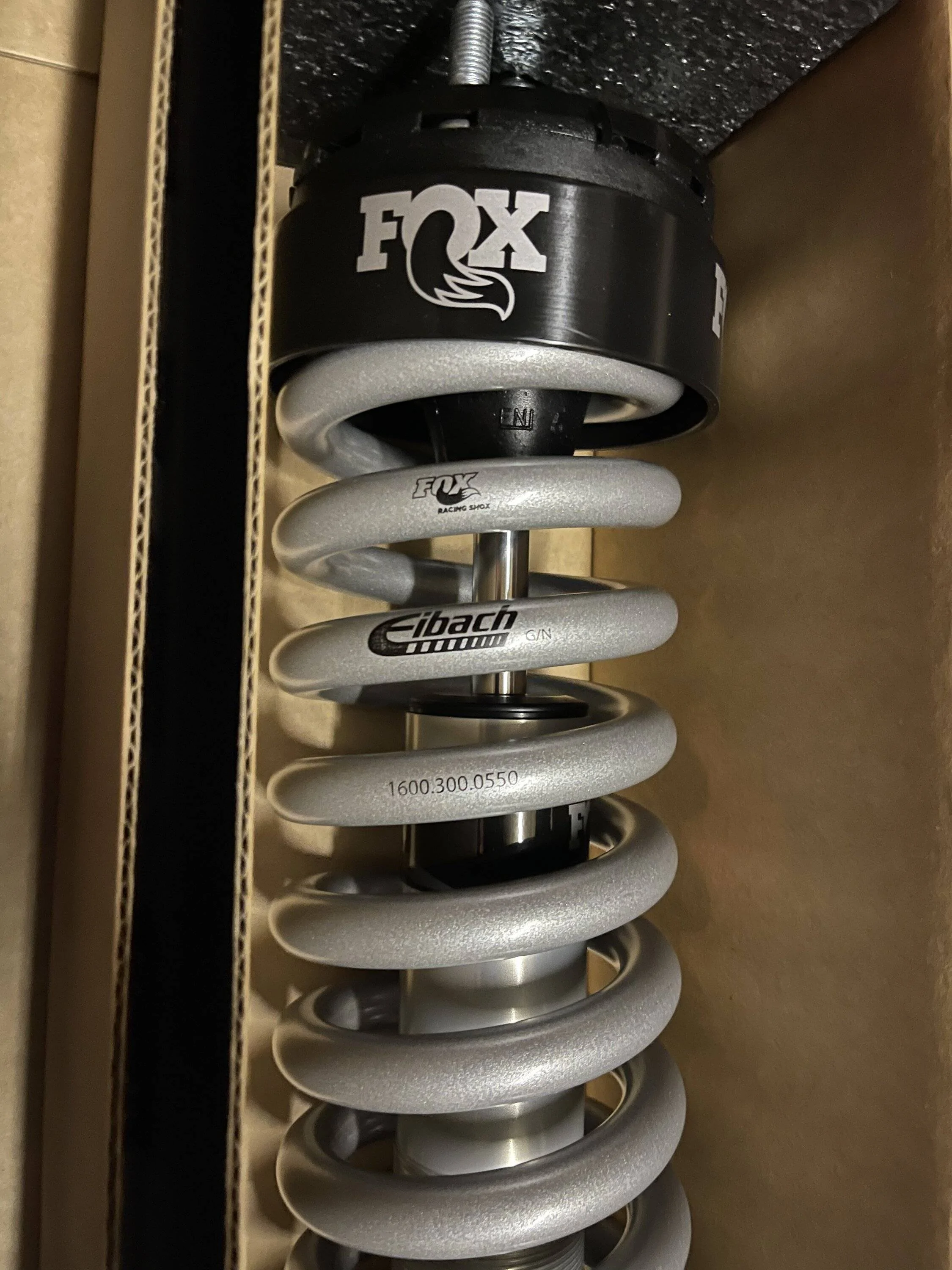

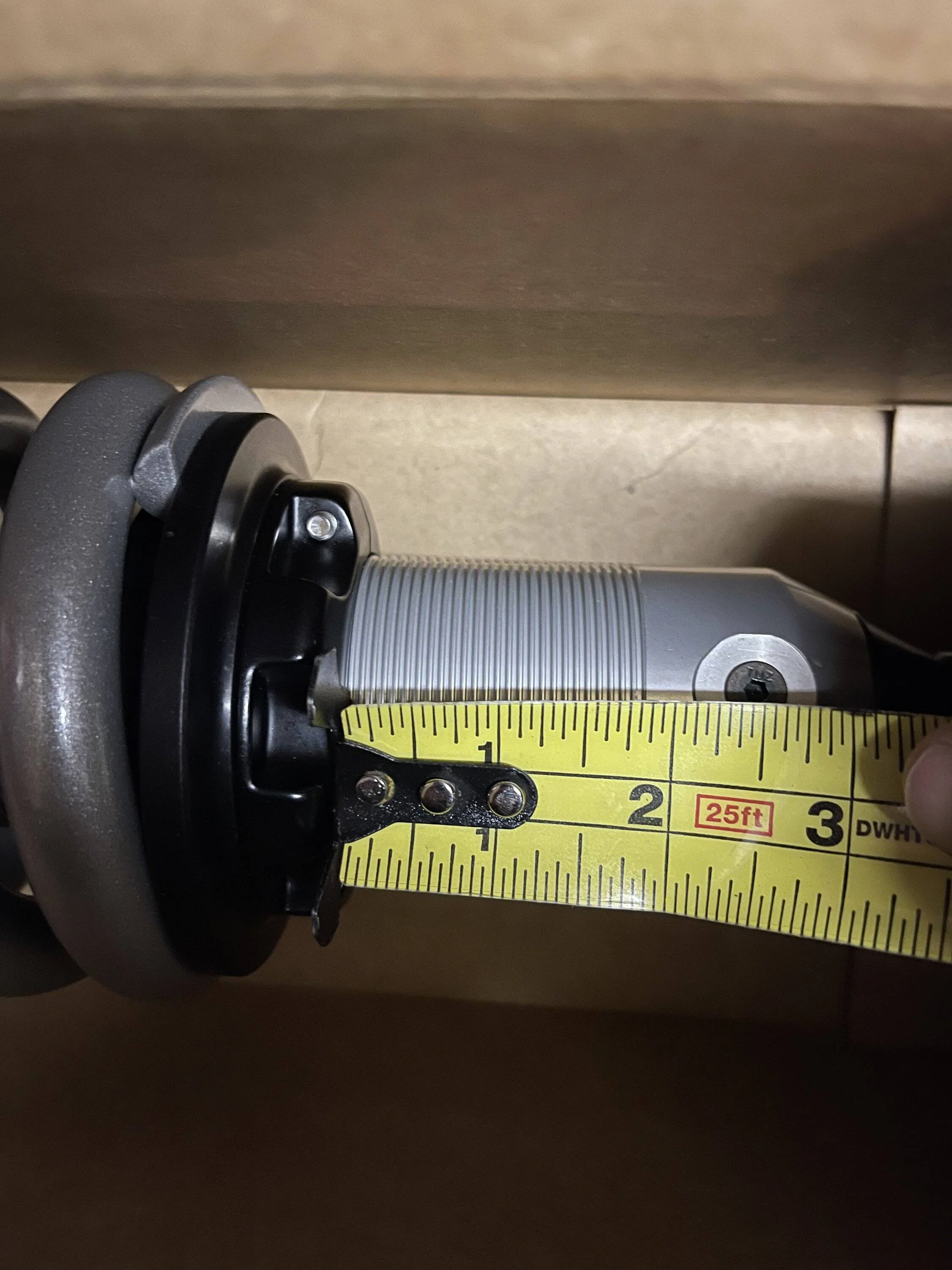

Is it just me or does the preload seem very minimal set from Fox? Can anyone see what preload they have in the 2.0 system to compare? This is the tuned by Ford set. I have also got a picture of the spring in the even someone has a kit directly from Fox we can see if the springs are the same. I have seen a discussion about that as well.

Has anyone done the Ford Fox 2.0 kit and have any recommendations on leaving it at the factory set preload or increased it?
Any higher than 2.5" and you'll need aftermarket upper control arms.

So you have 2.5” of the threads showing? Is that what you are saying?

No, 2.5" of lift.
So that’s not the preload. I am looking only for the preload or amount of threads are exposed on the shock body.
