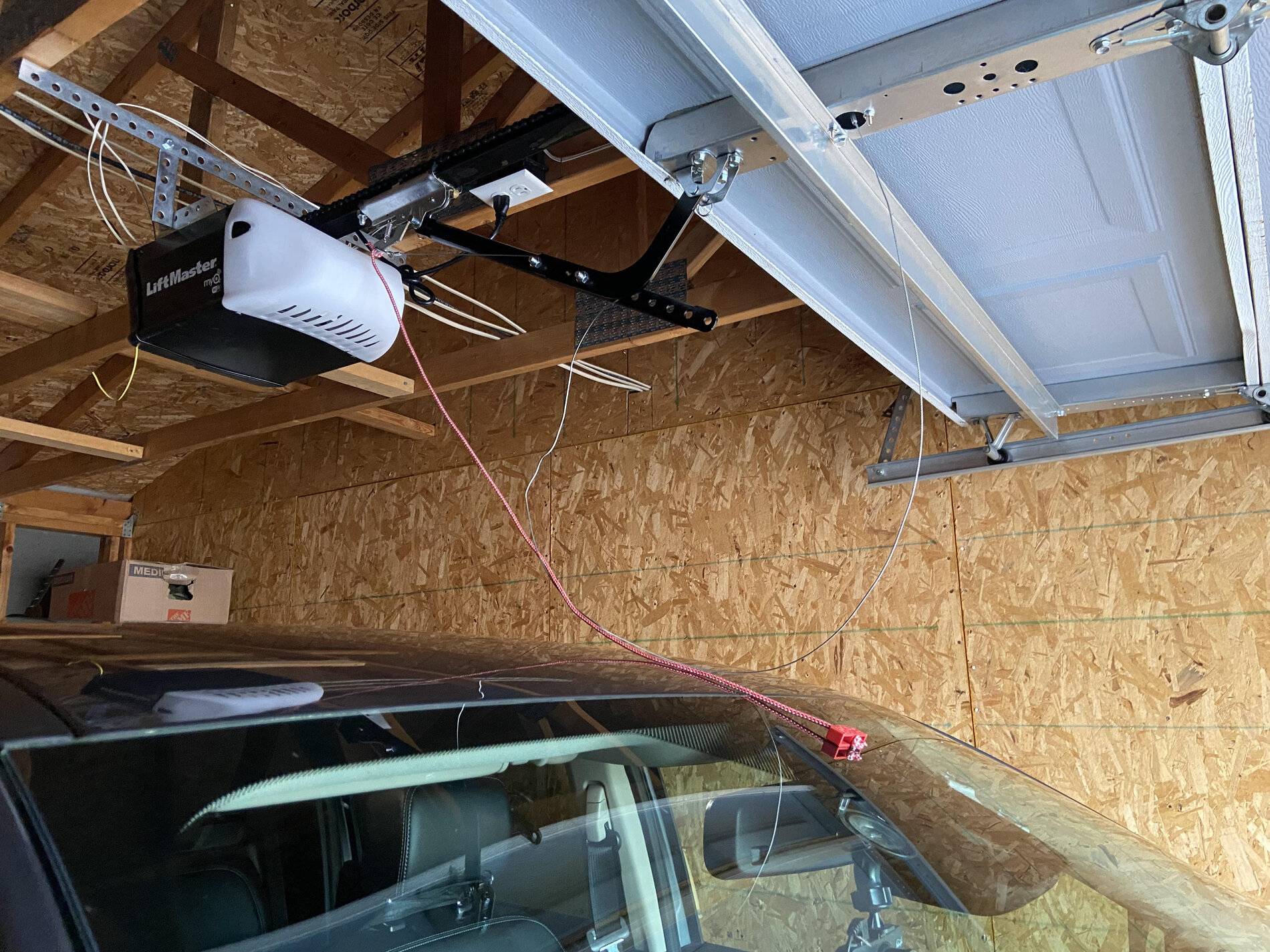

Here's the cable hanging there mocking me. I just moved into this apartment 1 week ago and they stated this is a new garage door opener. I guess the tech who did the install doesn't care about the finer points of cable management.

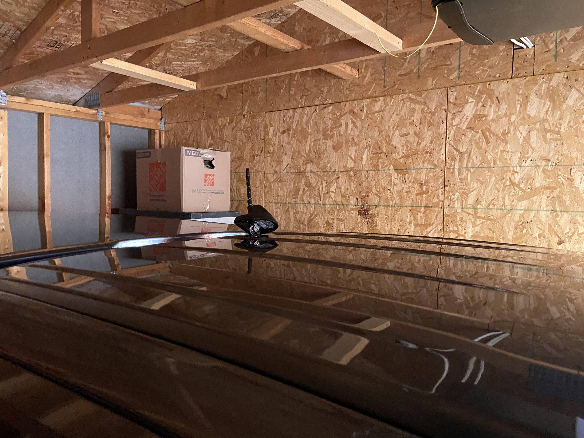

Current state of my antenna:

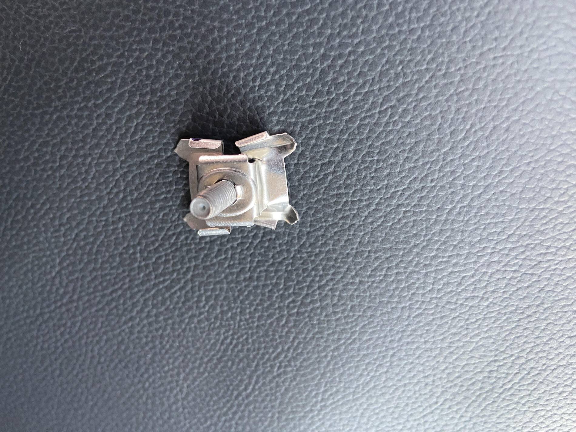

Below you can see the bottom bracket of the antenna assembly, this is attached from inside the roof and somehow was pulled through (likely caused much of the damage above)

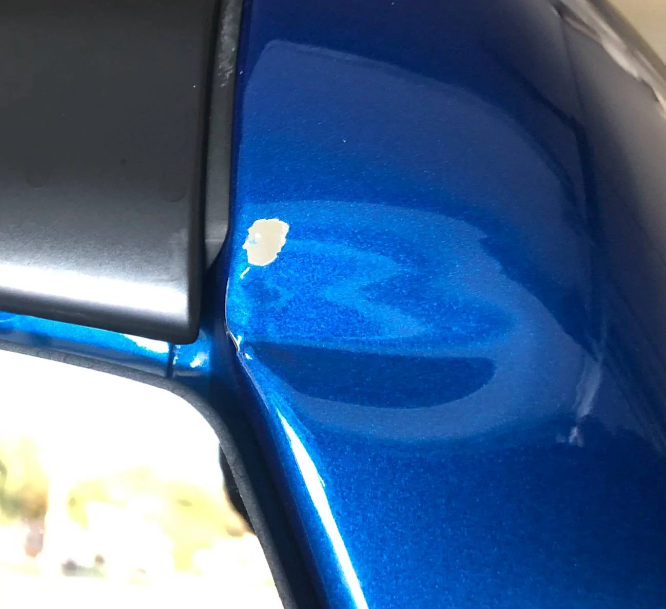

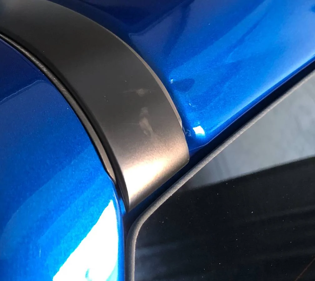

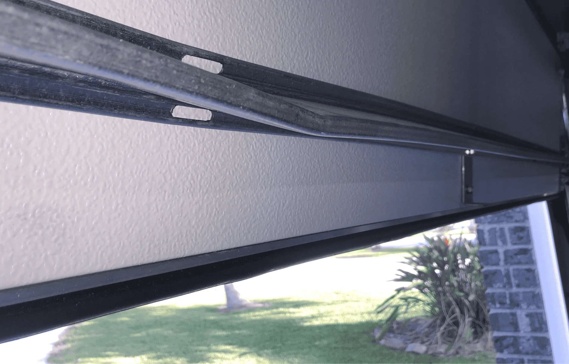

That's what I'm struggling with at the moment because this idiot typing had his garage door up a little more than halfway and forgot when he got in his truck and tried backing out of the garage.
A dent on the cab just above the rear glass. So glad I did not shatter that window. An inch or two lower and I suppose I would've taken out that rear glass. No estimate yet perhaps today. The damn paint is so thin it chipped right off of there. Doesn't even look like there's any primer under that spot on the right side.

Ouch.
We've all done silly stuff sometimes. That corner hit looks scary to me. Right on the corner or that C pillar seems like a rough spot to repair.

the cable is released using a key from the outside of the garage door. You unlock the cable, then pull it to release the garage door opener from the door. It is necessary if there is no other way into the garage. Meaning, no other door. It’s an apartment thing
And now I have learned something, the cable being a way to release the door from the outside and from articles I looked at, they all hang down. Looks very sloppy and should be easy to tie up with zip ties or some type of break away eyelet. It would stay functional and the eyelets or whatever you chose to use could be replaced if you ever had to use the outside lock.

Why not just tape the wire to garage door? When you need it the wire should pull out of the tape.
^^^^ this. I'd tape all the extra to the door. watch it go up and down from inside to see how much slack is actually needed during normal operation. (probably not much, all the pieces are connected until you pull the cord.)
