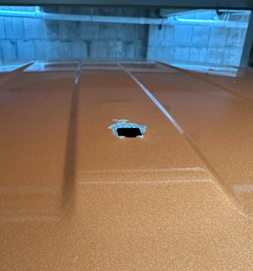

So this is what I started with:

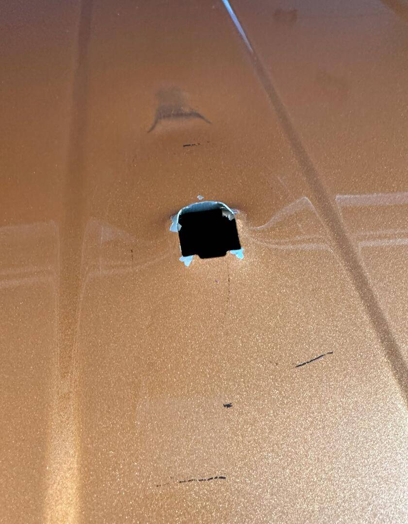

I went to Harbor Freight got some body work tools, some 2-1 primer touch up paint, and some permatex black RTV. And went to work :)
Only took me about 15 min to get the C pillars pulled back and then drop the rear of the head liner enough so that I could access the antenna from the bed window.
with a hand anvil under I was able to hammer it down pretty well and some pressure with the edge of the hammer was able to roll up the front dent a good bit.

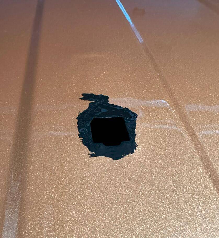

And then using the black (Figure its under the antenna, and it would be impossible to match the orange anyway, a high end black primer/paint would be best) I am doing a couple coats tonight and will get the antenna installed tomorrow with a bead of permatex around the compression seal, and near the front to keep any potential leaks around the forward dent.

You got very lucky with the way yours came out of the roof. My roof had a tear in the metal, and I have neither a welder nor any welding knowledge. Very happy to see you recovered with a much smaller spend and time suck than I did.

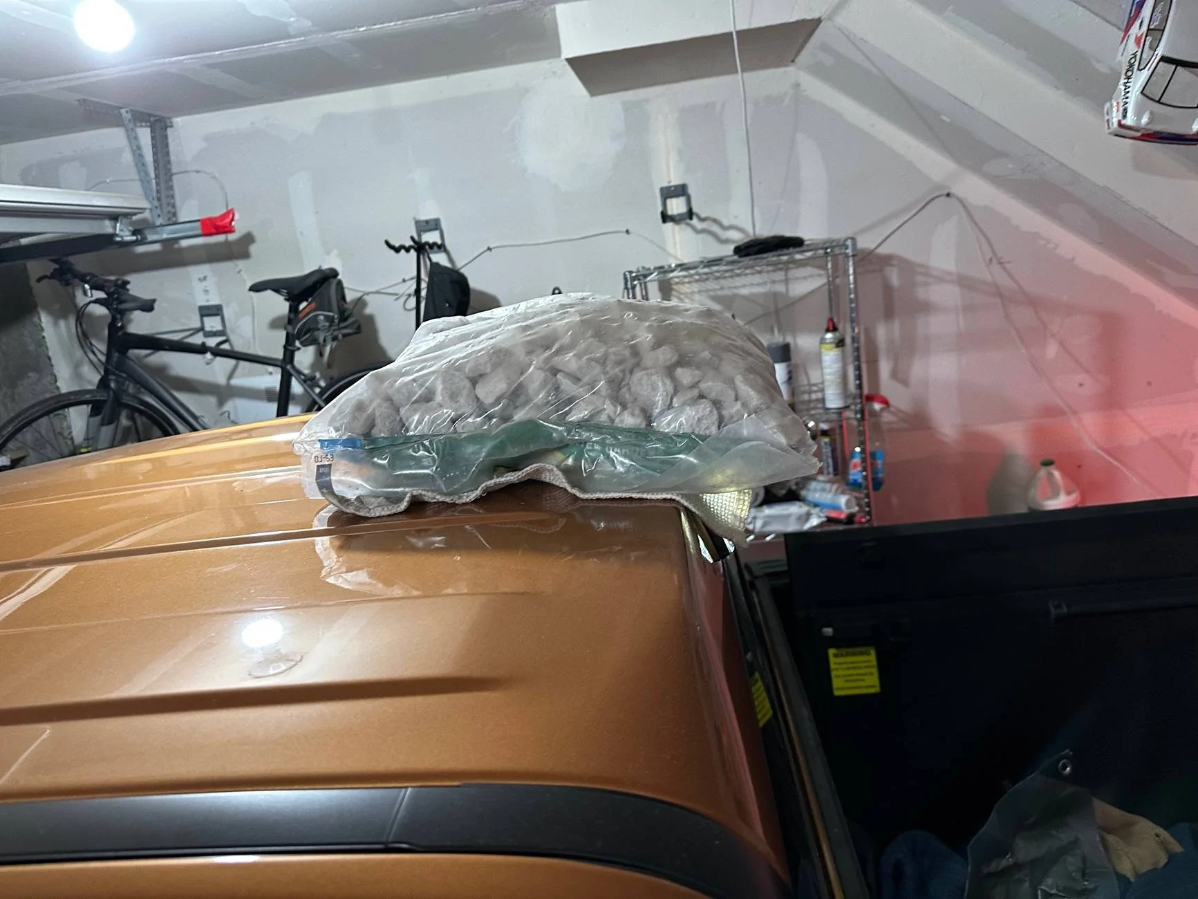

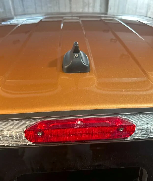

just got the antenna back on, with the RTV sealant under it. Seems my hammering was pretty ok as the antenna sat flush all but one rear corner. So I put a towel over it and a bag of rocks that I use in the bed for weight to push the back down a bit so the rtv will seal it all the way around. It’s also sealed at the mounting hole.
Stubby antenna ordered as well :)

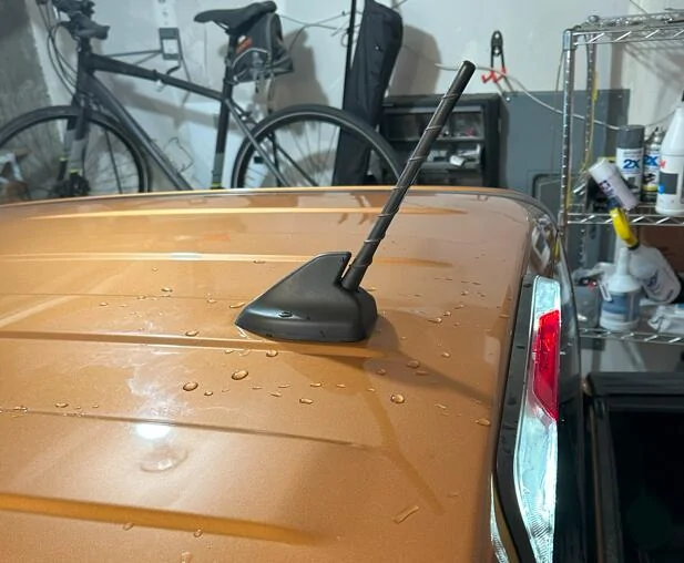

All Fixed! tested it with a deluge of water and good to go. happy this turned out easier than I feared! Tall antenna on for now until the stubby gets in.
