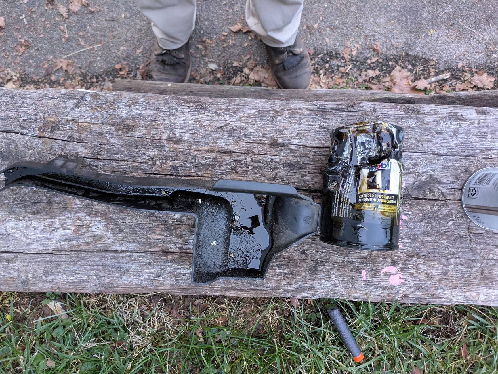

Stuck and crushed oil filter

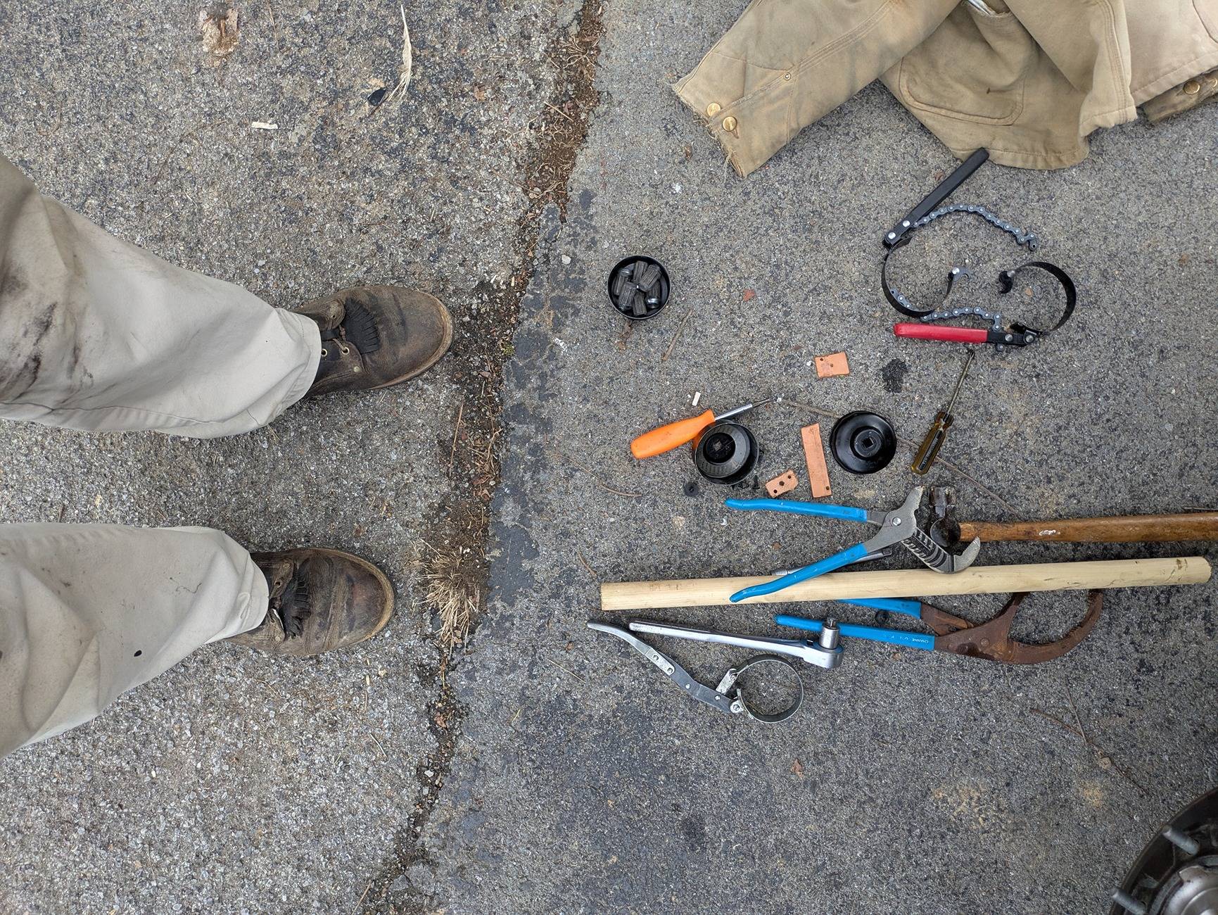

This was like my 5th oc on this truck.
No idea how the filter got on so tight.
Snapped Phillips means I already did the hammer thru the filter and snapped the Phillips while trying to turn the filter.
I got it off I removed that mouse trap oil drain path and that gave me just enough room for another another pair of channel locks. Attached is all the tooling I tried.
I'm going to remove the mousetrap thing too next time, that way I can get to it from below. My last filter was stuck and I accessed it from the top, but that's not easy or convenient.
You could get that tool that was posted. Turn your wheel and it's out in less then a minute. Then it drains out without making a mess.
