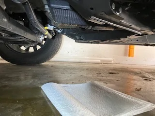

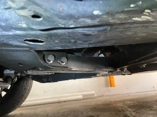

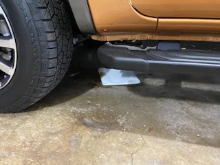

I found a puddle of brown liquid on our garage floor. I sweep and clean it. Then, I put in a clean paper towel. Waiting over night, I found a new leak. A brown liquid spread. Not sure if it is transmission or engine oil leaking. So, I checked the oil level in the engine. It was fine. At regular level. Puzzled. Any advice?

Looks close to where the oil filter drain “gutter” would drip.

Inagree with Mike on this. Itnis possible the filter drain didn't get cleaned well

My last oil change was last July with the odometer at 5,897 and now it is 8,557 miles. Just wonder why it starts to leak last week.

No idea why it would leak all of a sudden. To get to the oil filter turn the tires all the way to the right(unless you want to remove the drivera front tire) and remove the cover in the wheel well. After that you will see the filter and the drain gutter along the frame rail.

Many thanks to Frenchy and Slowmachine: you both are correct. I went to same Ford dealership who did my oil change last July. They found oil leaking from the last oil change filter and clean the drain tray. Many thanks.

Good catch. If you were parked outside on a gravel driveway, you probably wouldn’t have known until it was much worse.
