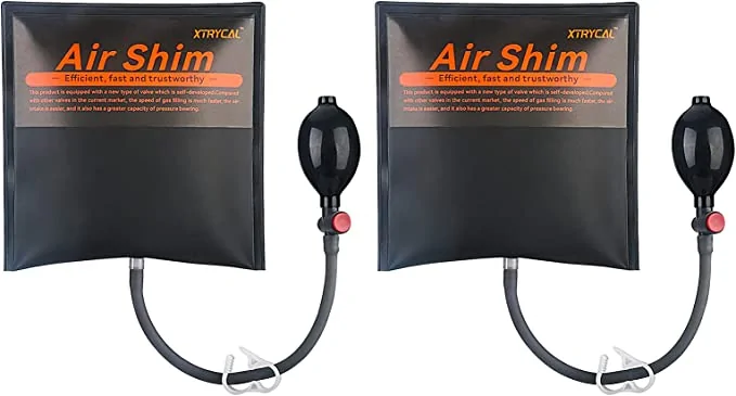

Most of these were new homes so they came that way from the factory/lumber yard. Although sometimes the carpenters have to remove them and these guys never check their setting from the last time they use their gun. Not a fun job when they're 8' solid core doors and you're only 5'7" trying to balance it on your foot while another tries to screw the hinges on. lol
Rookies, Pfffft.
Put this under the door and pump it with your foot.
