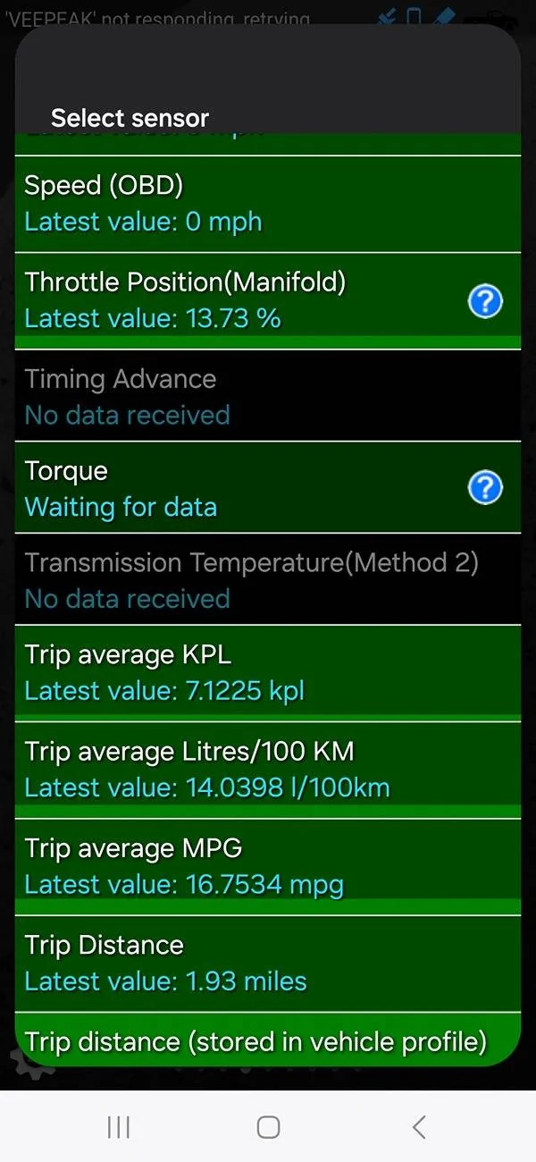

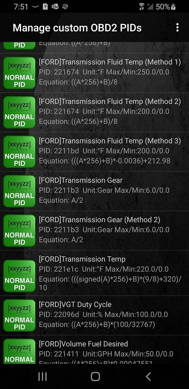

Have you connected to the truck and run it since you added it? It should be the [FORD]Transmission Temp one. The fluid temp ones don't work.

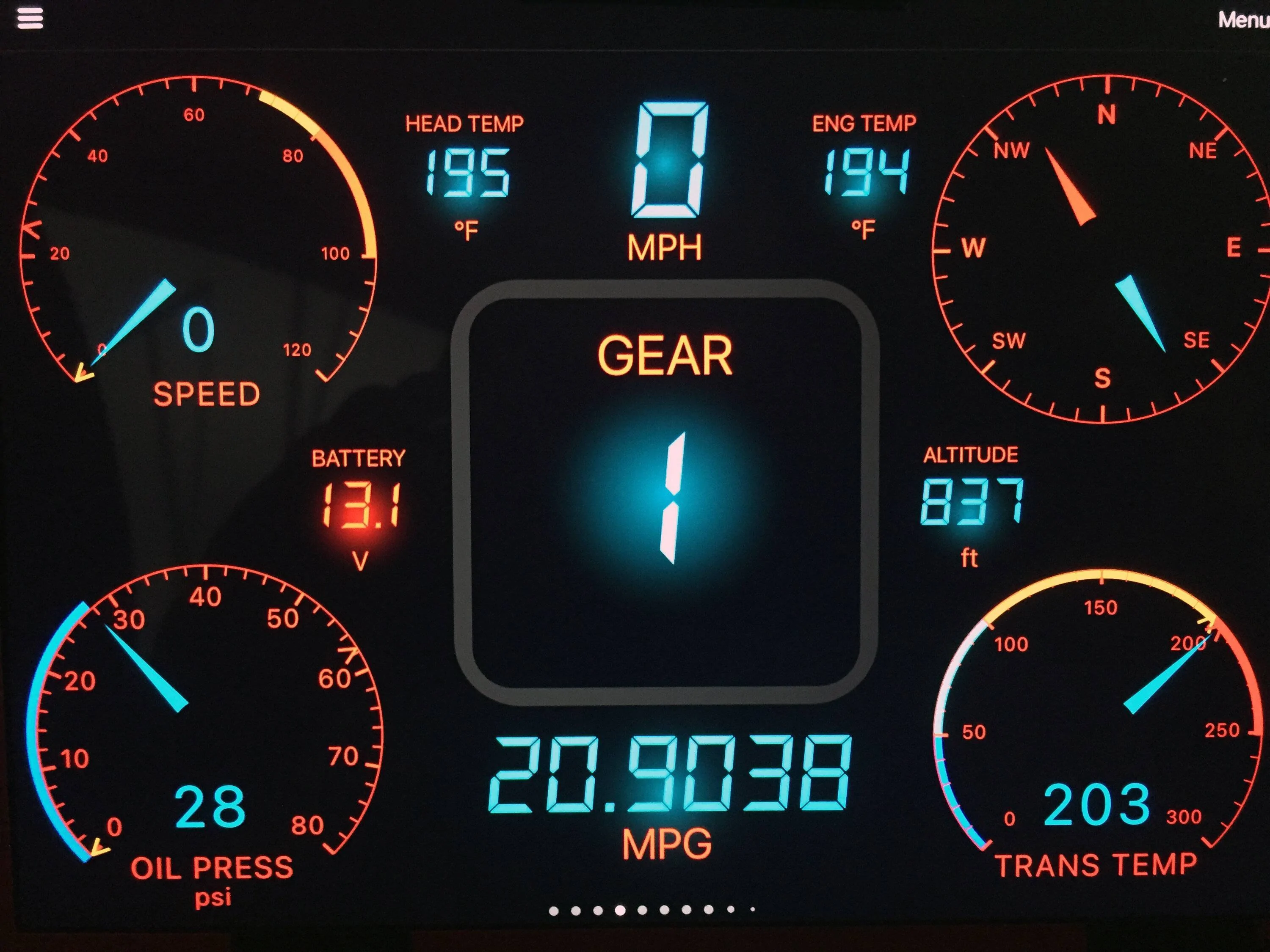

Found the problem. I had originally set up the app on my phone. I then decided to use my old decommissioned phone to keep my good one free and have a dedicated gauge display. My regular phone was robbing the connection so it wasn't connecting to the right one. Thanks again for the tips.
