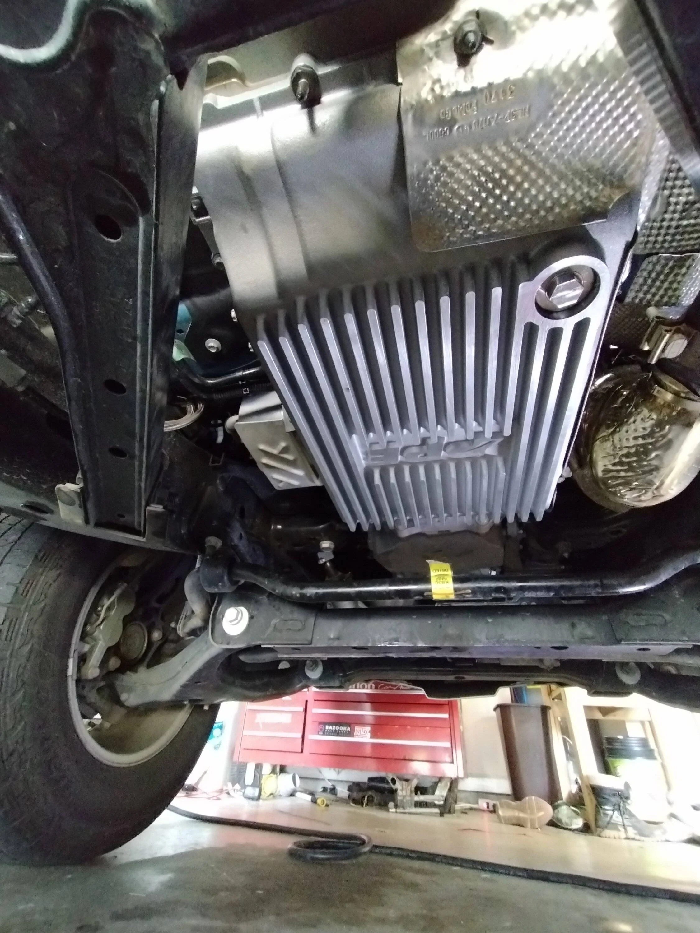

Follow up comments on high capacity PPE install, filter, and fluid change done today on lawn with truck level by putting blocks tires to level. Start 8 AM. 2020 XL FWD has enough room to crawl under without ramps or jack stand.
- warmed up fluid and pumped out 4 1/2 qts fluid with 12 V fluid pump, you need to use small hose for dipstick to fit in dipstick hole.

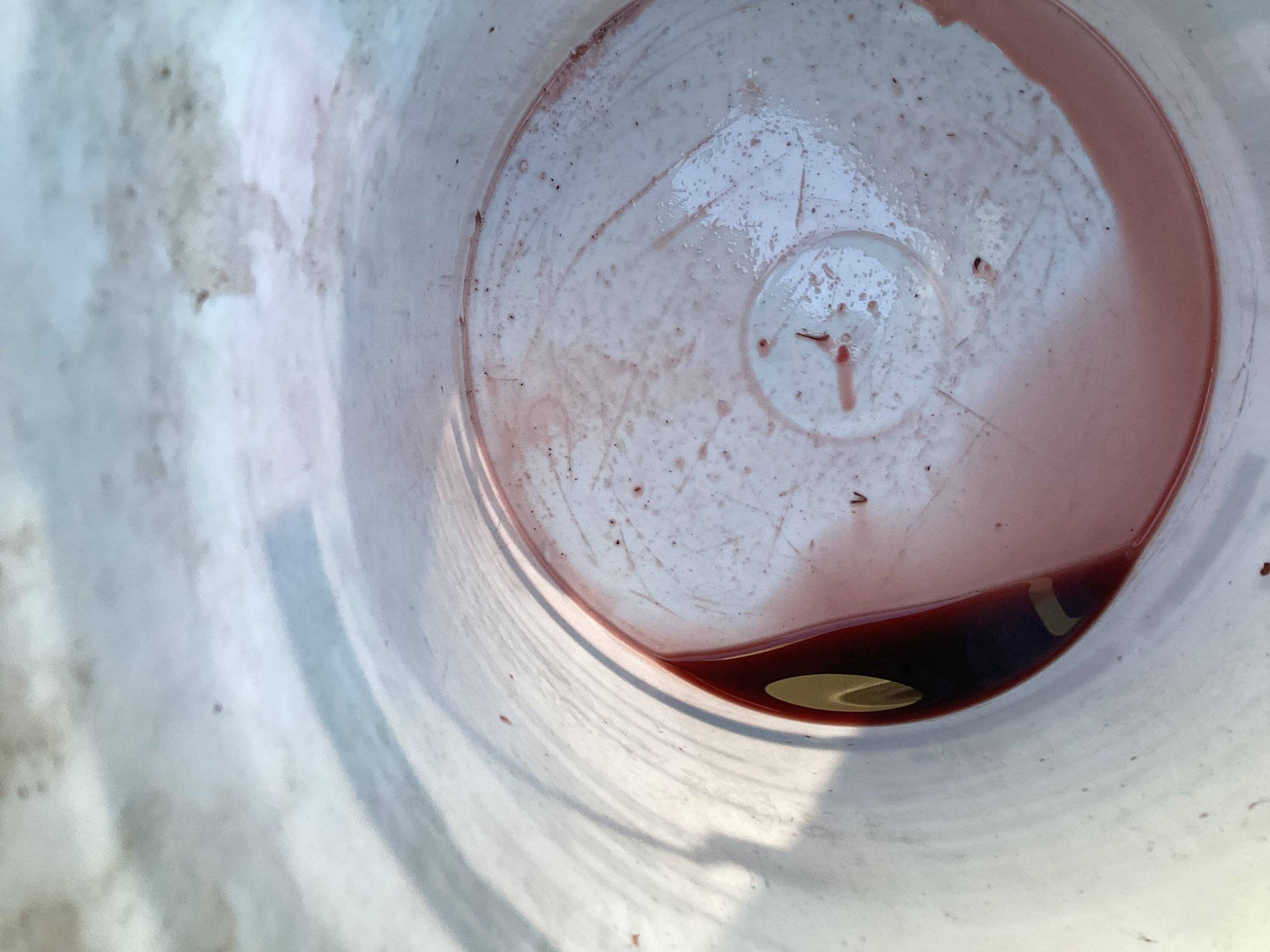

5818 miles 70% towing fluid dark red with black tint.
- loosen 8 mm and 13 mm stud bolts, three nuts on heat shield are 10 mm. They are not too tight .

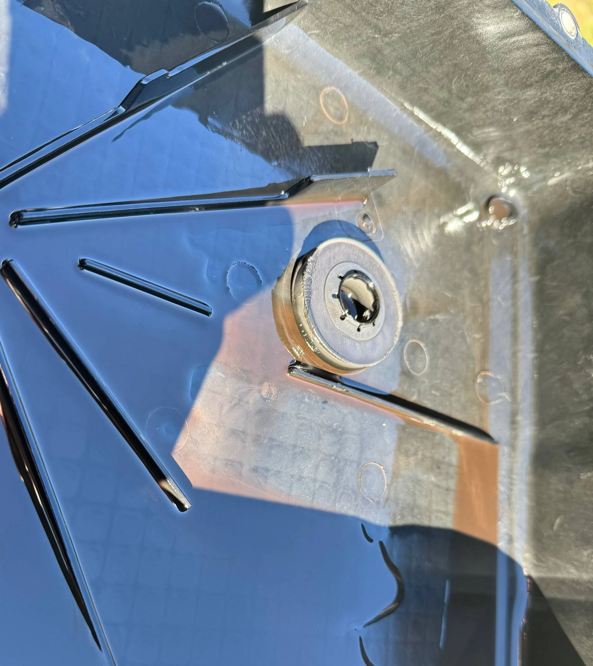

-estimated 1 1/2 Qts still in pan & filter, spilled on ground cover cardboard, magnet had some black slime on it no grit.

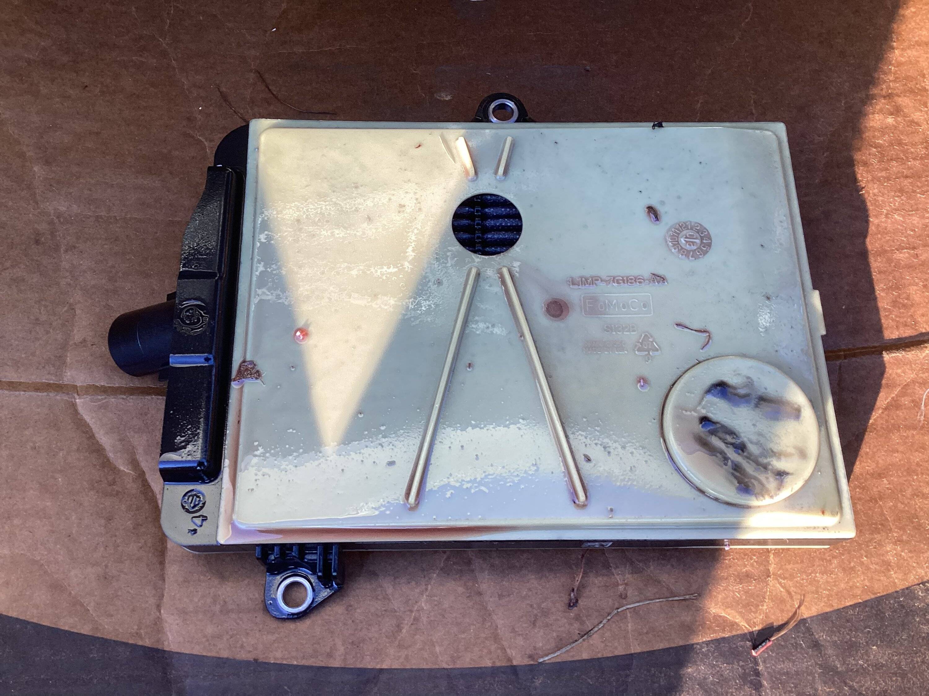

-wiped everything off and removed and replaced transmission
filter, paper had black film on it, will cut apart later, reused O ring.

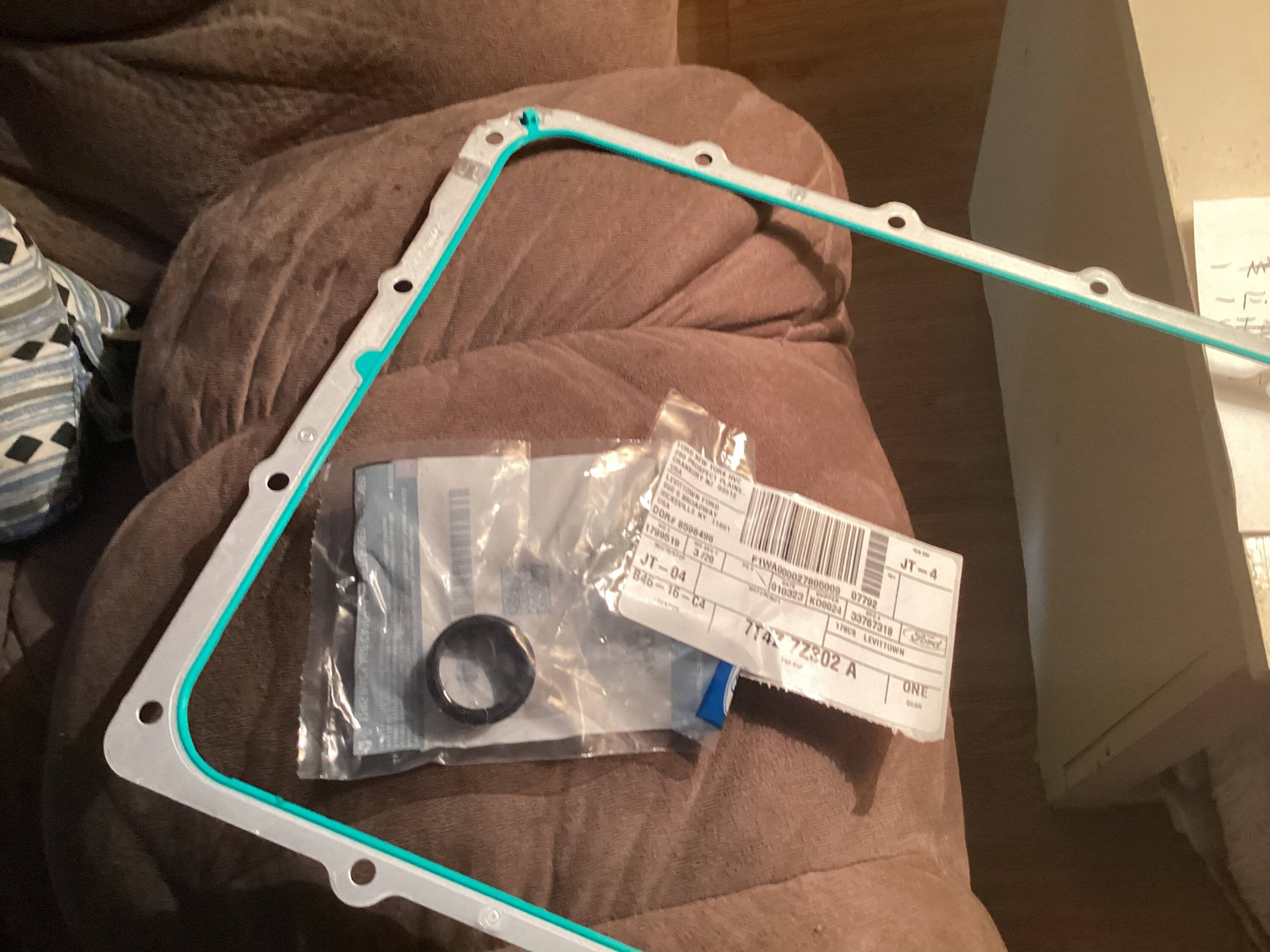

- push pan gasket on with locating pins, has some kind of 1/8 in wide seal bead made into it, Install 8 mm and 13 mm stud bolts
hand tight. Tightened bolts with 1/4 & 3/8 ratchet, from feel of tightness from loosing IMO torque wrench is overkill. 18 ft lbs= 236 inch
lbs, trust my feel more than hard to read Harbor Freight torque wrench.
-using funnel and tubing slowly add 7 qts Motocraft ULV from top.
Start engine, let warmup, move shifter, P, R, N ,D , S, compare to hot level from, oem an, add 1/2 Q t more.
- 12:30 pm PO delivers pan gasket, and filter seal from Levittown Ford, not used arrived not damaged.

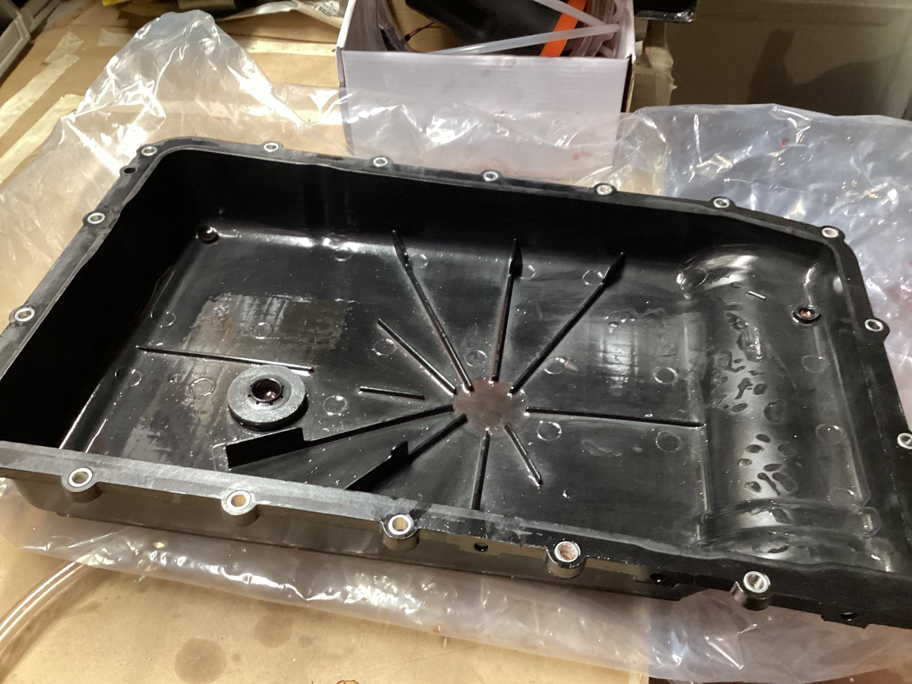

Part of my 40,000 mile service completed today.
Also, I did verify with PPE that the shallow pan holds about 1/2-3/4 of a quart more than the factory pan.
I thought I was losing my mind when I refilled the trans with the exact same amount as I took out and the level was way off.
Took me around 6 quarts total.

Ehh, maybe 2 hours? But that was me farting around taking pictures and all. If you have a lift, it is a 30 min job, but on my back and screwing around getting the fluid level right, couple hours. I used an air ratchet though, power tools make taking the bolts out and getting them snugged up much faster since these fasteners are a little long.

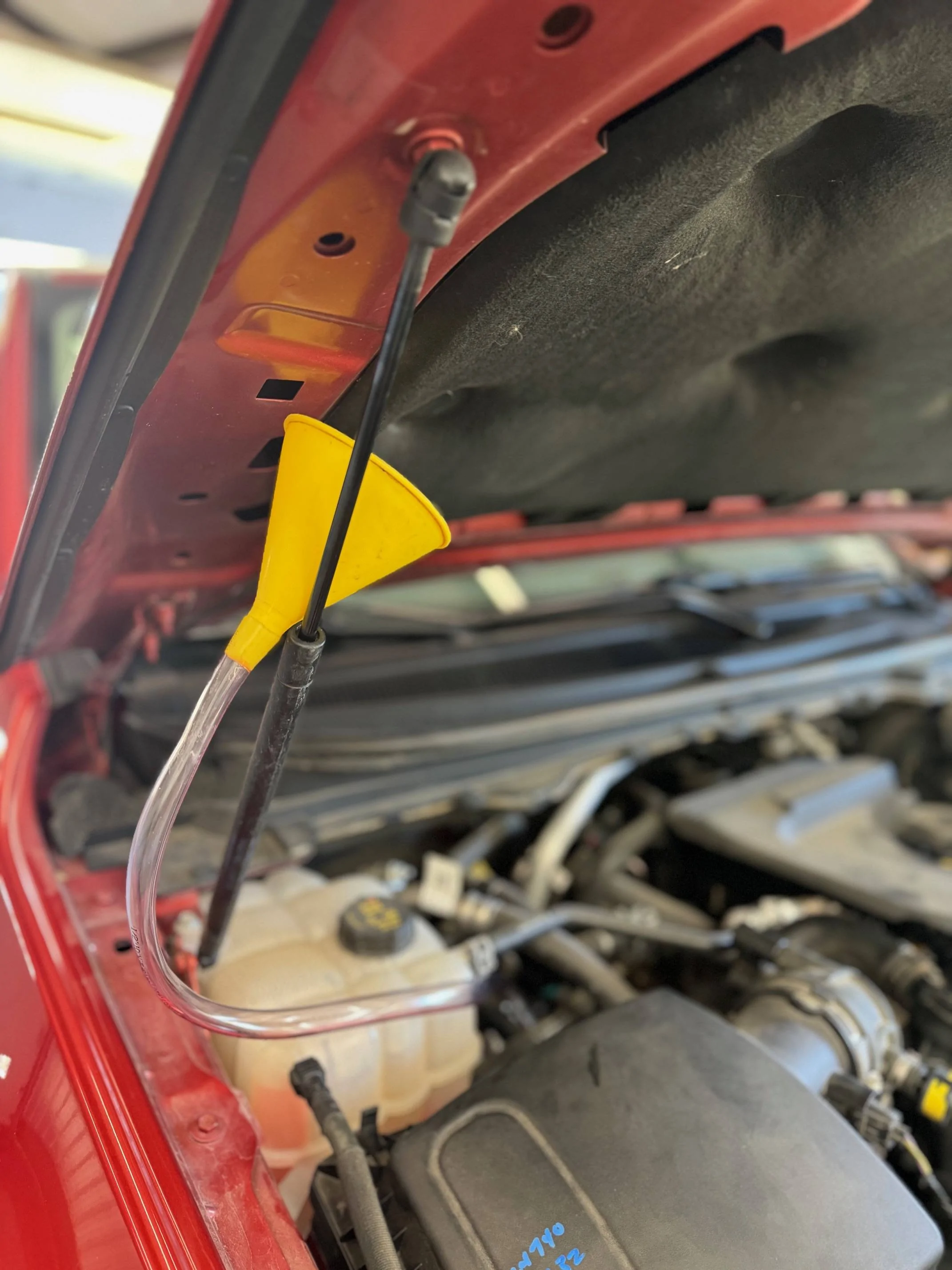

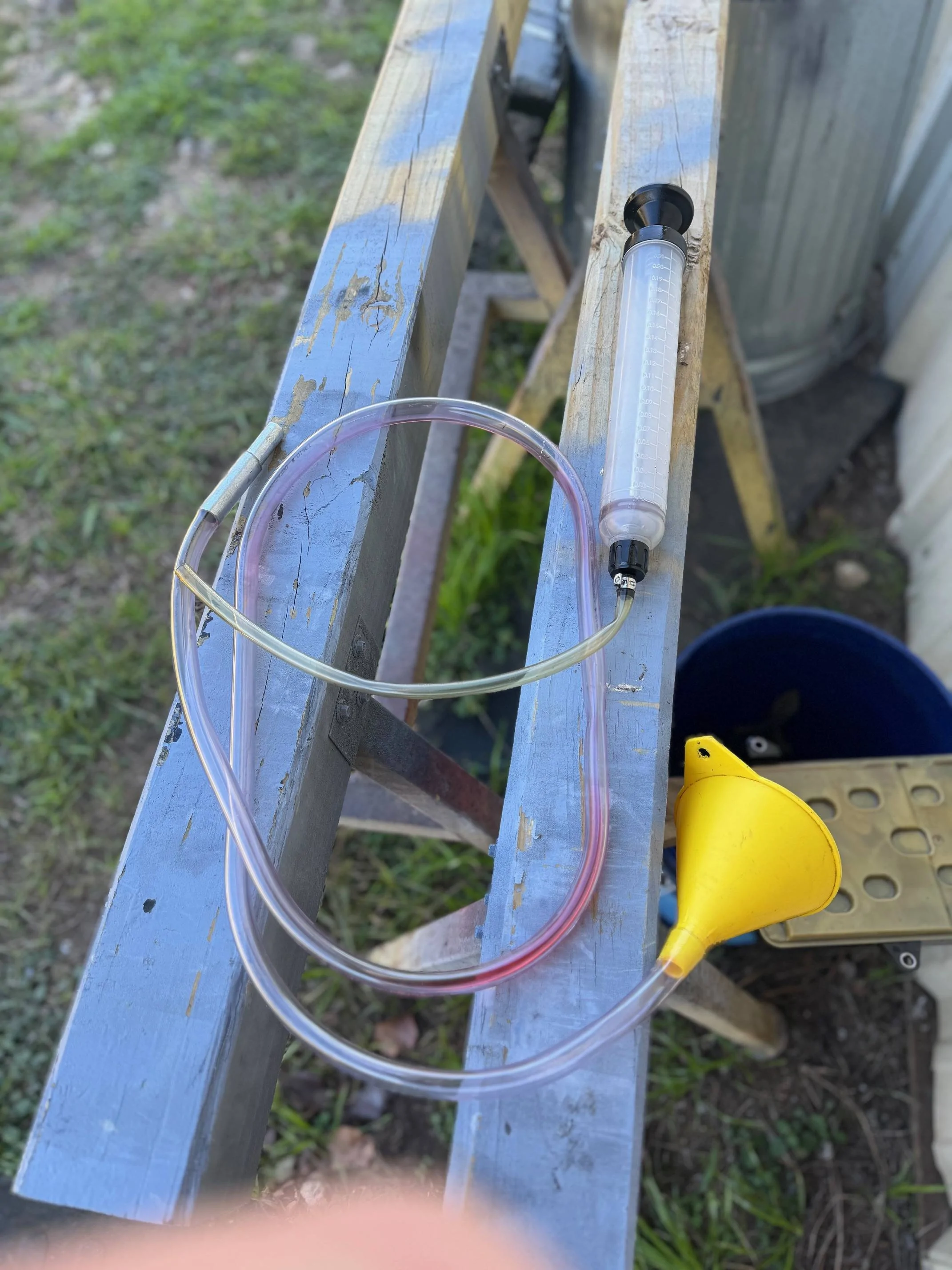

2019 2wd Scab @55k. changed fluid and added shallow PPE pan. Used a syphon gun to suck the fluid out until pan was basically empty. Made a funnel/hose extension to add fluid from up top. No issues whatsoever and happy with results. Fluid was clean with little to no shavings and a very small amount of metal on the magnet.
Bigdmag
Damon
Jun 21, 2020
Massillon, OH
2019 Ford Ranger Lariat Supercrew
COTA/L
What is the little metal tube (the one plugged into the end of the rubber tubing) called and where did you get it ?
