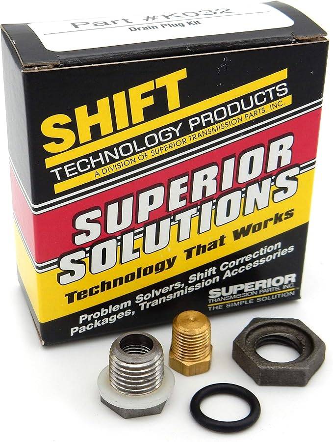

Had to share, I was going to get a $250+ pan just for a drain plug. Ill be ordering this instead. Doesn’t get hot enough here to need extra cooling anyway. This is awesome for fluid changes.

Easier to just add this. $18 bucks on Amazon.
Another member posted somewhere that he added it....grinded a few plastic outer fins to make a flush/surface and had no problems.
I do the sucky flush with Fitzstick and pump, but gonna keep this on hand for a pan drop to change filter, and install it then.

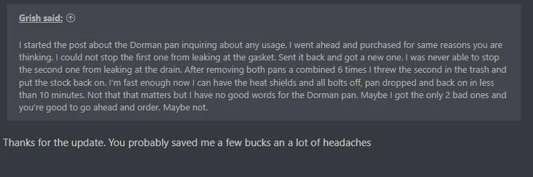

I was looking at those an I thought there were a lot of complaints about poor fit quality.

I was all set to buy the Dorman pan a few months back from Rockauto until I read the reviews elsewhere. I was bummed, but bit the bullet and bought the deep PPE pan and have no regrets! Well made and no leaks!

Guess I was slow on the draw and it appears that they suck….
A Ford tech told me they leak he said they put one on and had to put factory one back on.
