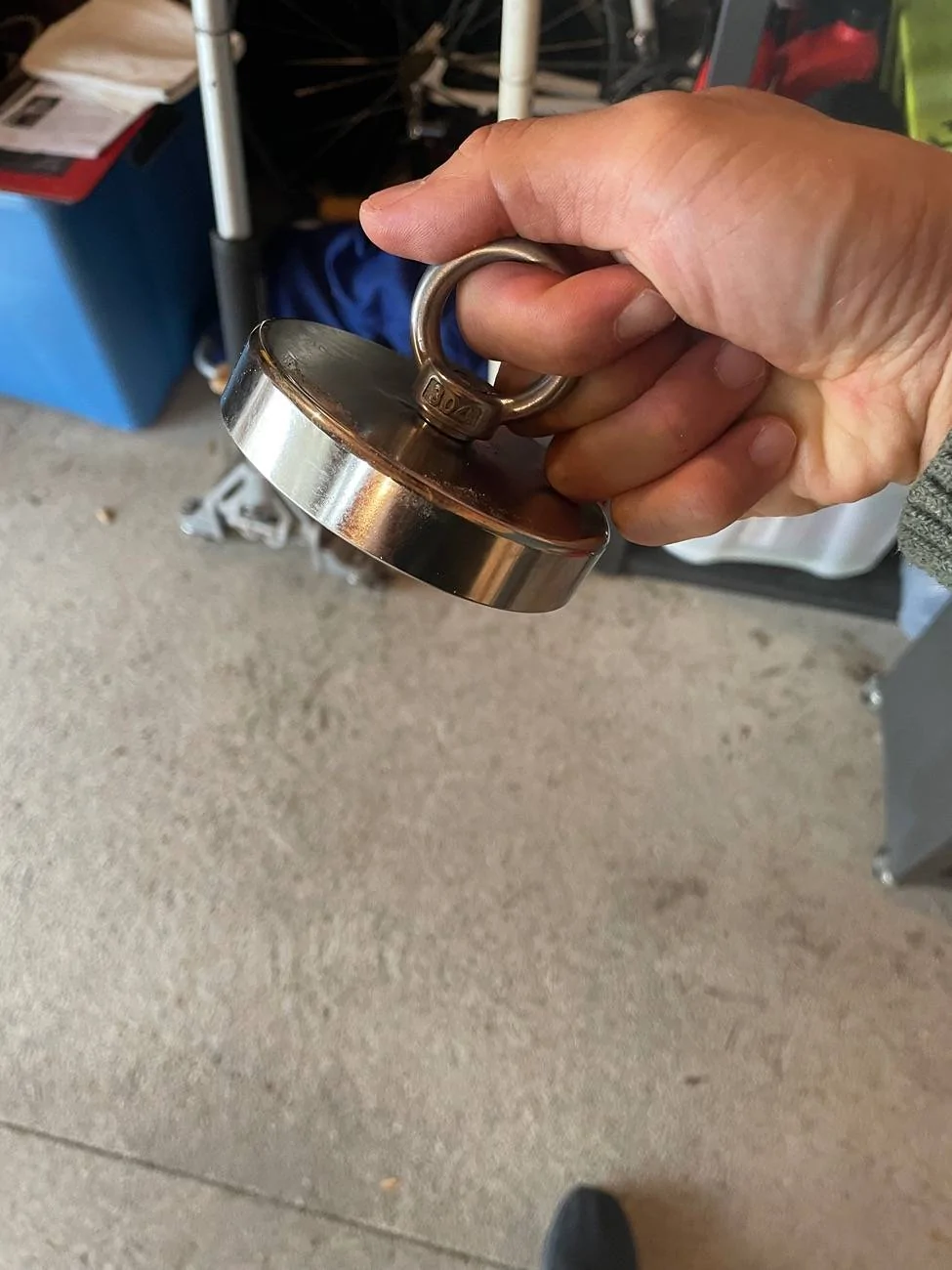

I ordered a super strong magnet on Amazon. It should be arriving by tomorrow. I'll try my luck fishing for the bolt again. If it doesn't work I'll try ordering one of those bolts.

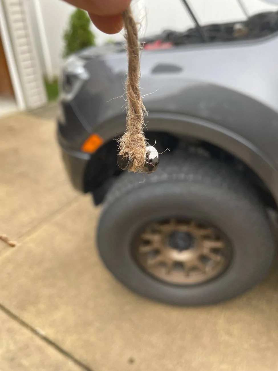

Before receiving the magnet from Amazon, I tried banging on the crossmember with a rubber mallet. I could hear the bolt ratting inside, but still couldn’t locate it. The magnet fishing WORKED! I was able to “drag” the bolt with the super strong magnet to the lower hole to where I could finally see it. I grabbed a second smaller magnet from the refrigerator door, tied a piece of twine to it, and lowered it through the upper hole of the crossmember. The bolt stuck to the refrigerator magnet and came right out!
