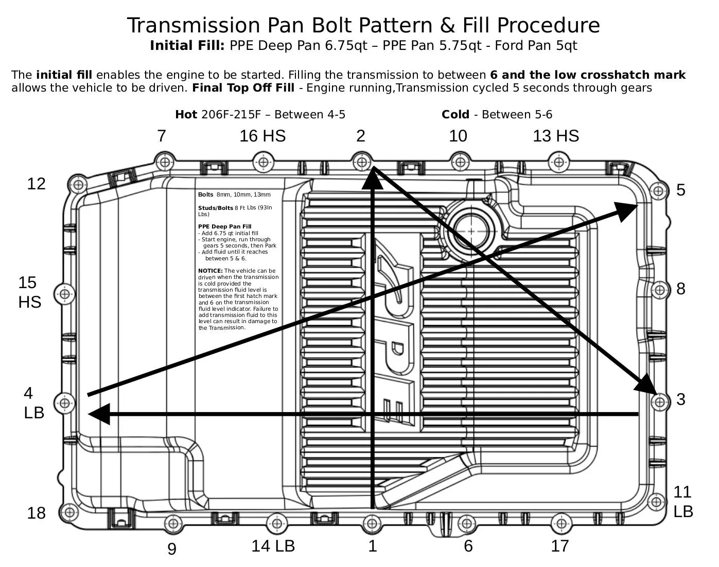

I just finished this chart diagram using PPE's bolt pattern sequence, Ford's Official fill procedure from 307-01 Automatic Transmission - 10 Speed Automatic Transmission - 10R80
General Procedures, mixed with the practical wisdom of Ford Tech Makuloco.
I'm installing the PPE Deep pan today, and will see how well my diagram and instructions work out.
I've pulled out 5 qt of fluid 2 days ago, and another 1 qt last night. I'll pull whatever is left in the pan today before the installation begins.
It will be interesting to see how well the fill procedure goes. This time around I can't just replace what comes out. PPE states the deep pan holds ~1.75 qt more. Guess I'm going to find out.
A "Thank you" to Sean ( seanellaz ) for building his chart, giving me the basis to draw from.
