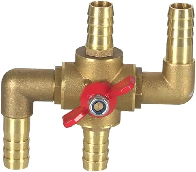

Tossed that valve posted above in, took 10 minutes, and good to go. No more heat from driver’s vents with AC, just nice cold air. Easily reversible if I ever want to go in and fix the stupid blend box.

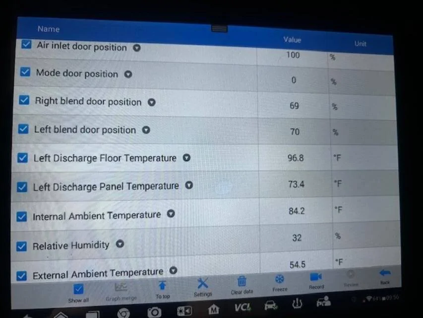

Per the manual to recalibrate the actuator:
Disconnect the connector on the actuator and the connector on the FCIM
Reconnect the actuator then the FCIM
But this is part of a complete wiring check of the control circuit (5-Volt Ref)
You could just pull the FCIM fuse (Fuse 12 at the BCM) Interior Fuse Panel, would be the same as pulling the connector on the FCIM.
But if you clear the code and then perform a FCIM SELF Test -It should cycle the actuators for a self-test, the problem is if you have a binding door the actuator may see this as end of travel and make that what it believes (thinks) is the full open / closed position and thus result in improper heat/cold distribution
It's easy to view with the proper scan tool - Live Data with Bi-Directional Control, you can command full travel and view it.
Example:
The issue with the actuators is that they are just small plastic gears, and a circuit board wiper, the wiper is the feedback for position.
If the wiper gets dirty it can lose that feedback and it gets lost and out of sync for position and then try to overdrive the door, click and pop sound - the plastic gears are jumping.
The binding of the door, if that is the case will provide the same sound as the actuator is trying to move the door past that bind and continues to drive it is jumping the plastic gears.
