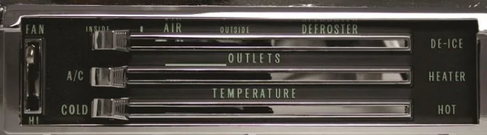

Wow. How did we ever survive before computers?
We pulled a lever or knob on the dash that opened or closed the heater door via a cable connection that never failed. But we've upgraded to computer controlled cheap plastic geared motors that fail all too often.
Sometimes less is more.
I had a very old pickup that actually had a hinged door that you opened to allowed heat into the cab.
