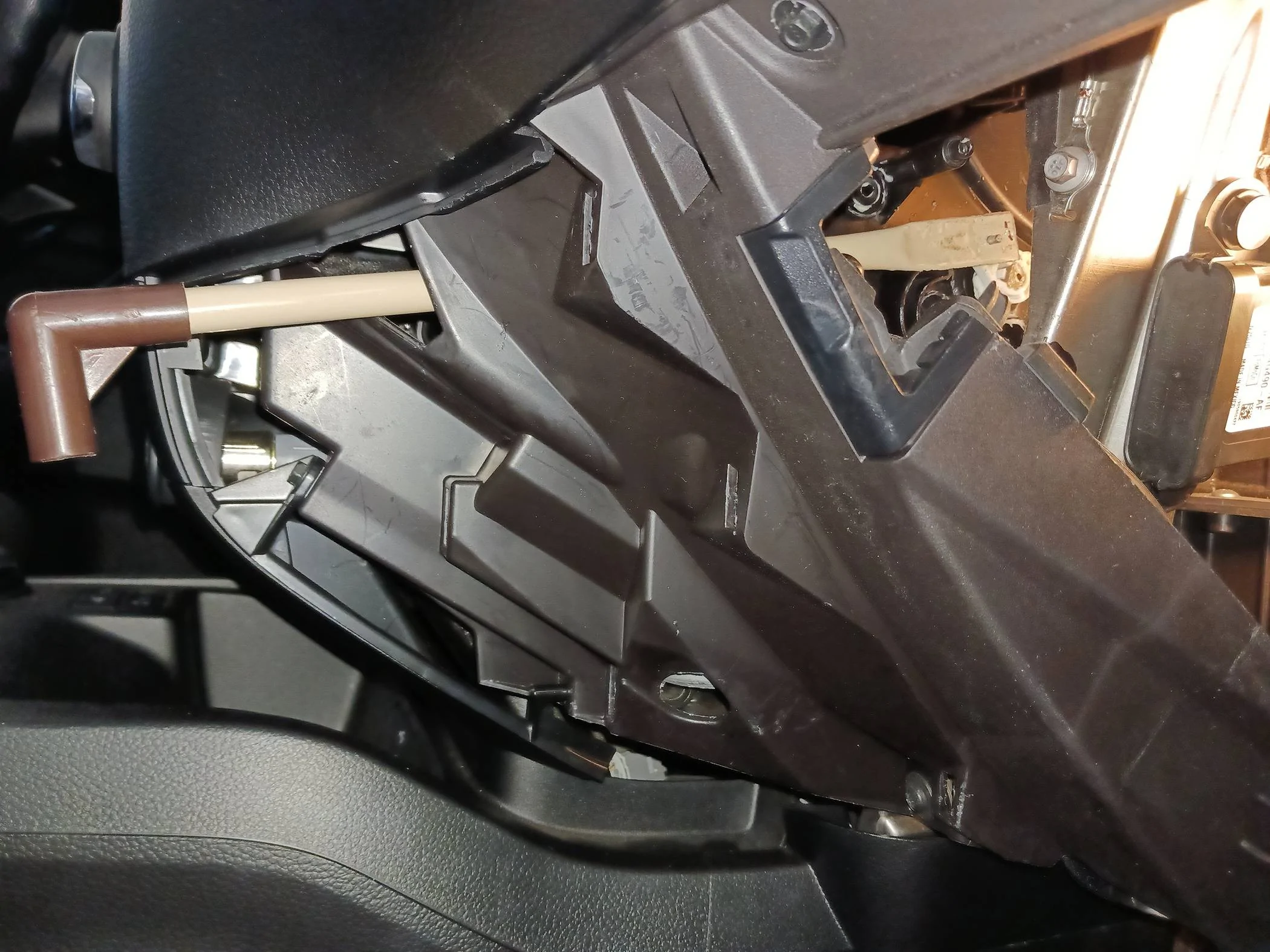

Had a little time so I made a new temp control rod for my temporary fix. Works much better than the wire, wire was too flexible. If I paint it black it would not be as noticeable.
I guess I should put this in the hillbilly DIY thread.
Good use for what appears to be a straw and a vacuum elbow.
Blue Streak
Larry
Jul 11, 2019
1,322
5,095
Actually it is part of an old laundry cart. Thin metal tube & the plastic corner tube connector. I save old junk for a reason. At the time I save it I'm not sure for what. ?

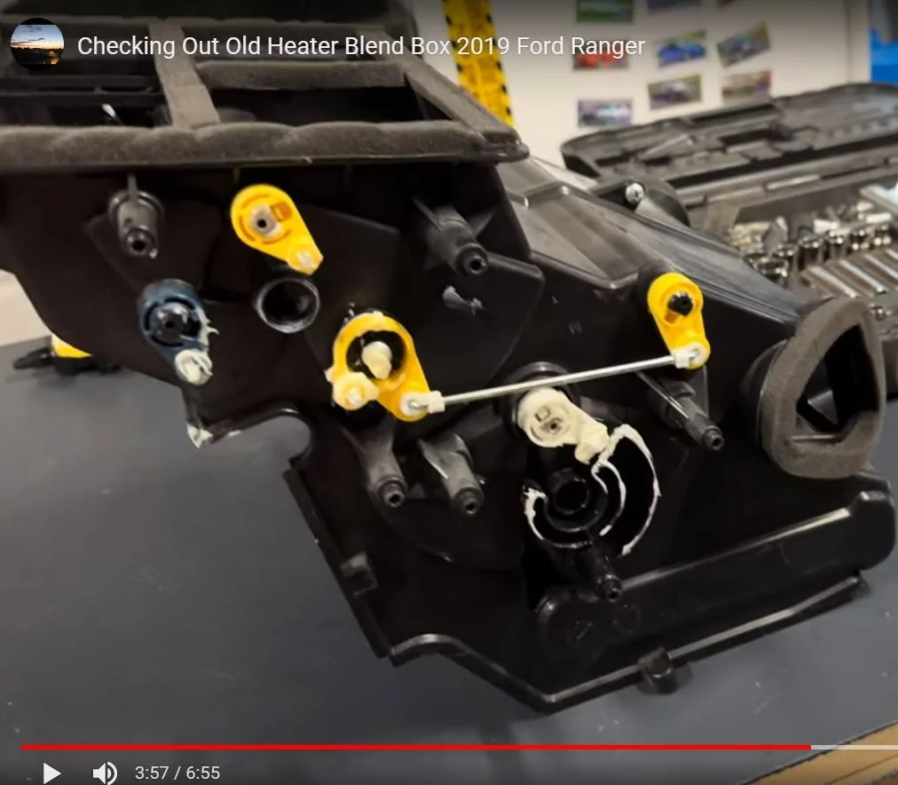

Yes, it can be done, but its a PITA to get to:
Somewhere on here there is a documentation on getting the Driver's side actuator out.
Limited access to the mounting screws and you can shortcut it by drilling a hole in the support structure to allow a screwdriver to be inserted through the hole to get on the screwhead.
Once removed you can manually rotate the door:
Now its decision time on what to do from here:
1. Leave the actuator - OFF and electrical connector connected, and then devise a way to allow manual movement of the door via (Dowel Rod or Similar)
This would allow you to manually adjust as necessary.
2. Manually move the door and then manually move the actuator to match alignment and reinstall the actuator and leave the electrical connector off.
Ref: Temp By-Pass by (Blue Streak)
This is on the passenger side, but same idea for driver's side (connected to the (White) lever that moves the door.
The white lever moves the Temp Door - This is the Driver's Side
Snapshot from (quangdog's) replacement video of the HVAC Box

My idea is working well. I plan on keeping my truck so down the road if I can find a retainer to fit the pin it will help keep the rod on & if I can dill a hole in the trim panel insert a rubber grommet it would look much better. Also paint the rod.
