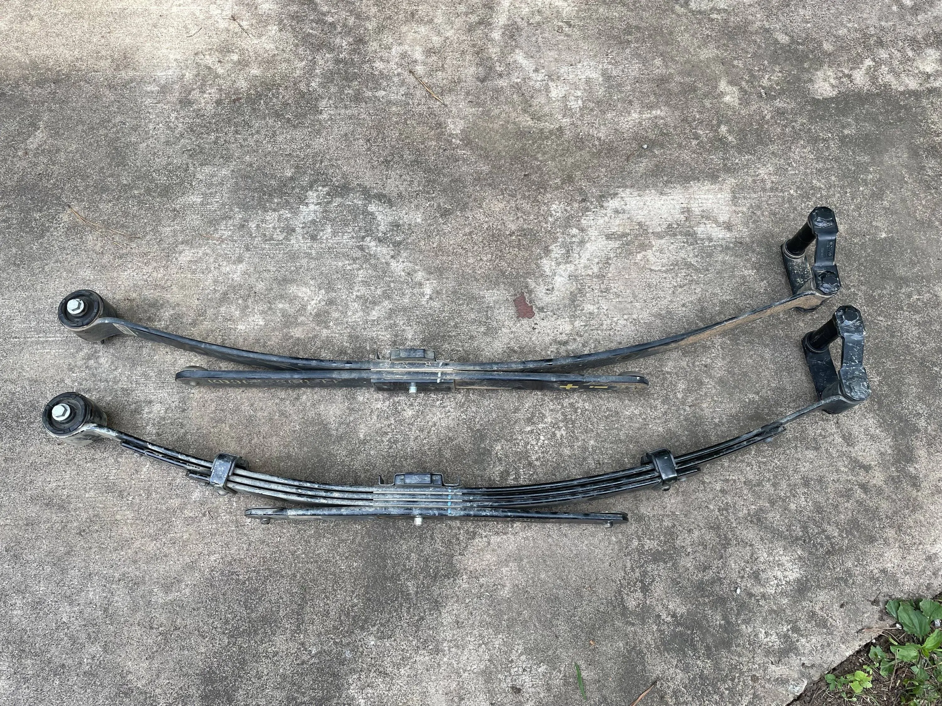

Yes.
The standard Ranger rear spring is a monoleaf.
The Tremor has a multi-leaf pack (5 leafs I believe).
I put Tremor leafs on the rear of my truck (already had Bilsteins) and it did improve ride and handling.
Edit: Just looked at the pics in my swap thread and they are 4 leaf.
