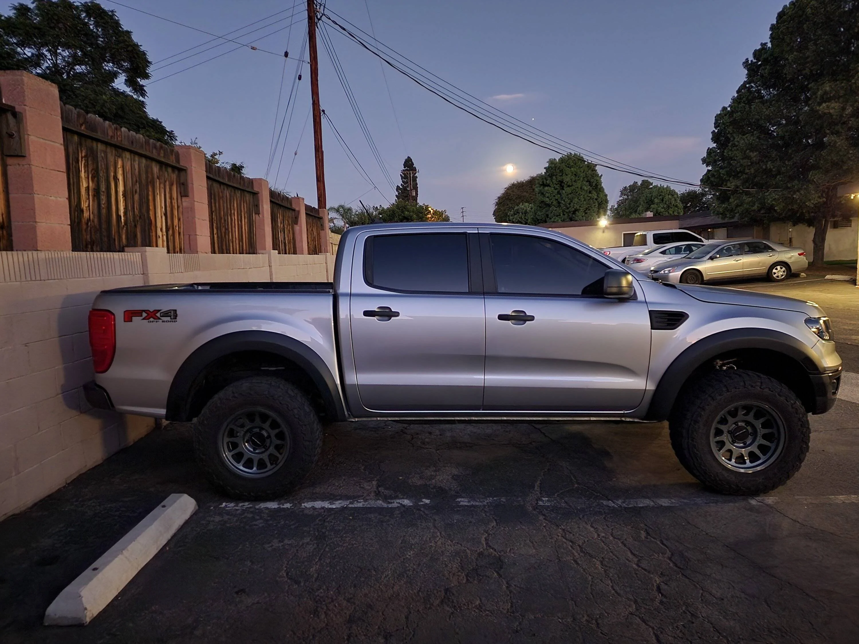

I can share my experience trying to solve this problem. I've got a 2021 xlt fx4 4x4, Sitting on 285 70 17 Toyo MT's on method 703's, 0 offset. I've tried a few different suspension setups.

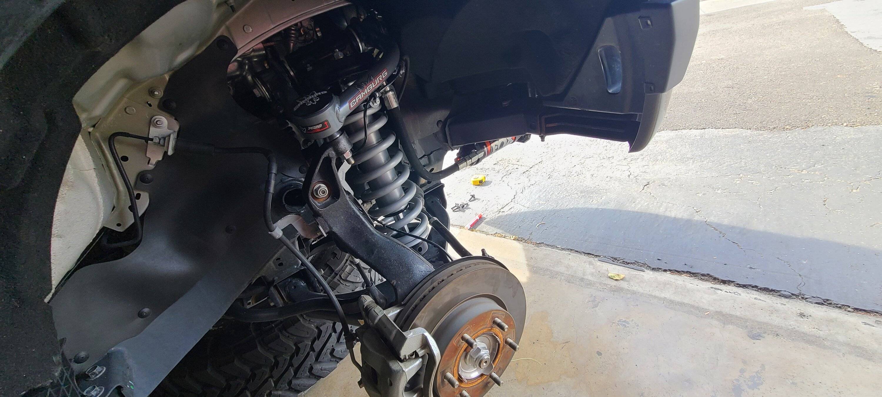

First I did the Fox 2.0 coilovers and rear shocks to bring up the front about 2.5" and leveling out the truck. This stopped the front end from drooping when coming to a stop and made a huge difference in stance and body role. Didn't notice too much of a difference from the rear 2.0 shocks to be honest.
Then I decided I needed a little more and went for Fox 2.5's all around where I did not notice a huge different in the front end but the rear end was a night and day difference. I was able to enter and exit driveways way faster and it absorbed a bunch in the rear.

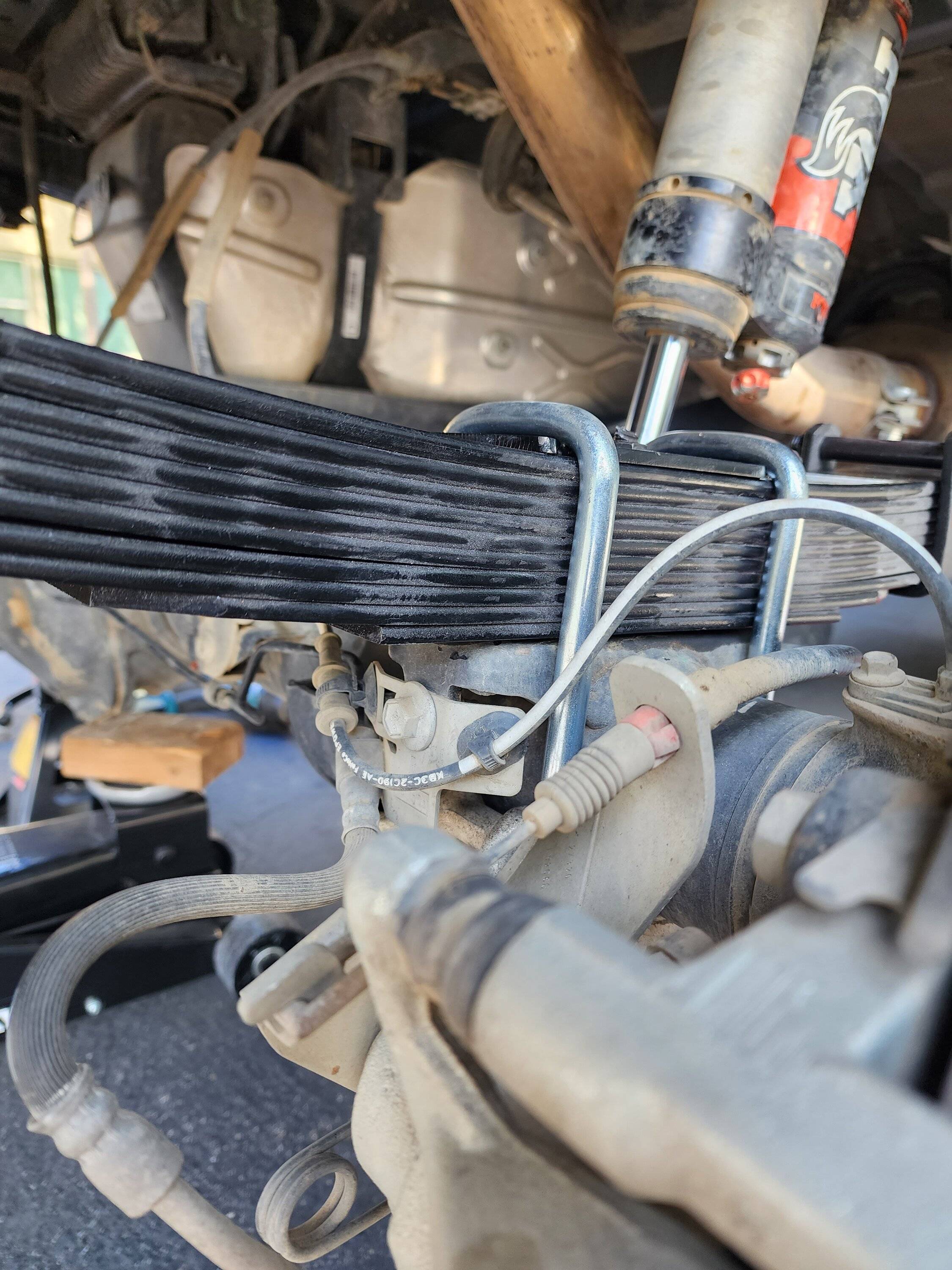

Lastly, yesterday I replaced the oem single leaf suspension with the standard deaver pack from APG (was on sale for $600) and I immediately noticed a difference on the freeway, greatly reducing the side to side wobbling in the rear and softening bumps in general. Looking forward to testing them out more and breaking them in.
Hope this helps!

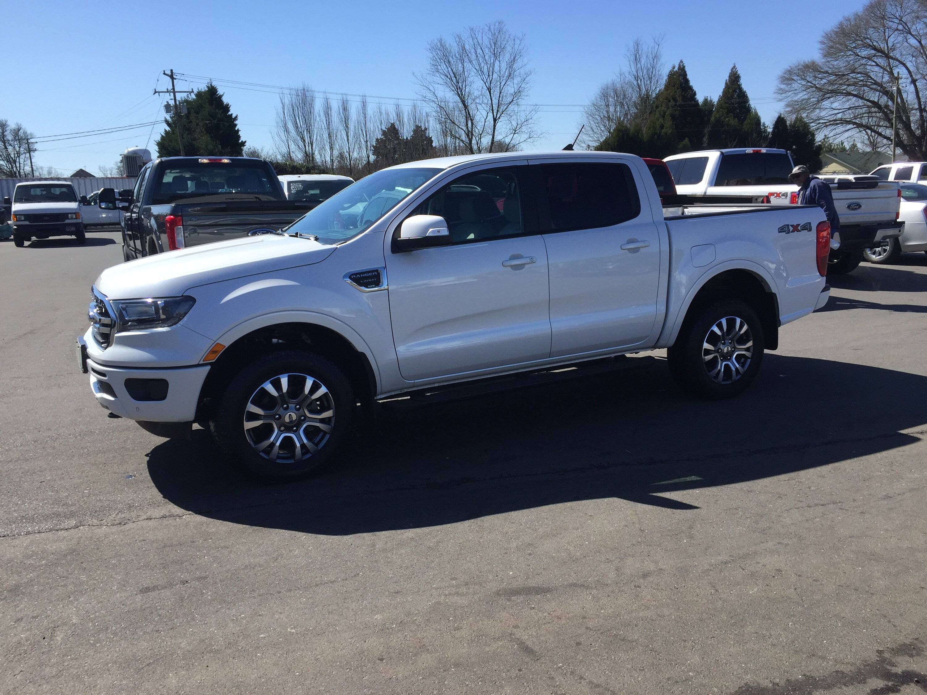

Well, it's a pickup truck.
The stock shocks are crap, with minimal dampening. The first of 4 new Rangers I've owned since 1988 that came from the factory with crap shocks. Bilstein Shocks/Struts made a huge difference. I paid nearly $1,100 installed.
Ranger has been undergoing a decontenting process ever since it was released to North America in 2019. Good shocks/struts were the first items to go apparently.
My 2019 Lariat:
