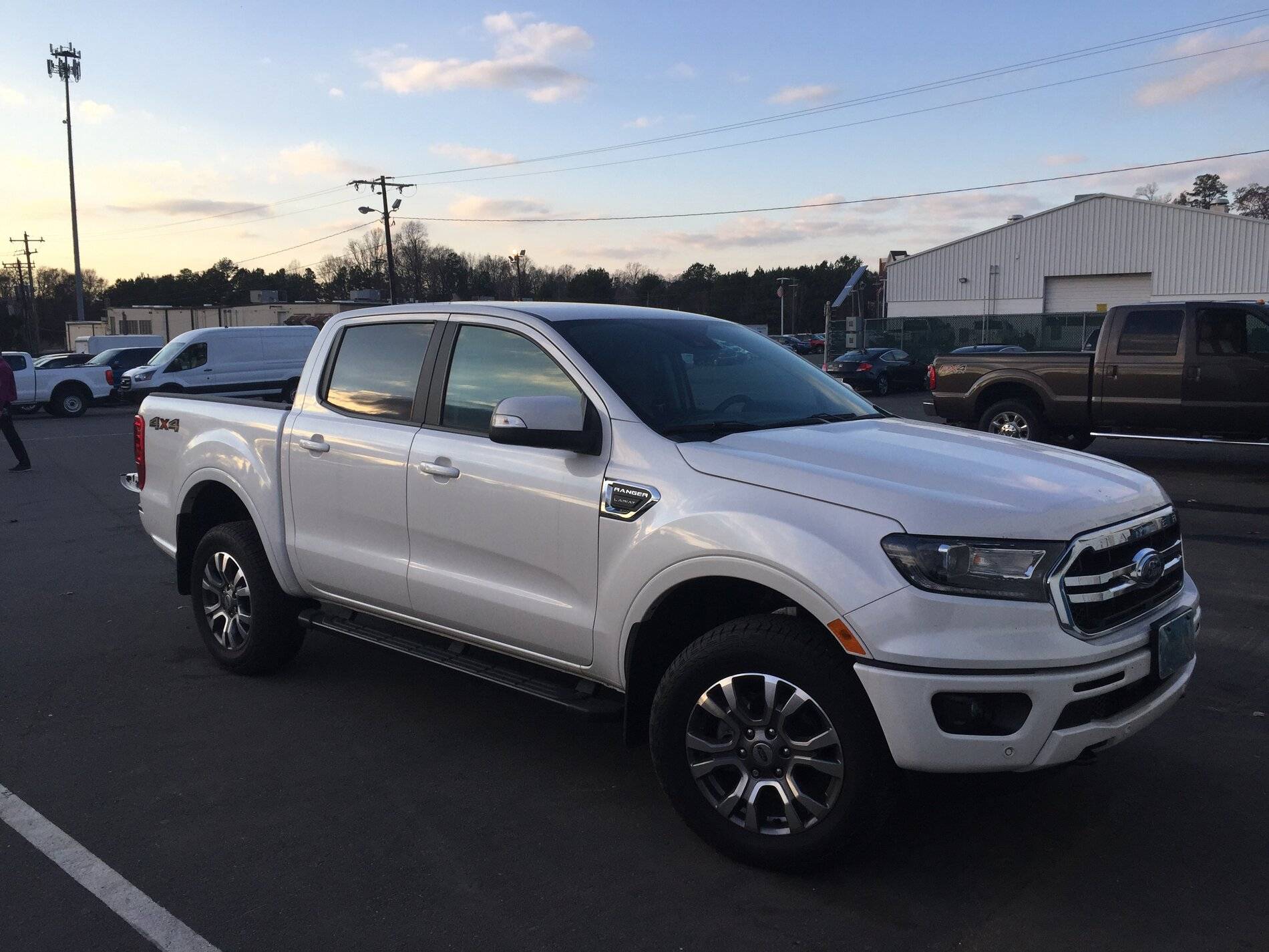

I own a 2019 Lariat 4WD Super Crewcab. Stock suspension and tires/wheels. WAY too much body movement, often feels like a pogo stick. Eibach Shocks appear to be the consensus. Pricing parts and labor this week as I'm traveling during the holidays to visit family - Lariat's turn this year.
Any and all comments about the shock absorber choice are welcome. Not lifting/leveling Ranger.

If you are not lifting or leveling the Ranger bothe the Eibach and Bilsteins are good choices. Between the two I would go with Bilstein.

I am still 100% happy with my decision to replace the rear shocks with the Eibachs. The truck should have came with something similar. I imagine there would be improvement if you replaced the fronts as well, but I am happy with the improvement from just replacing the rears. I had mine done. They charged 30 minutes labour.
