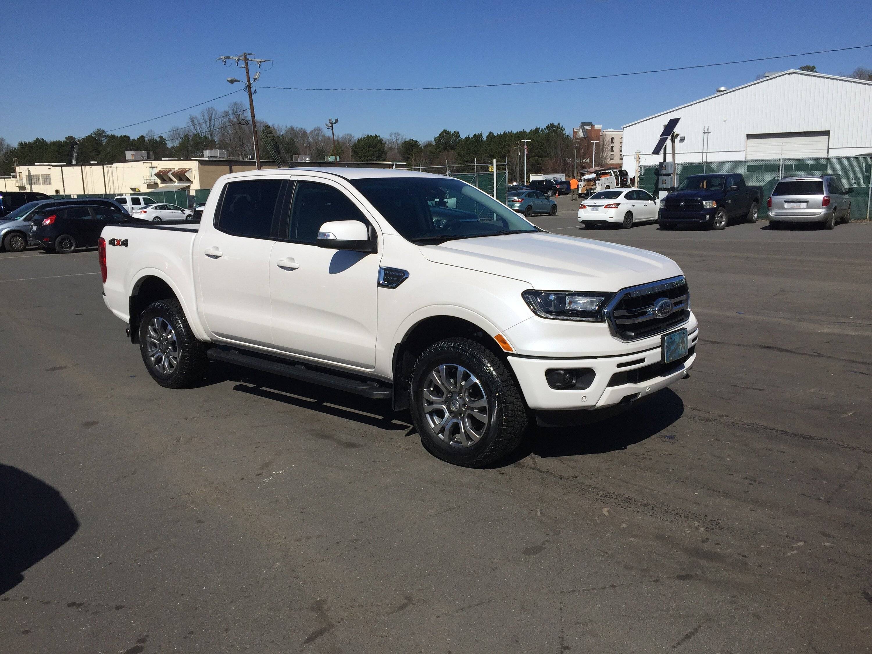

I see you modified your post without notation.
Common Wisdom dictates that if you put oversize tires on a vehicle, then one compensates by beefing up the suspension (better shocks for sure).
My tires are completely OEM as per the image-OEM shocks were woefully inadequate.
Occam's Razor thought process is only relevant if one used sound judgement from the start.
Simple definition: Occam's Razor is the problem-solving principle that "entities should not be multiplied beyond necessity".
That is just one of many "popular" versions...I personally like the one that states, "other things being equal, simpler explanations are generally better than more complex ones!" Cheaper, too, if the simpler one works...I am not of the mind that sound JUDGMENT is relevant: I just wanted free advice...lol
