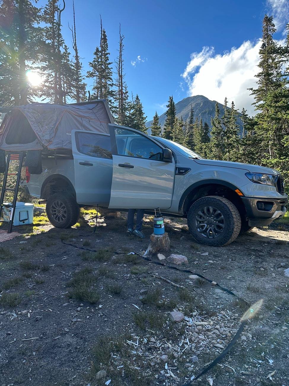

Thank you. I appreciate any support! My tires are all ~32psi. I don’t have the add-a-leaf on my leaf pack. I believe it’s set to the medium height adjustment. No lift pucks in the front. I don’t have my rooftop tent on it currently, but that makes a minimal difference in ride quality.

Icon leafs are at medium height. No added leaf. Even with a 200lb tent and the bed full of camping gear, it still vibrates the crap out of me and my passenger. I can feel every small bump through my seat, on and off road.
