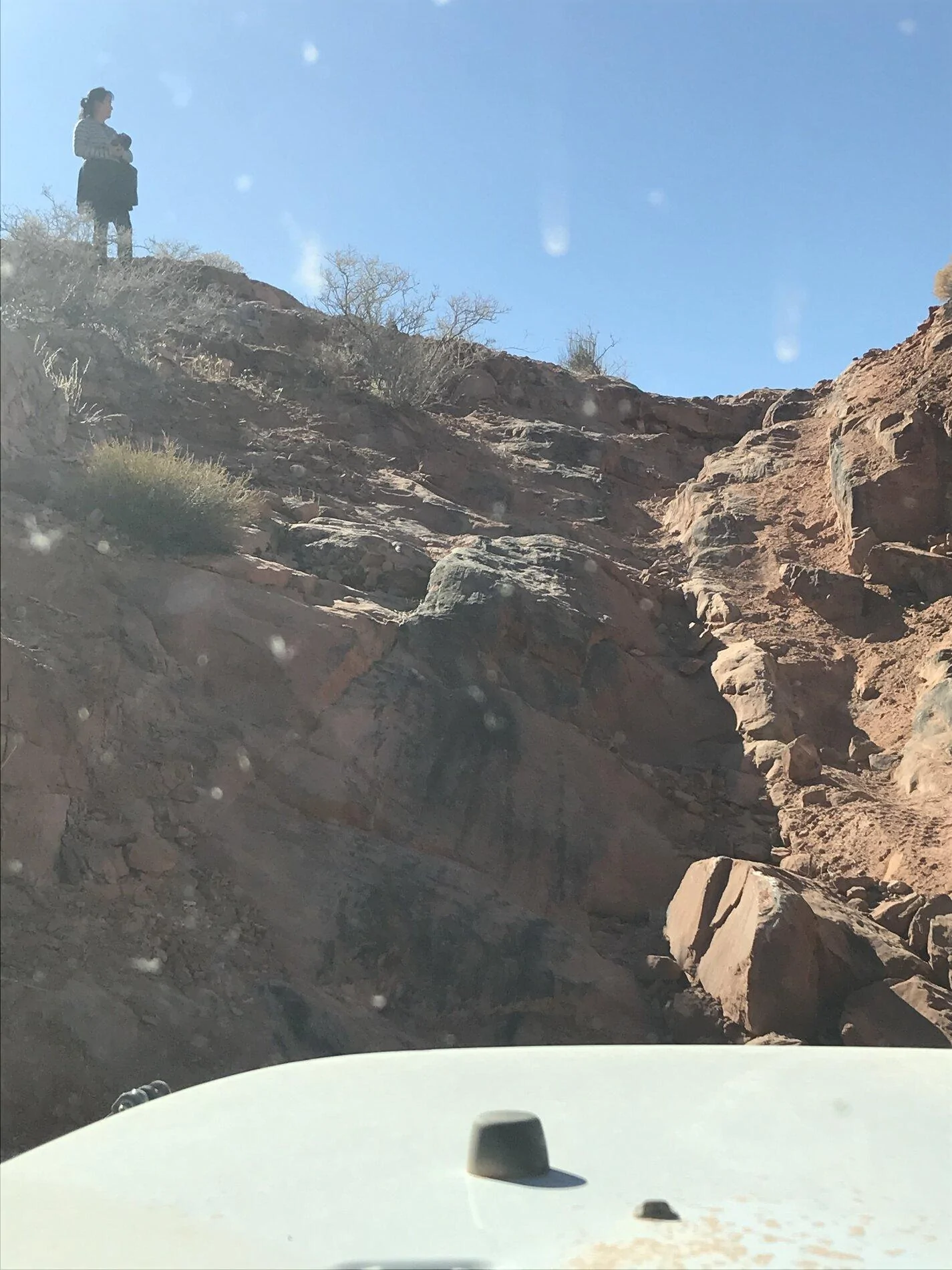

I can add a little to some of this discussion. Your gonna have to forgive the Jeep pics of mine but the pics should help a lot with what Iā€™m trying to say. My FX4 is on order so no ranger pics yet.
Iā€™m not going to quote from the other pages but I will just say a rear locker is my choice over terrain management. TM is great for what it is but a locker is the real deal.
Pics are of me and other Jeeps climbing a hill. Very basic stuff but if your new to 4wheeling it looks intimidating.
That is the small hill we will climb. 4lo and rear locker engaged. On the way up the weight will be shifting side to side as we climb onto different rocks and have an occasional wheel in the air.
Im at work so I will make a couple entries in a min with more pics as we go up the hill. ........

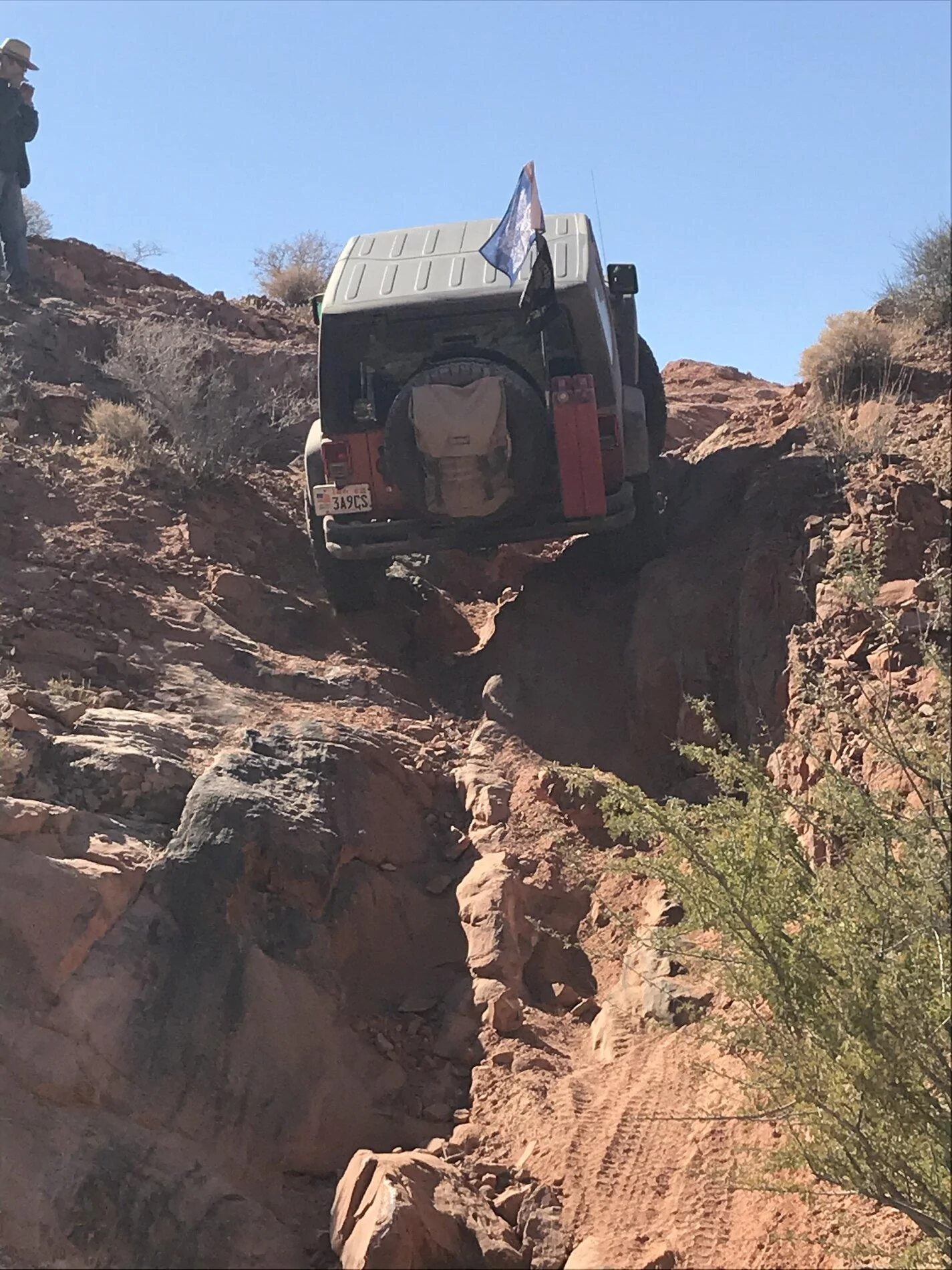

Jeep in front of me so you can see a reference to angle and size of ruts.
If TM was used when a wheel gets in the air or very light in traction it would spin faster than other axle that has all the weight on it. The Computer would apply the brake to the faster spinning wheel to try to send power to the wheel with all the weight on it and help you move forward. Your momentum would be very jerky and most likely start to lurch up the rock face.
Bouncing up the hill in a jerky jerky motion is a good way to break or damage components. Smooth is drama free and better control.

The rear locker made this hill a very easy climb. Both rear wheels turned at same speed and when one tire was In the air the loaded wheel pulled the Jeep forward until both wheels could contribute to the forward movement. The rock face has gravel and because the locker was on it didnā€™t matter if one wheel was on gravel and the other on dry rock. It was a steady momentum constant climb. TM would get you over also but not a smooth constant ride like a locker would.
Once I crested the top I would take off the locker. I only engage it for the climb. I used it for 30 seconds from start to finish. A locker is a temporary use item to get you past an obstacle. In the 7 years I had my Jeep I probably used the locker for 10 minutes if you add up all the locked time.
Now, before someone says they would not do that with their ranger. We had a stock Tacoma 4x4 with no locker in our group. He made the same hill up and over. He scraped and spun and hopped but he got over. A Ranger can clear this hill. You may not be able to but your Ranger 4x4 can.
