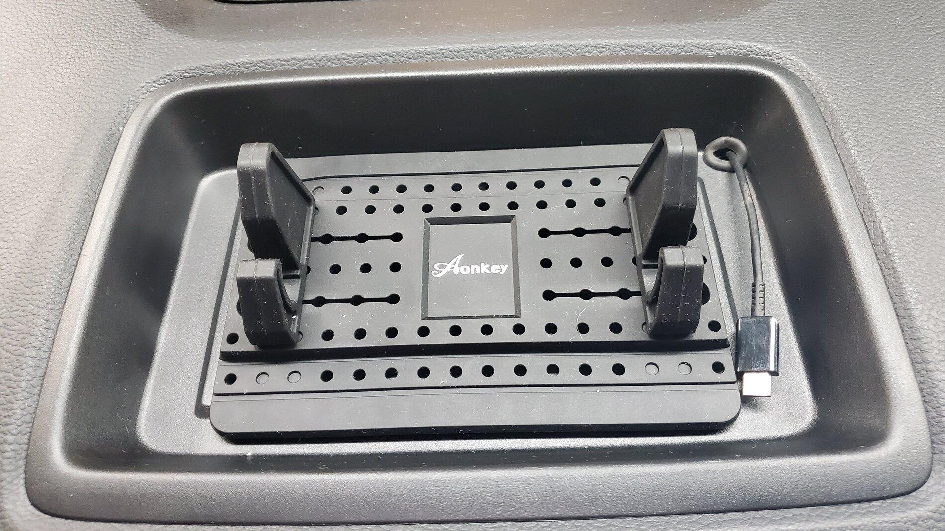

Pop off the right side dash cover/vent and the right side cover down by the USB ports.
You don't have to fully remove the dash cover, just pop out the part near the radio.
I left it attached by the passenger door and had plenty of room to work.
You will be able to get in there easily.
The only difficult part (and it was not really difficult) was getting the cable to come out at the back of the tray there.
You have some room by the AC vent to move it around to get it to line up so that you can grab it.
I have one of THESE and thought I might need to use it but I never had to.
EDIT:
I went out and took some pics to add a bit more detail as to how I routed the cable.
I have the handy dandy trim tool kit but you'll only need 1 of the tools. The one on the top right. If you don't have the trim tool, you can probably use a butter knife just be careful not to scratch the dash.
Start under the vent on the passenger side and pop the cover loose across the bottom. The top will come loose and the cover will swing out. No need to remove it completely.
You can see where my cable is routed next to the AC duct.
Now open the glovebox and remove the side cover. It just pulls straight out.
Now you can see how to route the cable and get your fingers in there to guide it.
Hope this helps out.
