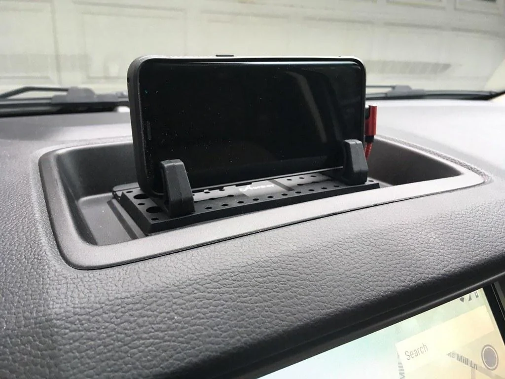

I did a bit of drilling on the factory tray and now I am happy.
The Aonkey cellphone holder works great with my S8. I was always forgetting to grab my phone when it was down in the lower bin with the USB ports, and if I put it in the tray up top the cable draped up across the dash was always nagging me.
The holder has the super sticky rubber backing discs and works well with the ribs in the dash tray. It doesn't budge at all.
The phone holders are a semi-flexible rubber and hold the phone very securely while allowing for easy insert/removal.
Drilled a small hole in the rear of the factory tray for the USB-C cable to come through
I routed the cable behind the dash so it's no longer in the way. Comes out behind the phone for easy connect.
Poke it through the hole in the factory tray and snap the tray back down. Drop the phone holder back in place and Voila!
Routed the cable behind the cubby where the USB ports are located.
Now my phone is front and center so I don't forget it, easily popped in and out, always connected for Android Auto, and also perfectly positioned for running an offline GPS trail app (Locus Pro).

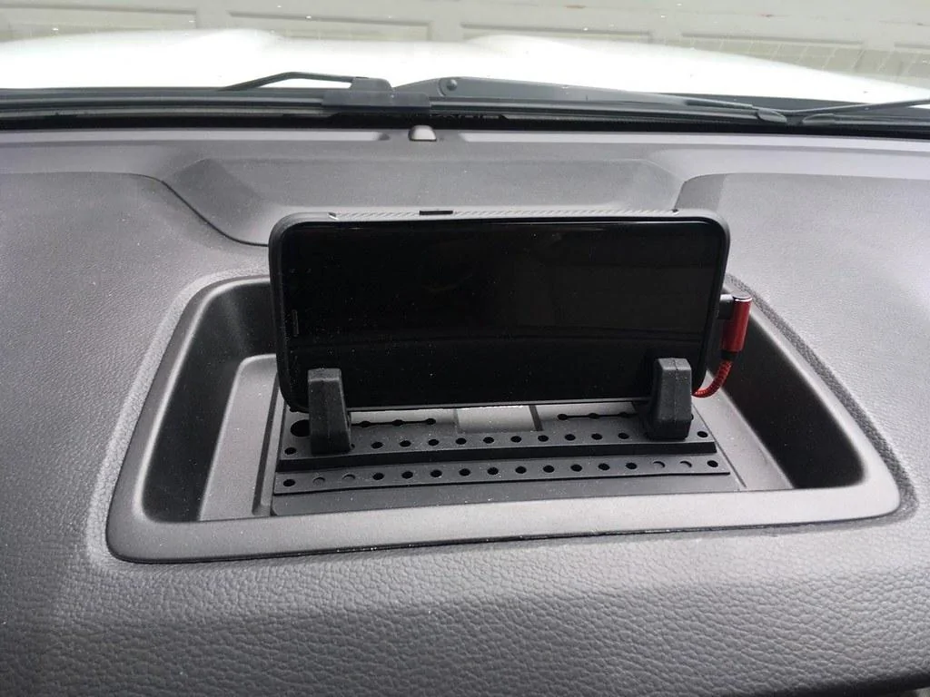

Here are a couple of quick pics of my phone in the holder.
The viewing angle is spot on.
From the driver perspective, the top of the phone doesn't encroach on the windshield view at all. It's below the wipers.
How hard was it to route the cable? What length cable did you use? Picture with the phone mounted?
Very easy. remove the right side dash trim and the right side center console trim and you have plenty of room to route the cable.
I used a 4ft cable and there was plenty of slack.
I think a 3 ft would probably be fine.
