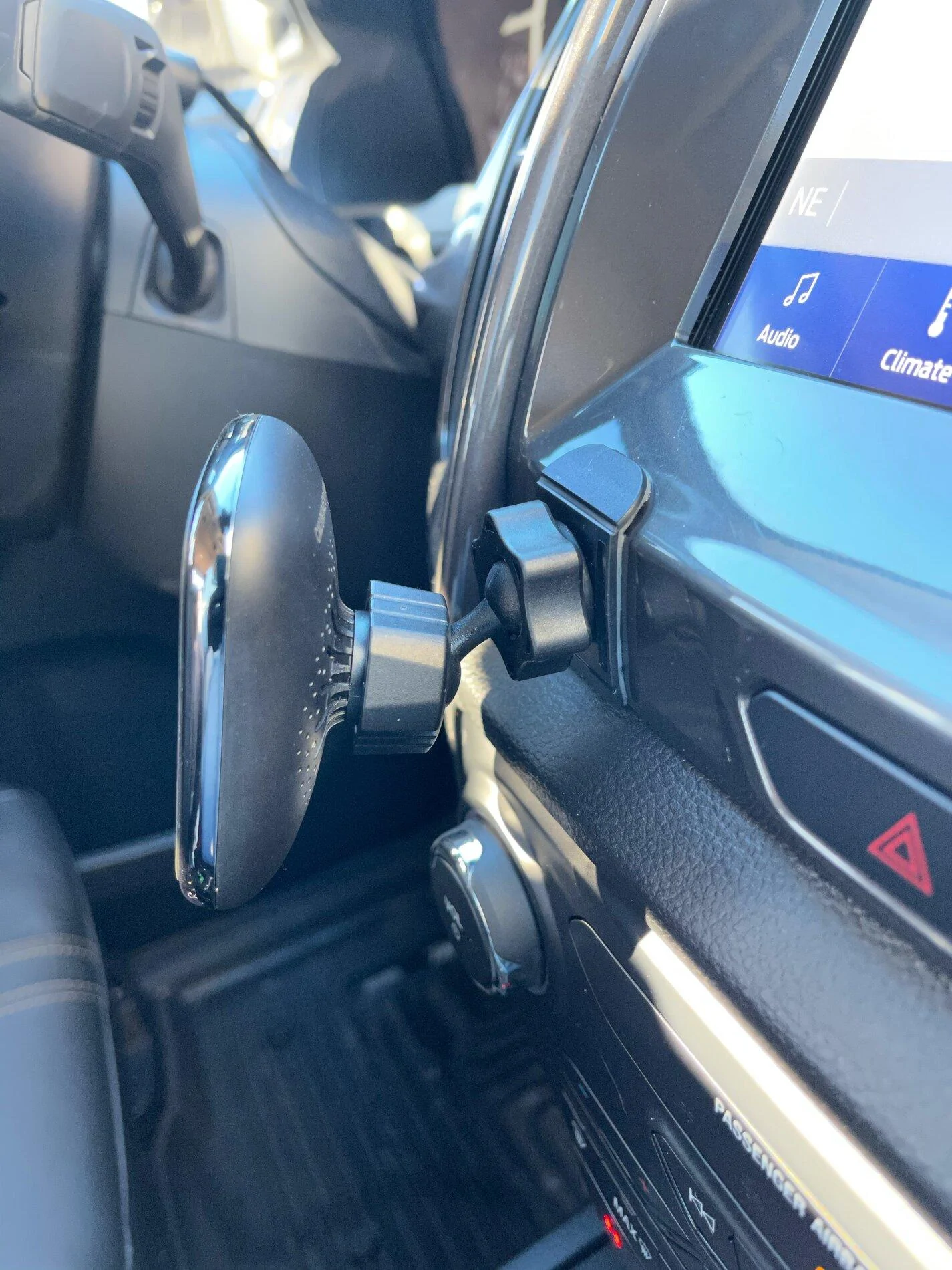

I couldn’t find anything that I really liked so I pieced one together. I didn’t want something that would cover my screen and I didn’t want something that would be in the way of the center dash tray. I found this air vent mount on Amazon (- I liked it because it moves out of the way of the vent, so the passenger can still get some airflow. Then with my iPhone 12 Pro Max I wanted something that I could just snap on with the MagSafe, so I got a MagSafe charger and added it to it. The process of creating this was fairly easy:
1) I unscrewed the magnet from the mount
2) scratched the remaining ball mount down on the ground to make it flat
3) attached the Apple MagSafe charger to the mount with 3M double sided adhesive
4) find the correct spot and install.
*I did add a little crazy glue once I found the correct angle that I wanted to the ball mount - I didn’t think it got tight enough and the weight of my phone, especially when it was in landscape view, kept turning the phone from side to side
I haven’t figured out what I’m going to do with the cables yet. Especially if the MagSafe charger is not compatible with CarPlay, then you’d need to run both cables to the phone - totally unnecessary. But it’s not that big of a deal for me at the moment. Suggestions appreciated!
Overall, I’m very happy with it so far! It’s only been installed for about a week, but definitely happy!

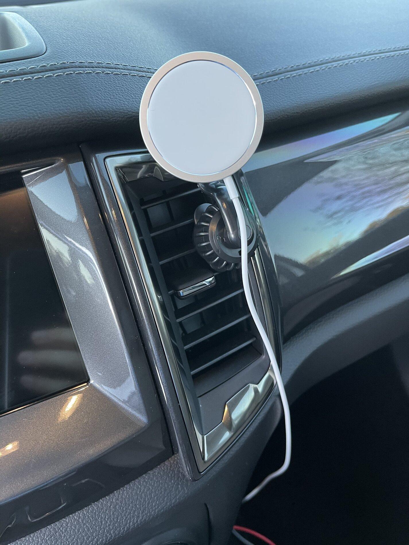

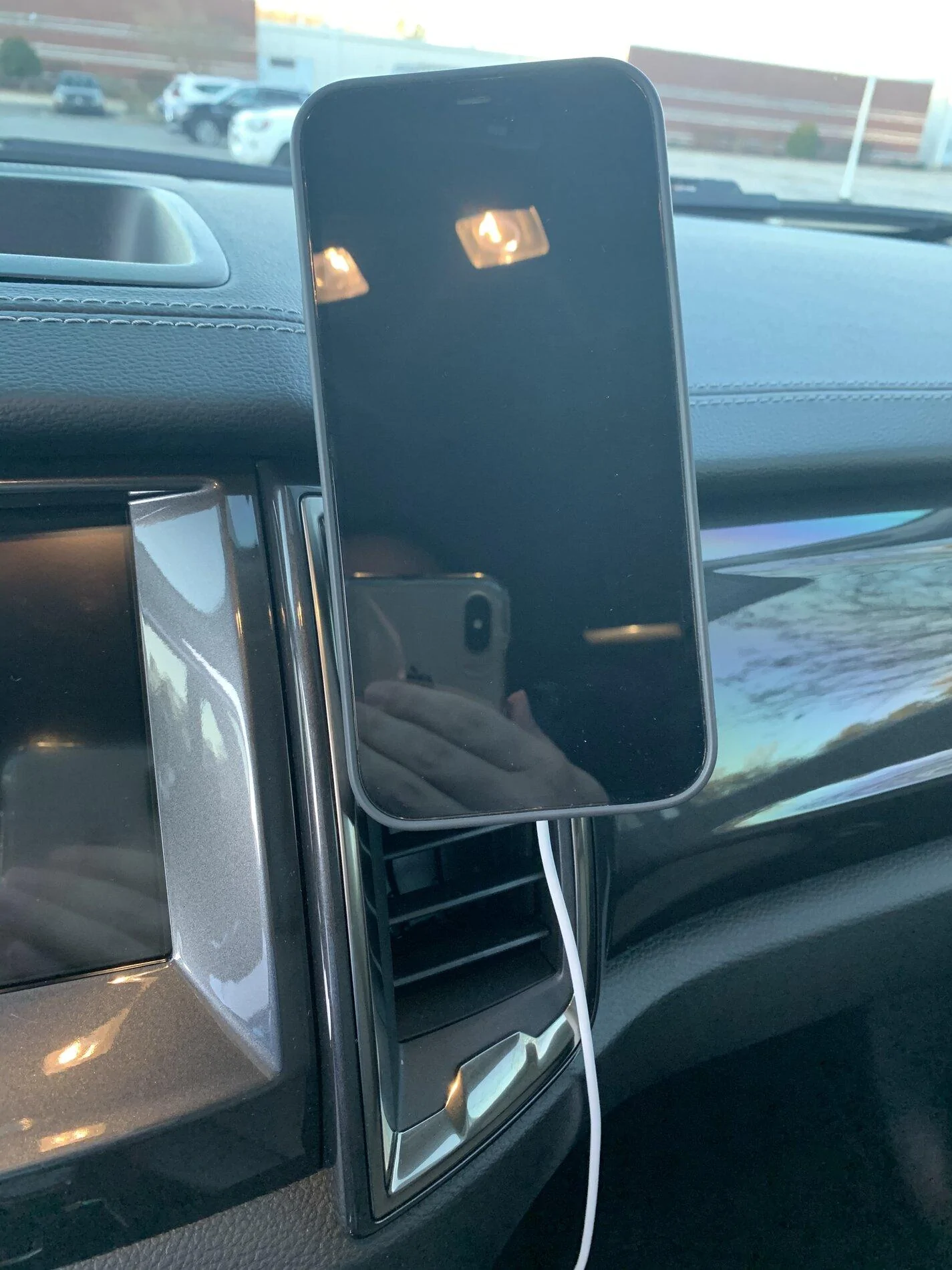

Here's my solution for other's that have an iPhone. I wanted a solution that utilized the MagSafe feature of the new generation of iPhones instead of a clamp or an elaborate arm. I bought a mount on amazon that would hold the phone as high as possible away from blocking the vent. Mount Link Here.
Then I routed the cable behind the vent and down through the dash. The cable perfectly pokes out down below next to the 12v outlet so I can plug it in to an 18w fast charging port. Yes - I still have to plug into USB when I want to use CarPlay. But I plan on getting a wireless CarPlay adapter that I can just leave plugged in down near the USB tray so I won't have any wires. It's not perfect - you can see the cable routing creates a mm or so of extra panel gap in the vent. And it does block a few slats of vent air. But the Apple MagSafe charger holds the phone perfectly, and has not fallen off under any driving conditions.

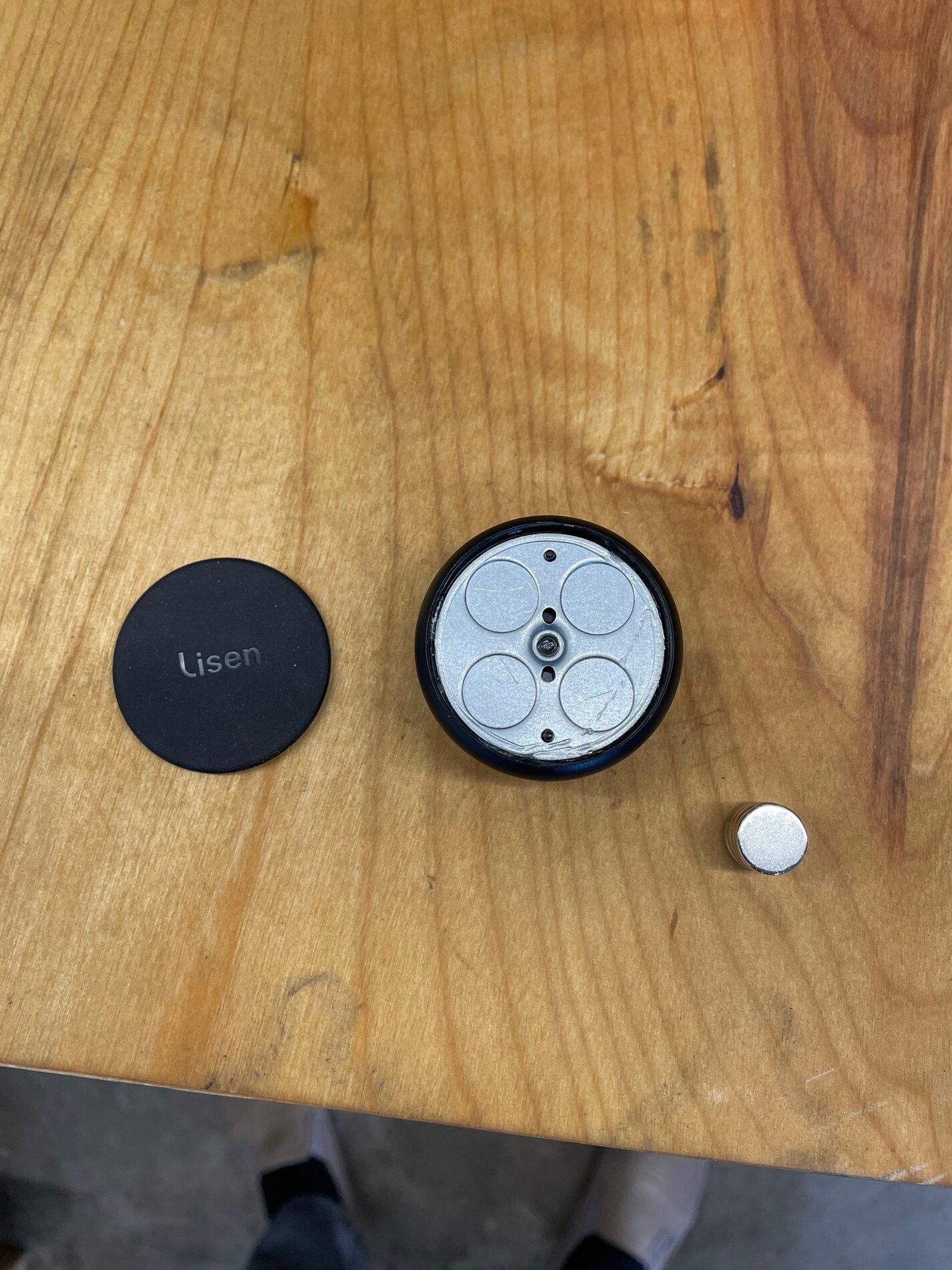

No, I don't use a case. I use an iPhone 12 case-less so that my MagSafe accessories work better. You can get cases that have the MagSafe built into them from Apple (and soon other 3rd parties too). Or you could do something like THIS inside your existing case maybe?
Also a note for anyone using the exact setup I used. The magnetic phone mounts on amazon (like the one I'm using) are meant to be mounted with a metal sticker that you stick on the outside of your phone or case. The way I was using it with the magnet attached to the back of the metal MagSafe puck was doing some weird things with the charging. I think the additional magnets were causing some electromagnetic interference or something because my charge % was dropping while mounted.
So I took apart the mount, removed the rare earth magnets, and just glued the MagSafe puck semi-permanently to the mount itself. Now the charging works perfectly, albeit without the cool factor of the puck magnetically stuck in place.

I couldn't really nail it down to a science. Sometimes the phone would randomly "PING" and I'd look up and the screen showed the fullscreen charging ring as if I had just plugged it in for the first time. The weird thing was that my phone usually showed the charging indicator as if it was successfully charging whenever I checked. But we took a road trip a few weeks back, and I would stop every few hours and check, and the phone had dropped by almost 10% every time. Almost as if the charger was draining battery even when mounted.
I figured it was something to do with interference from the magnetic mount. So I took it apart, removed the rare earth magnets from inside, and instead glued the MagSafe puck to the (now magnet-less) mount. Same effect, just a little more permanent than I had originally planned for. But now the charging works and increases quickly when mounted. So I must have solved the issue.

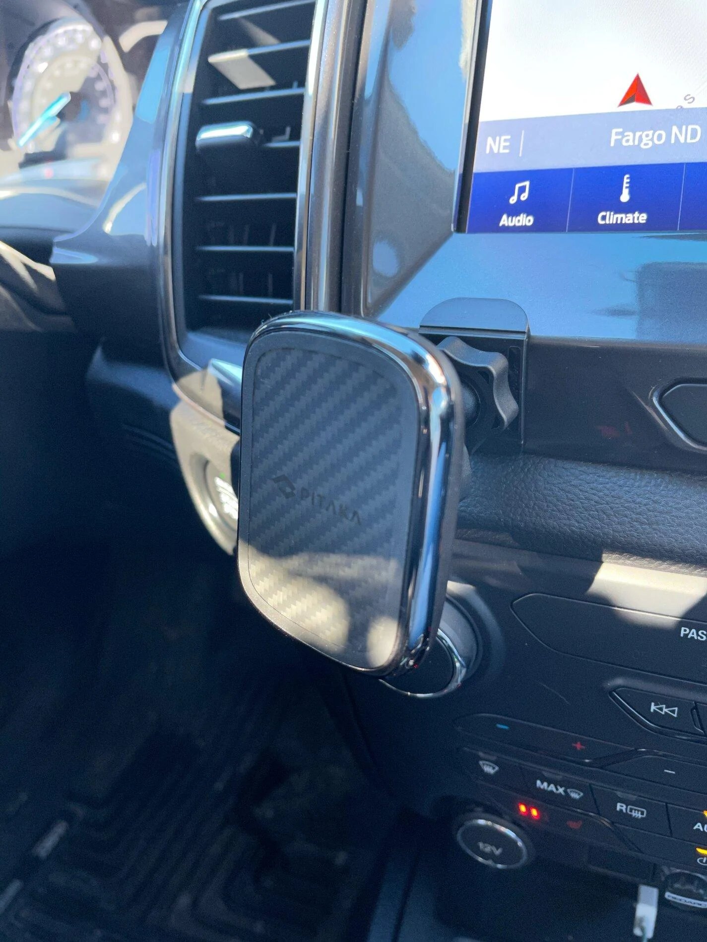

There is a company called Course Motor Sports that has a 10 minute install mount that works sweet. The vent comes off really easy and there is one bolt to unscrew then mount the mount. Good to go.
