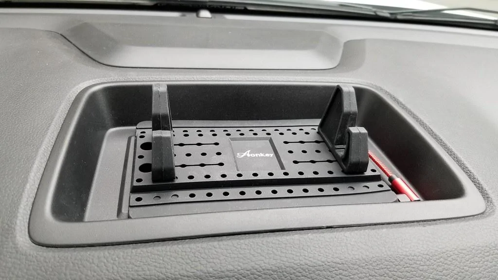

I routed the cable behind the dash so it's no longer in the way. Comes out behind the phone for easy connect.
Poke it through the hole in the factory tray and snap the tray back down. Drop the phone holder back in place and Voila!

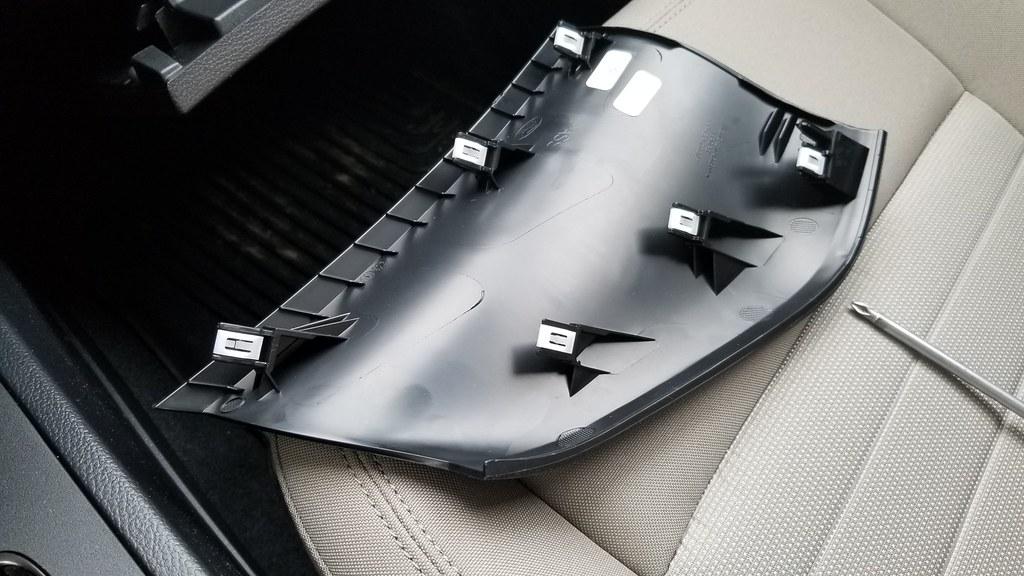

I went out and took some pics to add a bit more detail as to how I routed the cable.

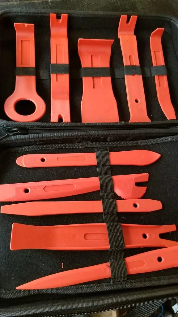

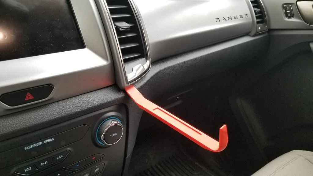

I have the handy dandy trim tool kit but you'll only need 1 of the tools. The one on the top right. If you don't have the trim tool, you can probably use a butter knife just be careful not to scratch the dash.

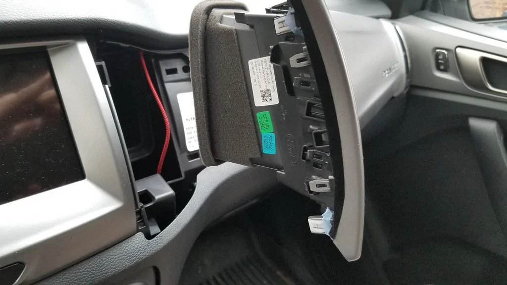

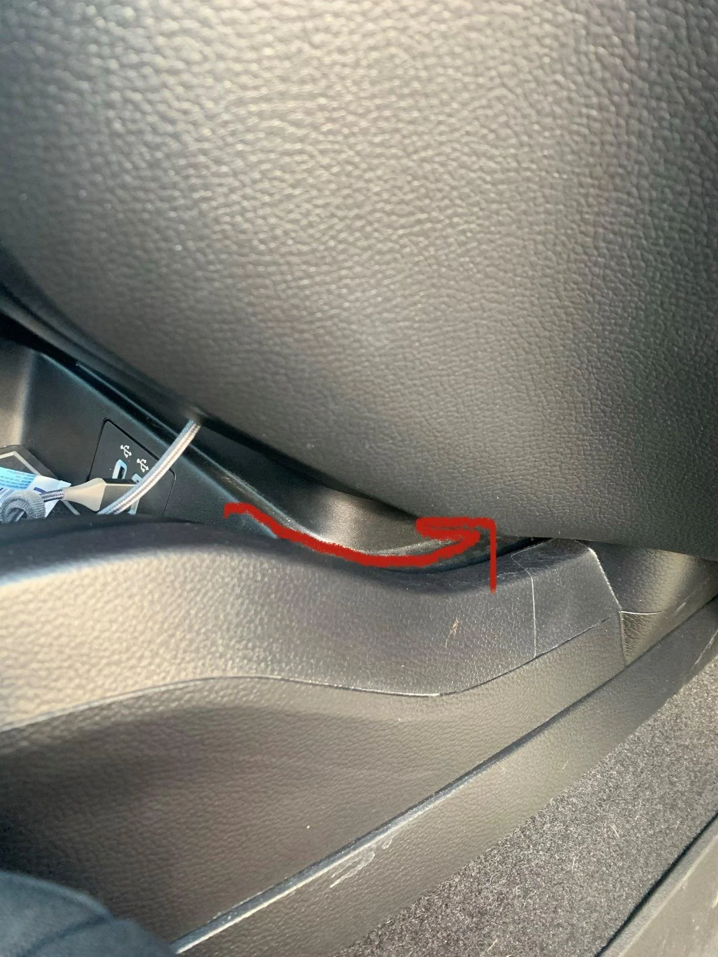

Start under the vent on the passenger side and pop the cover loose across the bottom. The top will come loose and the cover will swing out. No need to remove it completely.
You can see where my cable is routed next to the AC duct.

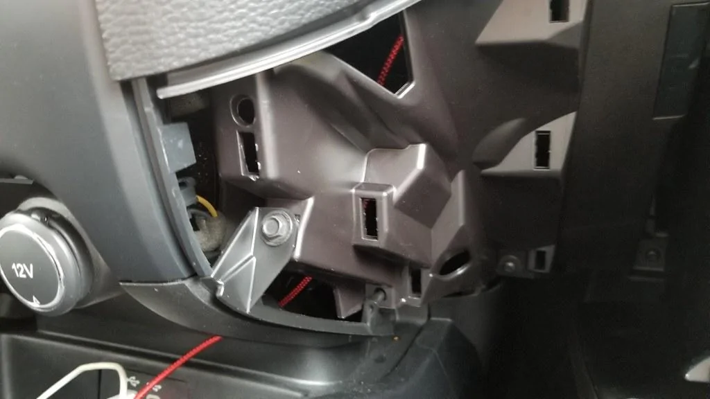

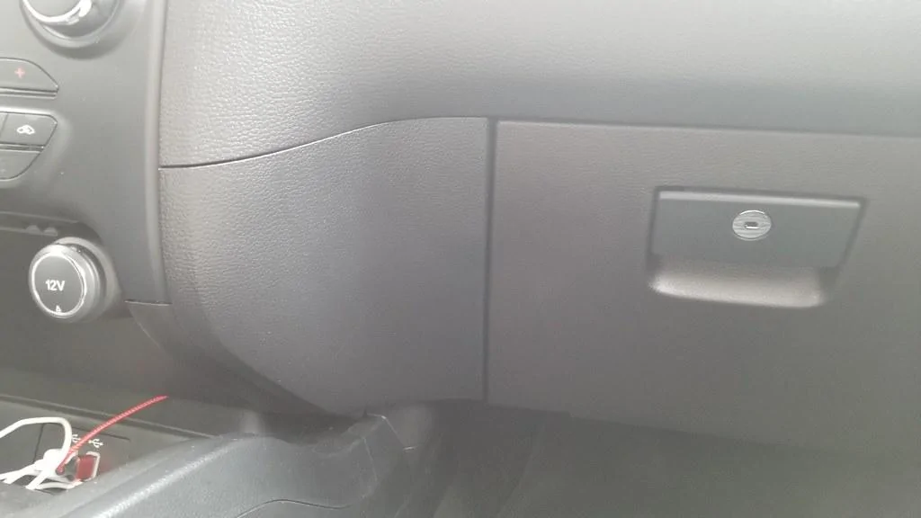

Now open the glovebox and remove the side cover. It just pulls straight out.
Now you can see how to route the cable and get your fingers in there to guide it.
Hope this helps out.

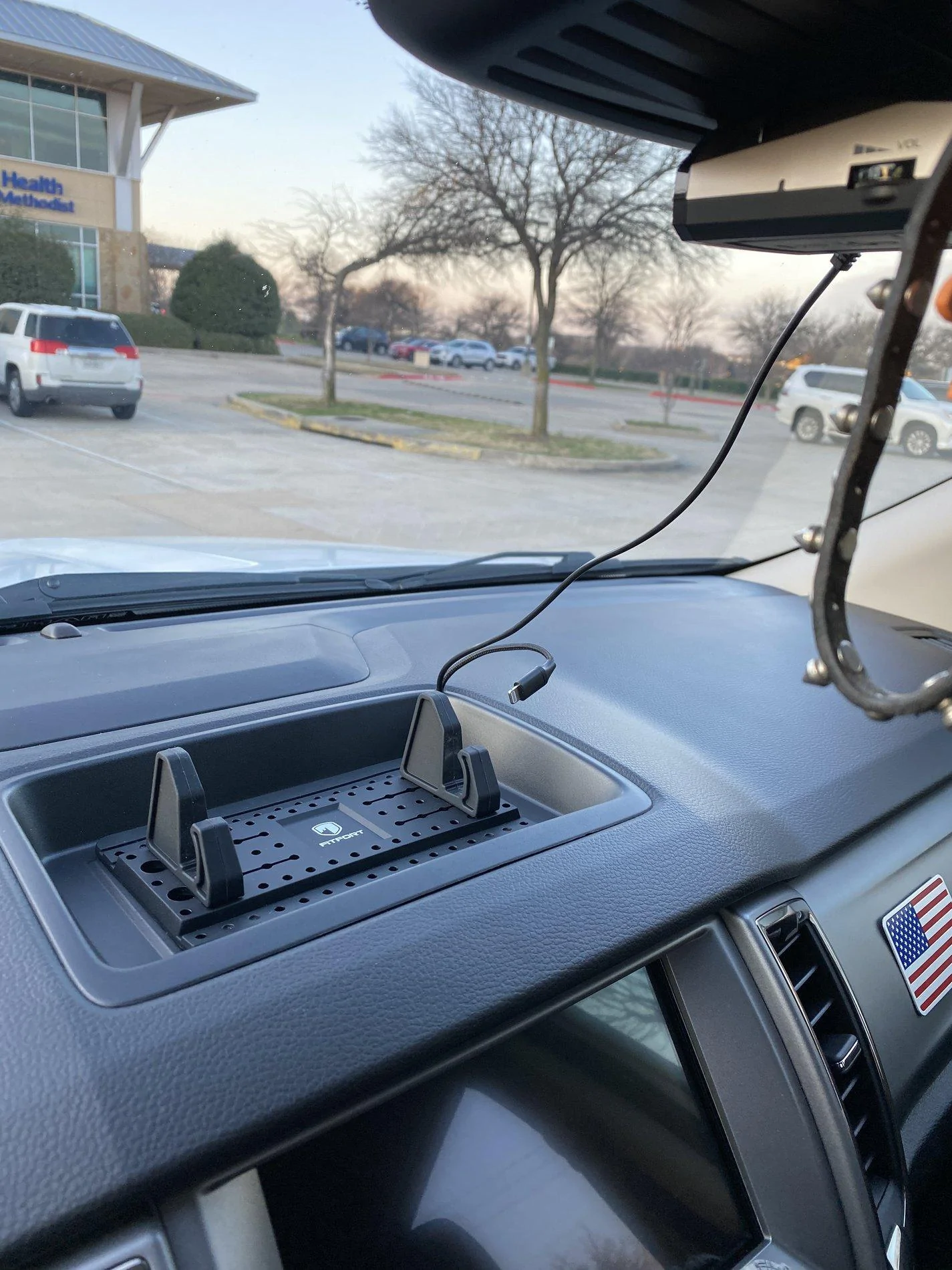

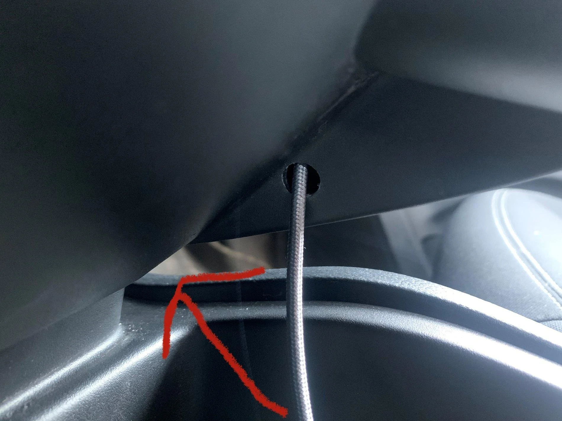

And in case anyone else is following this: I guess I also didn't realize that one needs to drill in two places to make this work. Once in the upper dashboard tray (clearly pictured above), and a second hole such that the cable can be fed into the lower dash. This one will be located just above the USB port, and will open laterally into the space behind the dashboard panel that sits at the passengers left knee. A 3/8" bit did the trick for my cable, and neither hole is all that noticeable.

Haha, I was worried you might say that. I couldn't find any way to get the cable weaseled in so I reached for the drill. I'll update tonight.
EDIT: Oops... I see it now. Could have routed it lower and behind the gap in the lower panel. Well, at least I can't see my mistake when I'm driving. Ha! :facepalm:

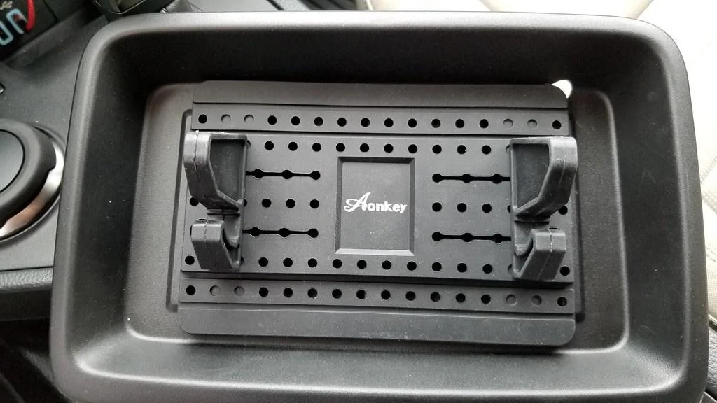

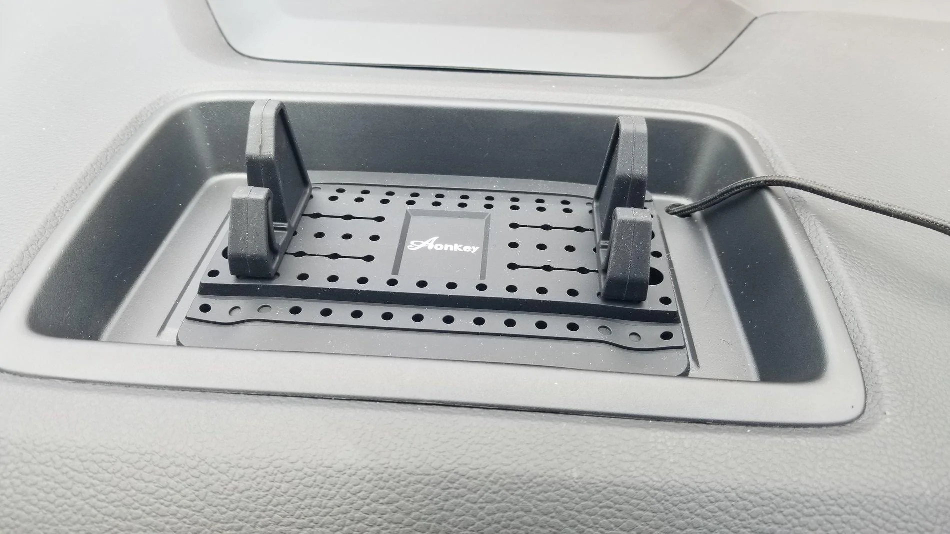

I did a bit of drilling on the factory tray and now I am happy.
The Aonkey cellphone holder works great with my S8. I was always forgetting to grab my phone when it was down in the lower bin with the USB ports, and if I put it in the tray up top the cable draped up across the dash was always nagging me.
The holder has the super sticky rubber backing discs and works well with the ribs in the dash tray. It doesn't budge at all.
The phone holders are a semi-flexible rubber and hold the phone very securely while allowing for easy insert/removal.

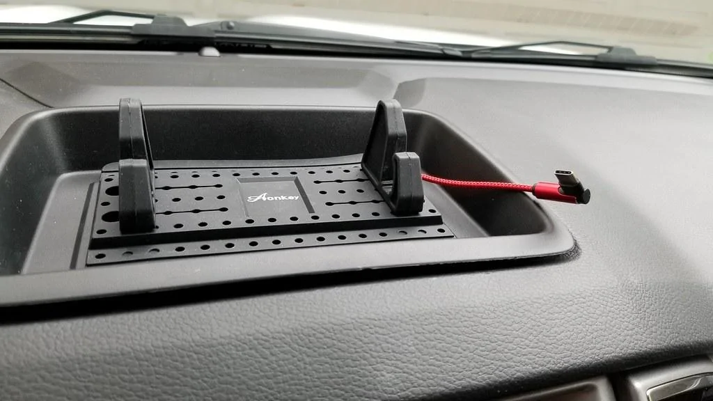

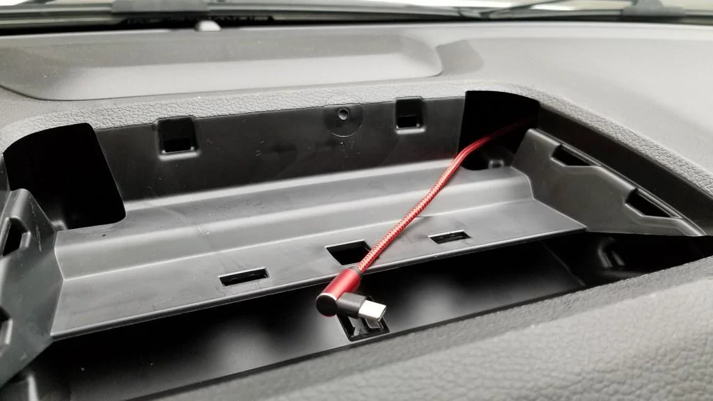

Drilled a small hole in the rear of the factory tray for the USB-C cable to come through

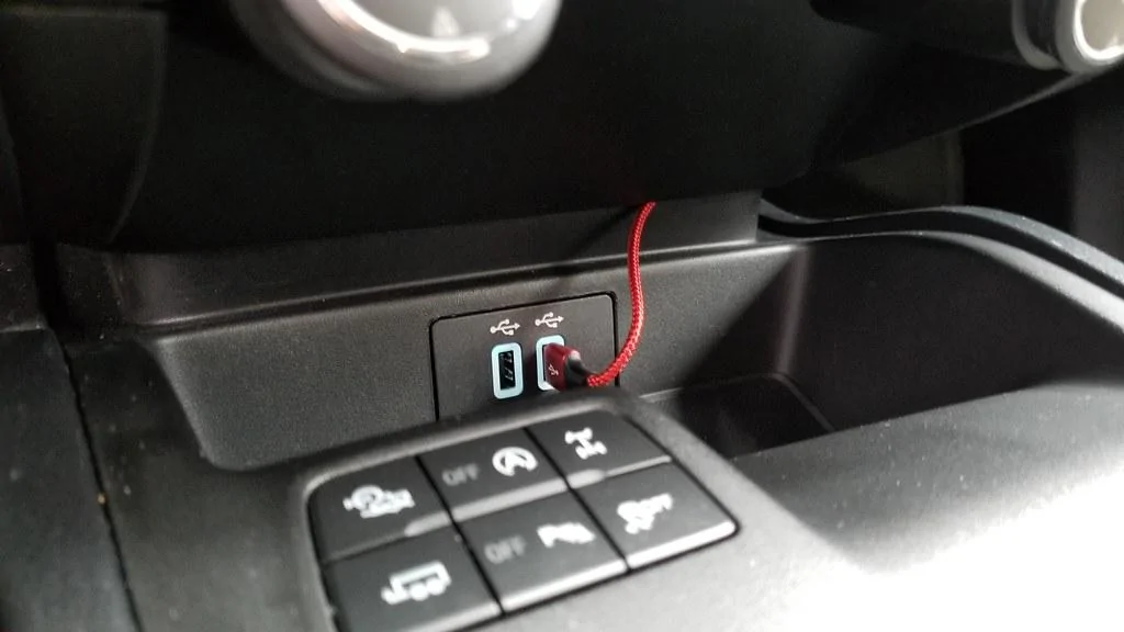

Routed the cable behind the cubby where the USB ports are located.
Now my phone is front and center so I don't forget it, easily popped in and out, always connected for Android Auto, and also perfectly positioned for running an offline GPS trail app (Locus Pro).

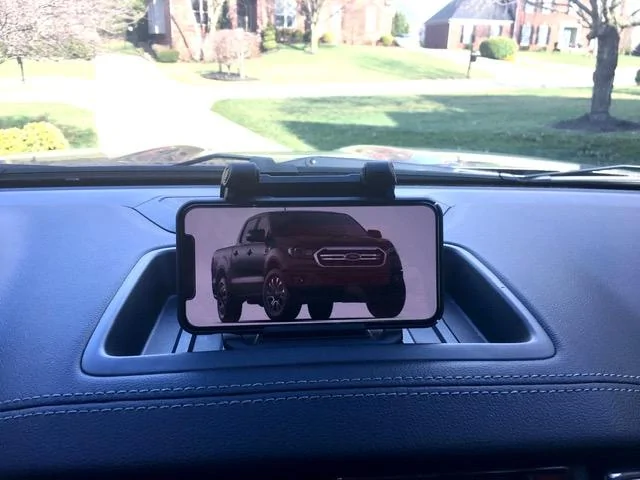

Will this phone holder work with a Lifeproof case on the phone.
I have an Iphone 7. The case makes it about twice as thick.
No clue. May want to pose the question on the Amazon page.
