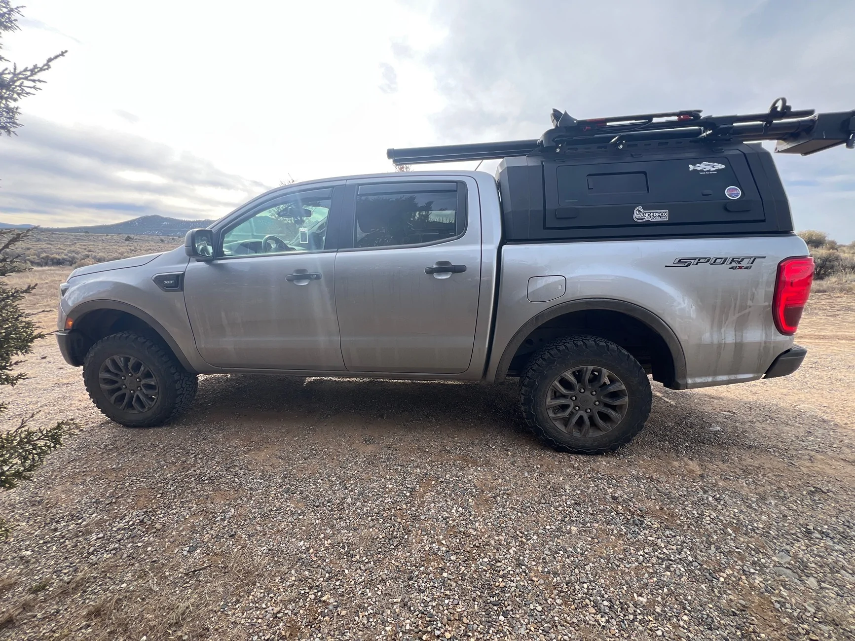

Hello! Been having shaking in my truck seats past about 60mph and not sure if anybody else has had this?
I have a 2020 Ranger super crew that I lifted with spacers in the front and out 265/65/17 ko2s on it in 2023. It's got about 70,000 miles now.
I had the tires rotated twice recently.
I'm thinking the tires still have some lift left in em.
I did do the spacer install myself in 2023 but didn't have any issues. I'm wondering if anything came loose in the suspension or it's a worn out cv?
any thoughts are appreciated!
