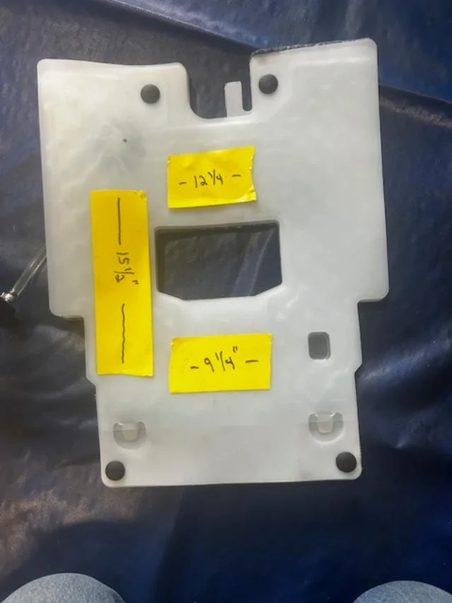

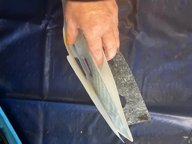

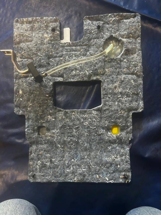

Pulled the Driver's Seat out today and installed the Occupant Sensor Mat on the Driver's seat.
I was correct it is 1/2 Inch thick as a complete assembly.
A noted difference with just a driveway check, will drive a monitor and if needed add more 1/2 inch
HD Foam
Before I installed, I cut a piece of the HD foam to fit.
I ended up removing the Occupant Sensor mat, it is just a oil based liquid inside a vacuum sealed mat and then as you sit on the seat the fluid moves to the tube/pressure sensor
(sensing seat occupancy)

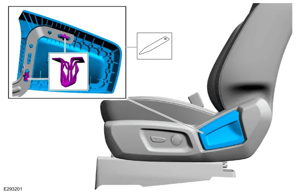

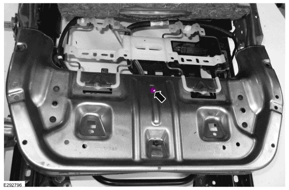

It is fairly easy to get the cushion raised to access the bottom of the cushion.
Except for the OB back clip, the Recline Lever has to come off to get the OB Trime Piece off.
OB Side = Side closest to the door (control switch / lever side)
I attempted to get the Recline Lever off, but it was a hassle without possible breakage of the locking tab, so I worked around it.
It will come off, but I decided that since I could work around it, it was best to leave it alone.
Recline Lever - Locking Clip

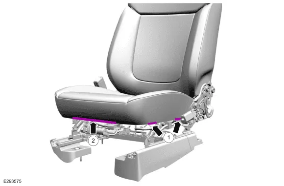

Here is the Location of the J-Cover Clips - To get the cushion raised.
Note: Item (1) is duplicated on the I/B Side (Not Pictured)
You can access the Front and Both I/B Side Clips and the front O/B Side Clip without pulling any covers.
Just press downward on the cushion and get your fingers on top of the clip and pull out and downward on it - It will release.

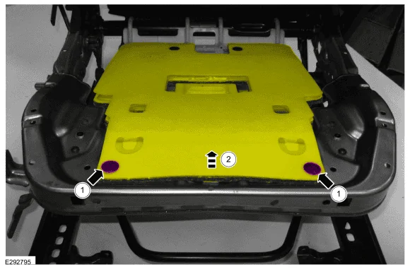

Once you get the cushion raised - you will see this
I added this - Occupant Sensor - To be an exact match to the passenger seat.
However, any HD Foam Padding will work.
Recommend 1/2 Inch Thick - but play with the thickness as you desire.
This is the 1/2 Inch - HD Foam I bought as a backup plan and have a piece cut to fit if needed.
To add or adjust what I just installed.

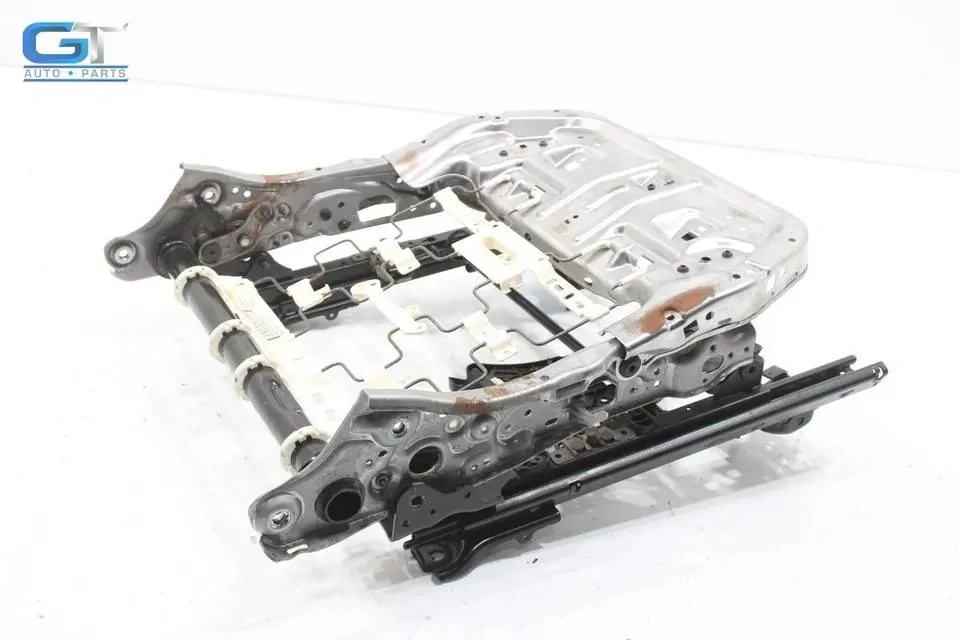

I thought about trying to see if the seat springs could be adjusted or tightened, but without pulling it further apart on the back side (as this would be the only way to adjust) - if possible
Rotate the C-Clip Style mounting points to the frame. (Rotate Upwards - To put more tension on the support springs)
Will venture into that (If the addition of padding is a bust)

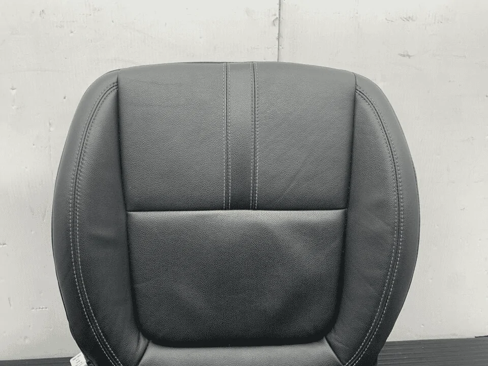

Doing this project shows why some owners have warrantied their seat cushion for creases in the cushion.
In this example pic, you can clearly see by the (BUT) indention. that this is what I and others feel as the sinking feeling. This part of the cushion is thinner than the rest of the cushion and over time it transfers itself to the cover (shaping and stretching it) for visual wear as the cover is being stretched as you sit in the seat.
So even if you have this issue (Creased Cover) if the dealer replaces the cushion, this issue will return unless they have revised the cushion itself.
Replacing the seat itself - same issue
The seat and or cushion needs redesigned to eliminate the issue.
so, until then we have to find alternatives for a fix.
