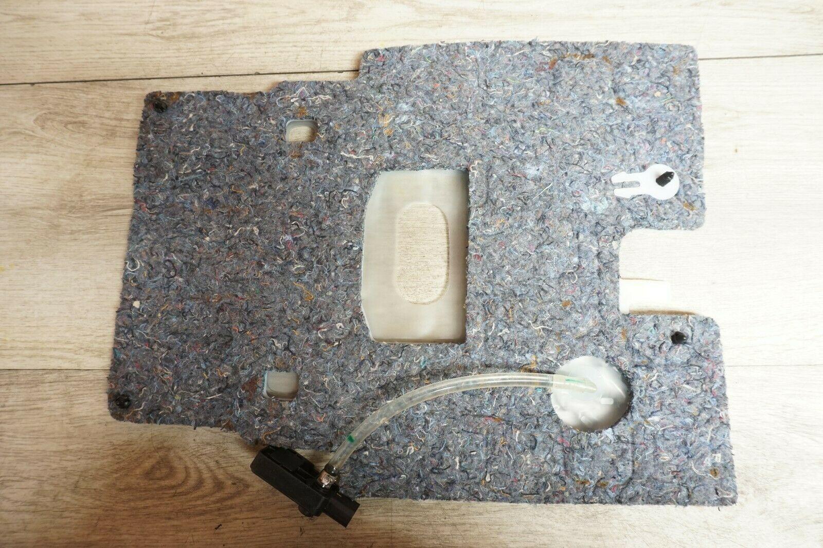

Called the "Occupant Weight Sensor" but haven't found apart No, but it shows it in this diagram
https://parts.ford.com/shop/en/us/body/soft-trim/seat-back-pad-12970703-1
I don't need the whole sensor, I just want to replicate the fabric that's on the underside of it.

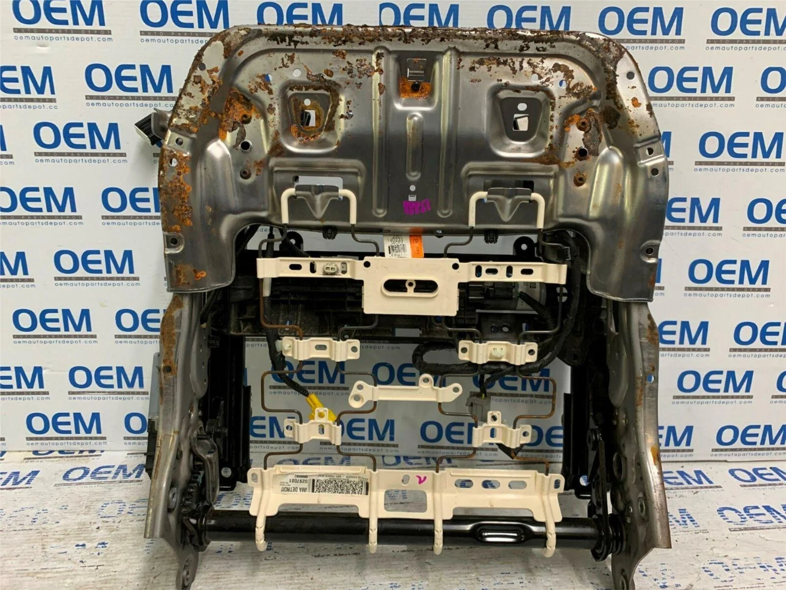

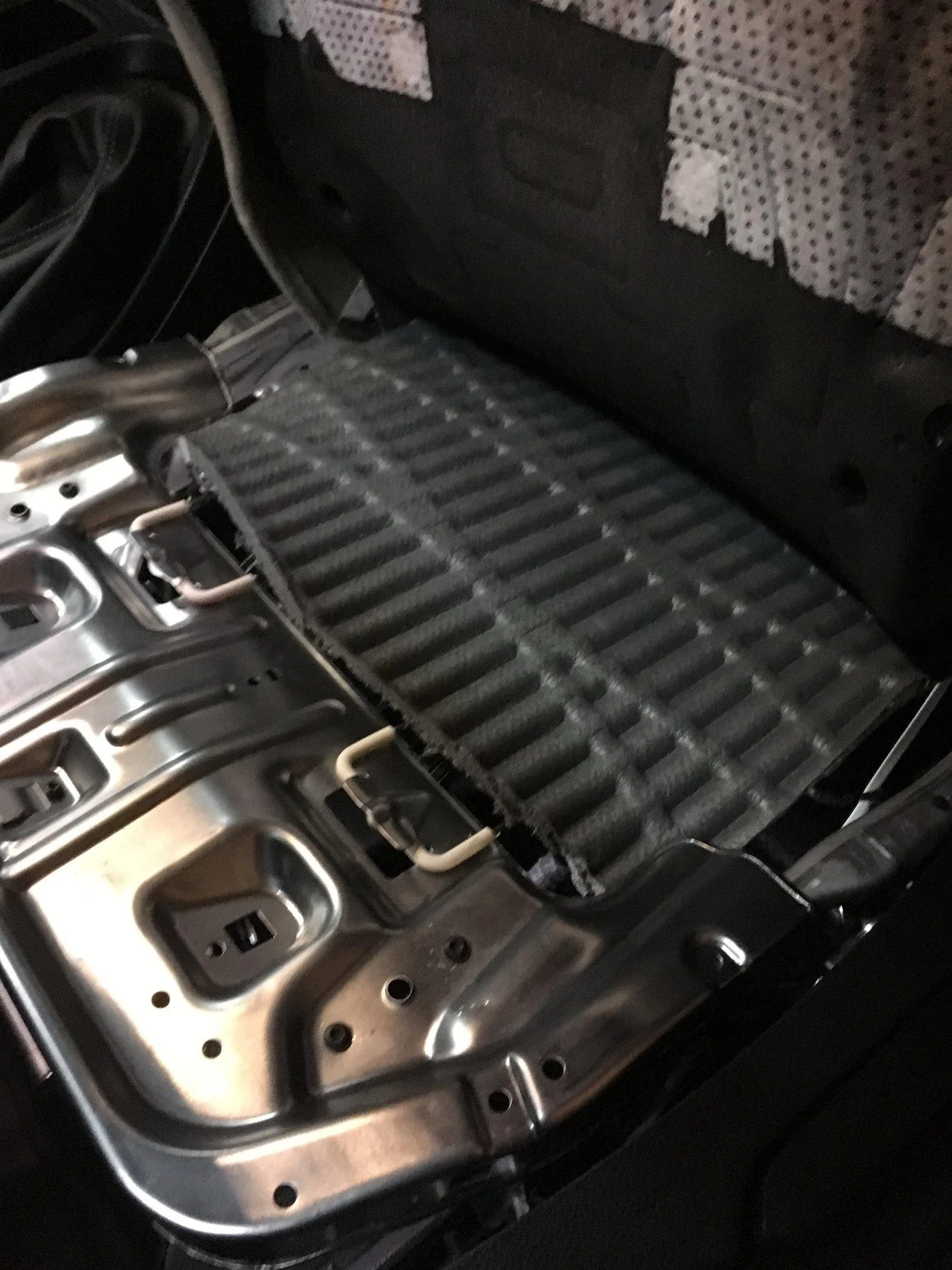

Ok. I have mostly fixed the issue. Took some digging around but if you look under both the driver and passenger seats you will notice a stark difference. I found this out after sitting in the driver side, then moving to the passenger to clean the windshield. This was the first time I had sat in the passenger seat and noticed the seat felt noticeably firmer. The passenger seat has additional equipment installed to account for the airbag sensor that uses a pressure/capillary tube to determine the passenger weight. This adds a diaphragm between the cushion and the suspension spring.
So, I looked at the driver's side and discovered there is nothing between the foam and the springs which allows the cushion to deflect more (aka sink more).
Without removing the seat I was able to detach the front part of the seat cover from the frame without any tools by pushing up an pulling inboard on the plastic retainers at the same time.
I cut a piece of 1/2 high density foam (from a camping bed roll) to fit the seat tray to cover only the springs and re-installed the cover. Getting the cover back on took a little patience but start - finish only took about 30 min.
The seating position is much better and the lumbar is where it is supposed to be. Two days, and much happier!
It is easily reversible if you don't like it or want to experiment with different thicknesses of padding or material. I almost used a section of jute padding which may be a better material if this turns out to be too firm.
Honestly, I think this may be an oversight from the factory by not having anything, not even a anti-chaffing material between the soft foam and the springs. In my experience the factory seats typically have a HD cloth material (burlap in 60's cars) to isolate the spring from the foam. I would bet there are others who will have issues with sagging seats after a very short time.

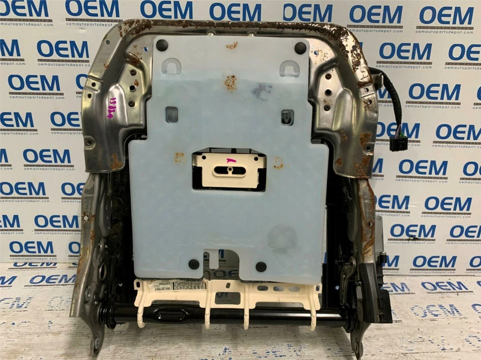

As posted above the Driver's seat and Passenger seat differ, with that Occupant Sensor and the padding that goes with it. (Driver's seat does not have it)
I have only driven my truck, so I have never sat in the Passenger Seat for any length of time, only cleaning the dash / windows etc. and testing for comfort differences.
Not a measurable testing method but if you open the door and take your left hand and push downwards on the (But) part of the seat and then take your right hand and feel under the bottom of the cushion you can feel the flexing downwards motion of the cushion (The Sinking)
you will also notice you are feeling the foam on the bottom of the cushion.
Repeat that procedure on the Passenger Seat, you will note, LESS flexing and also feel the padding from the Occupant Sensor.
I found a used Occupant Sensor on Ebay for the Passenger Seat, purchased and await delivery.
Pricey for just a pad as I cannot use the electric portion and have zero need for it.
I also purchased a camping bed (1/2-inch HD Foam) as a backup solution and will cut to fit if needed.
From just swapping from the Driver's to the Passenger Seat and sitting in it for 10 minutes or so and simulating leg movements as if I was driving, I note a HUGE difference in comfort.
So that was my decision maker and that was to get the Driver's seat as an exact match to the Passenger Seat. (Purchase the Occupant Sensor)
Try that First and then open it back up and add or alter the padding with the HD Foam

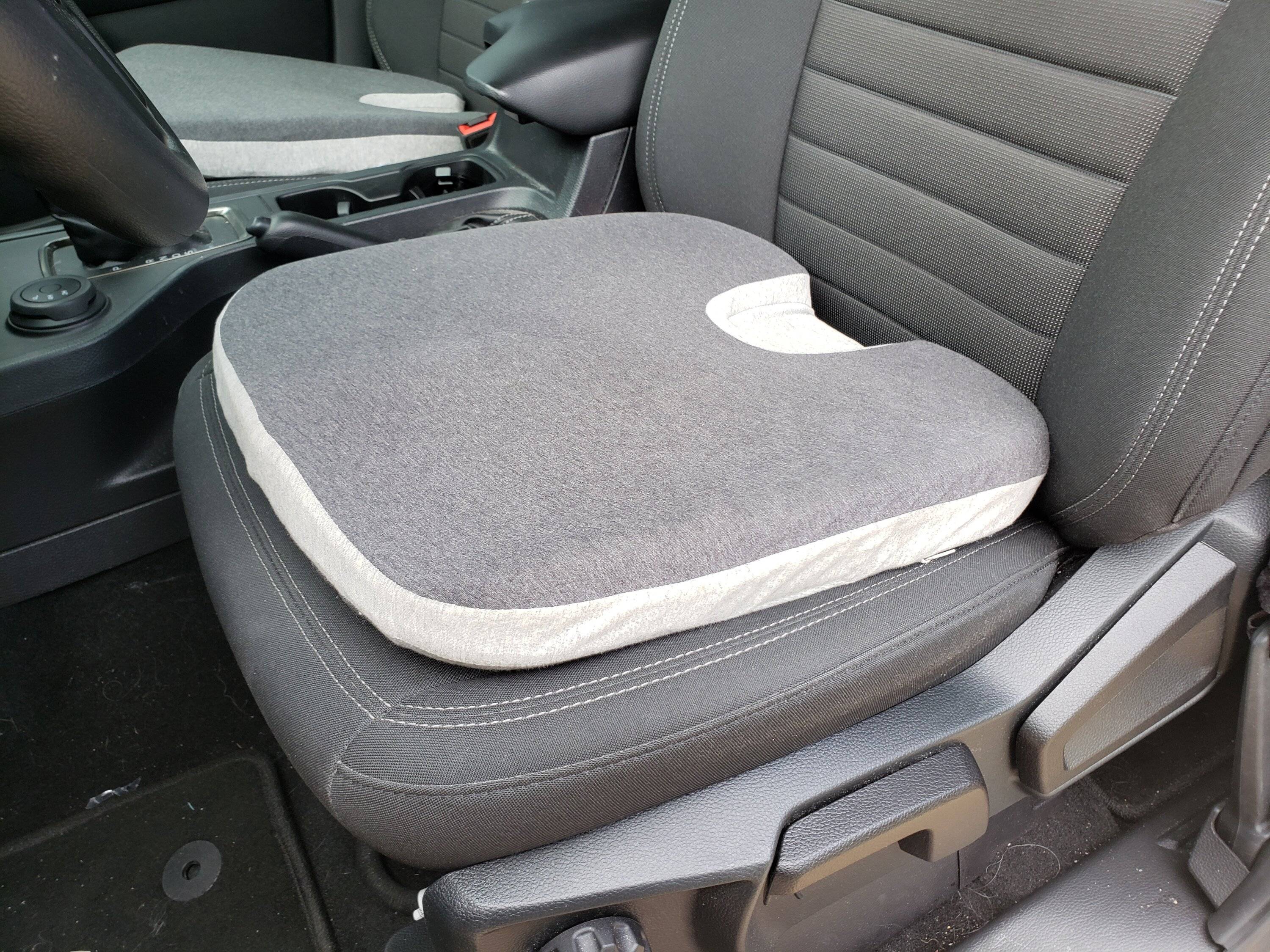

My seats are hard and uncomfortable. I had to get some quality seat cushions to solve the problem...
