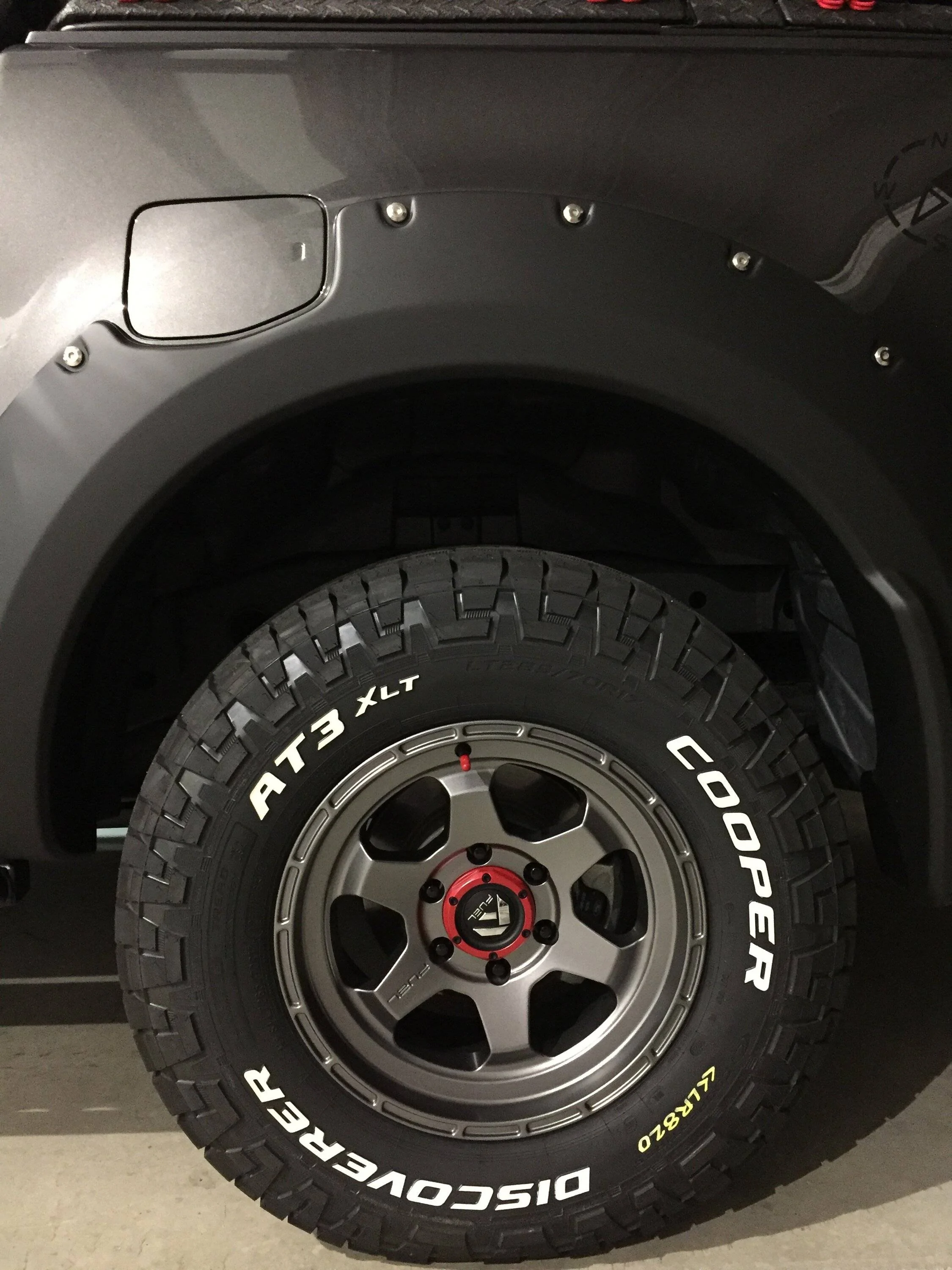

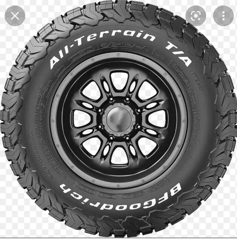

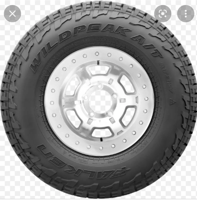

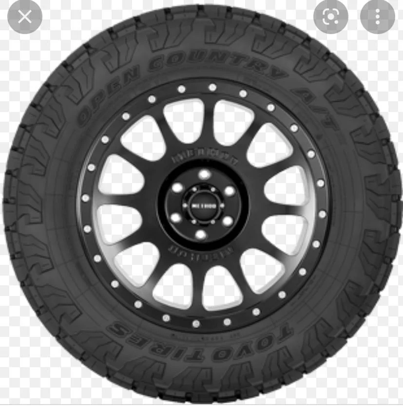

Maybe the look you want has more to do with the tire design. You had a great off-road/all terrain tire on your last truck. That tire also had an aggressive sidewall. Questionable how much function that adds, but it looks nice. I attached a couple of the common tires that have a similar side profile and are available in the size you already have. The KO2 seem to have the most aggressive look, then the Toyo, and so on…. The more aggressive the look and the tread, the louder the tire tends to be - so prepare for that as well. You are also going to need to choose if you want white lettering (showing) or not. This depends on the tire and the vehicle, and YOUR preference. For me, I am split 50/50. Maintaining white lettering is more work, so I opt for the black side out look.

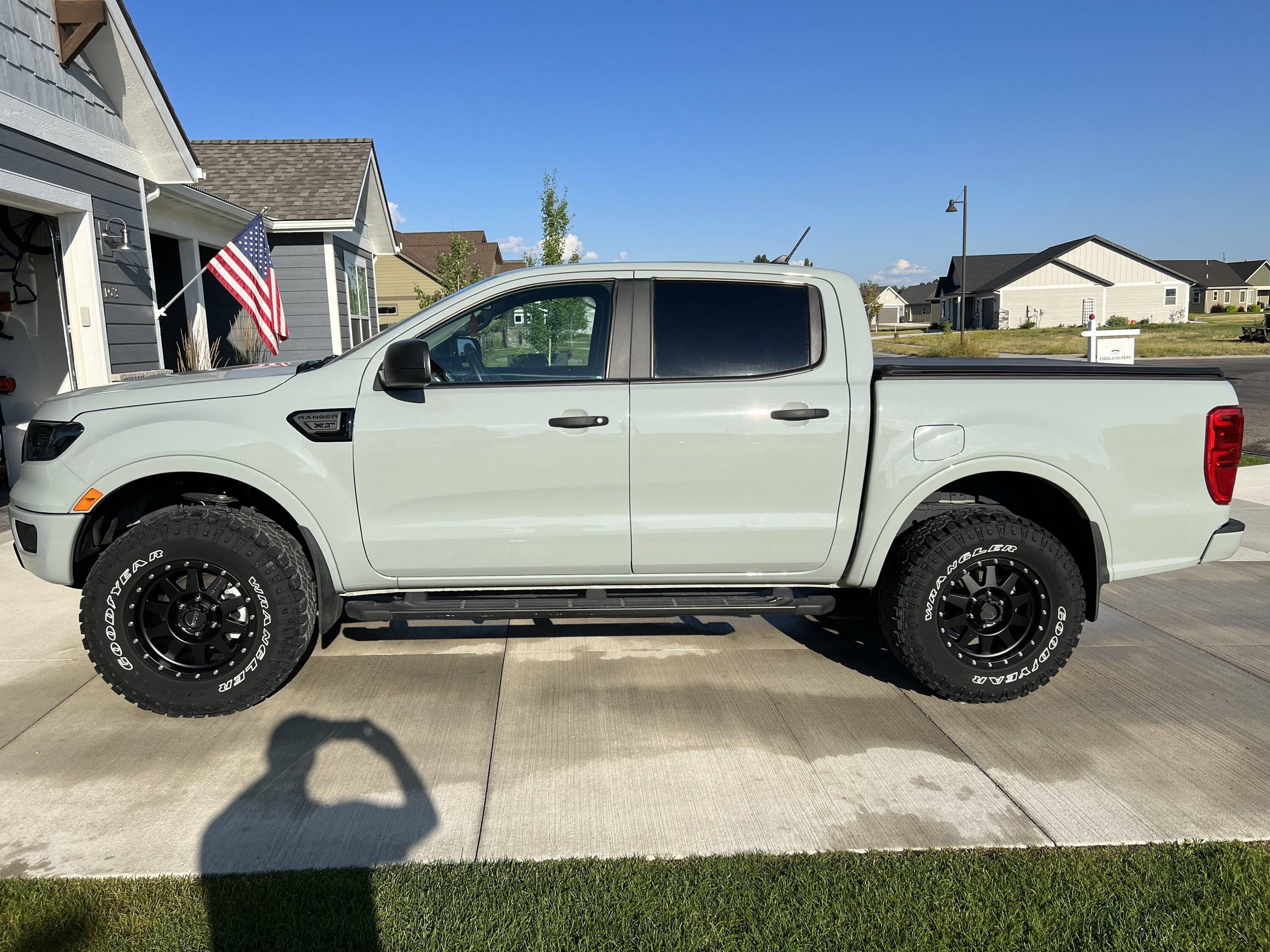

285/70’s just look right on these trucks. I’m on Fox 2.0 kit with the front coils backed off to give me around 1.75” lift up front. Duratrac’s are my go to tire, they are awesome in the winter and handle fire roads and highway just as well

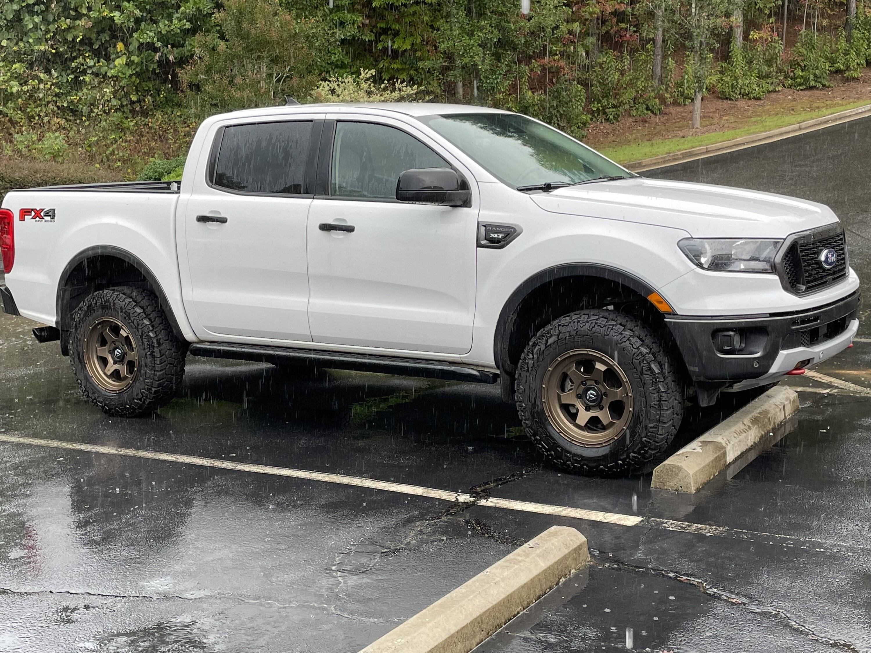

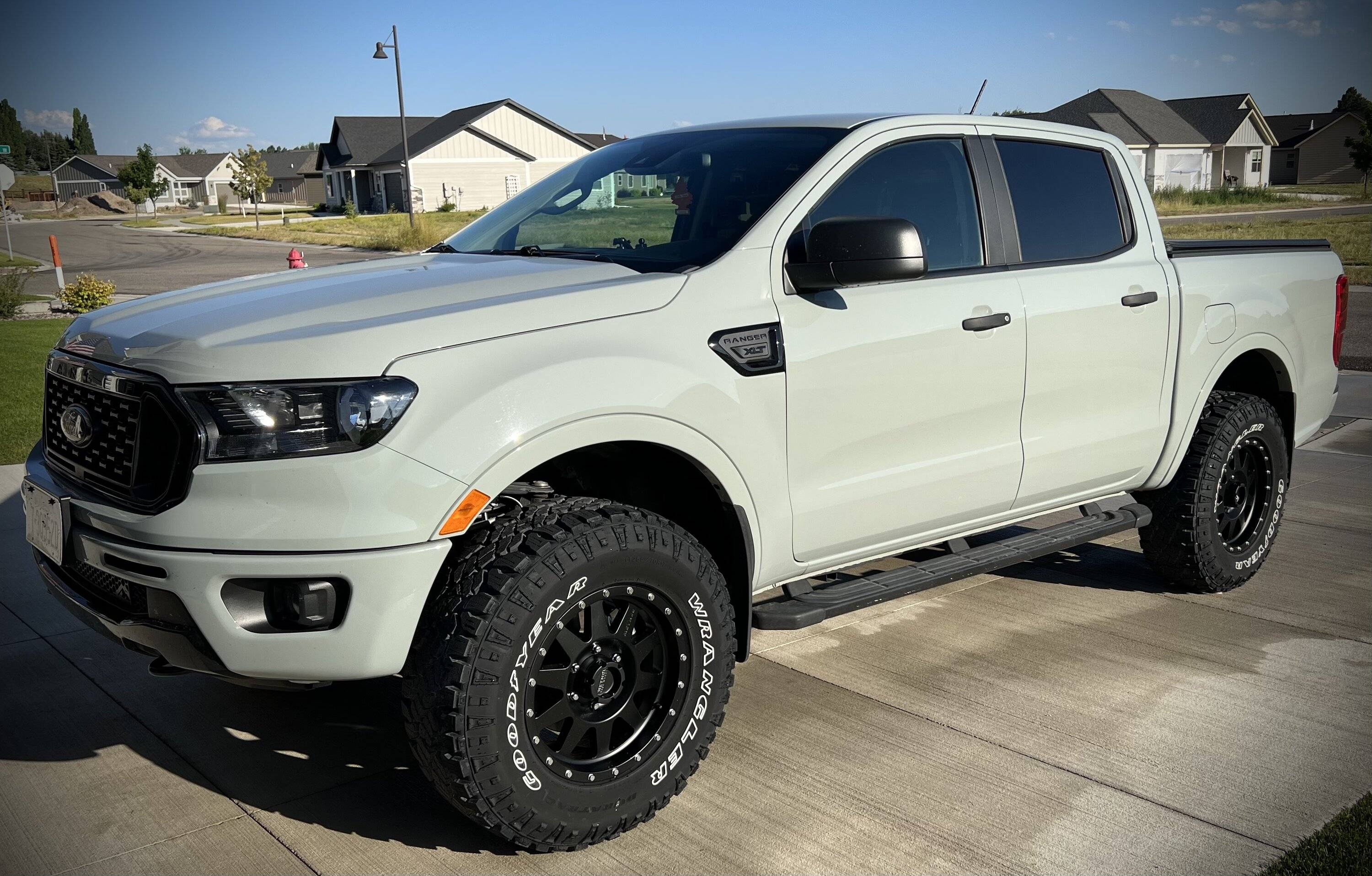

Here is 265/70/17 on 17x9 tires. Raining today so you'll have to look through the raindrops to see it.
Mine is slightly lifted (Bilsteins in front at 1.8", Tremor leafs in the rear) but a lift is not necessary to run this size.
IMO, the 265/70 looks "Just Right" on a stock or mild truck.
With that said, when these wear out I'll likely install the modified intrusion beams and go with 285/70.
^^^^^This, right here……all day long. After you level it and continue to use your OEM rims with their +55mm offset, you’ll be able to get this great look without having to modify anything and your speedometer won’t be WAY off.
”Bigger” has its limits. This is a very popular tire size for a levelled Ranger because it looks so great.

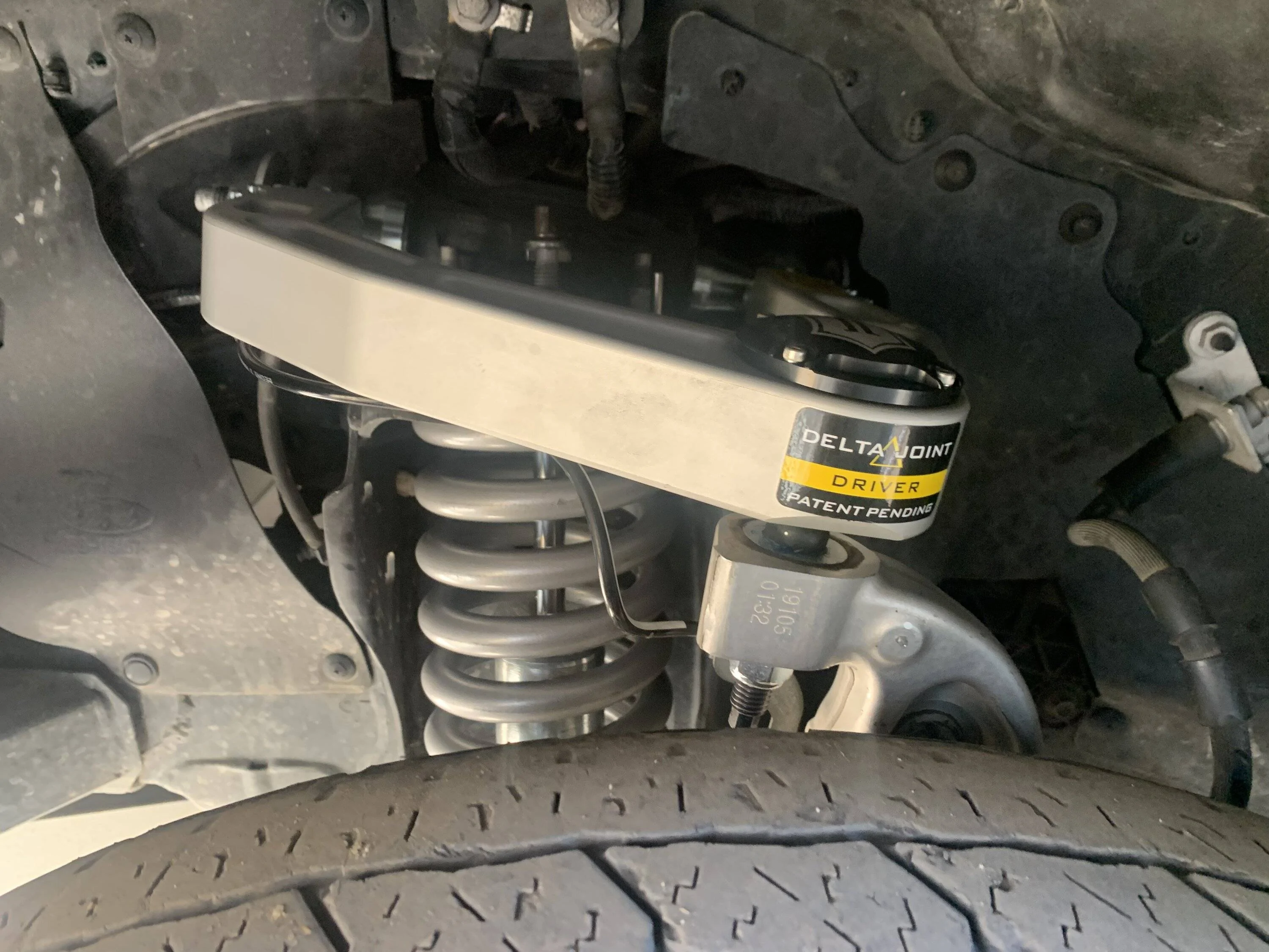

Just leveled my truck this weekend going to run 285/70/17 w/ko2 and icon wheels. Leveled with Bilstein 5100 w/Eibach spring and icon upper control arms.
How did those affect your MPG and MPH reading?
80
6,851
41,852
Living The Dream
I didn't notice much of a hit on MPG, but then my driving habits suck for MPG anyway.
As far as speedometer, at 70mph indicated on the dash the GPS shows around 72 true mph.

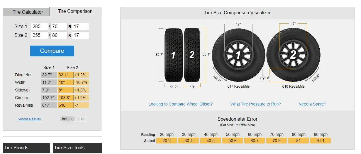

Popular tire sizes seem to be 255/80/17 and 285/70/17.
  • 285 would be roughly 1" wider than 255.
  • 255 would be roughly 0.5" taller than 285.
Looking at a TOYO ATIII as a comparable:
  1. 255/80 runs about $290 and weighs 53lbs. This size is only available in load range E1.
    • Listed height is 33.07"
  2. 285/70 runs $317 in load range C1 and weighs 56lbs.
    • Listed height is 32.76"
    • Personally, I would run a C1 load range in this size and not E1
