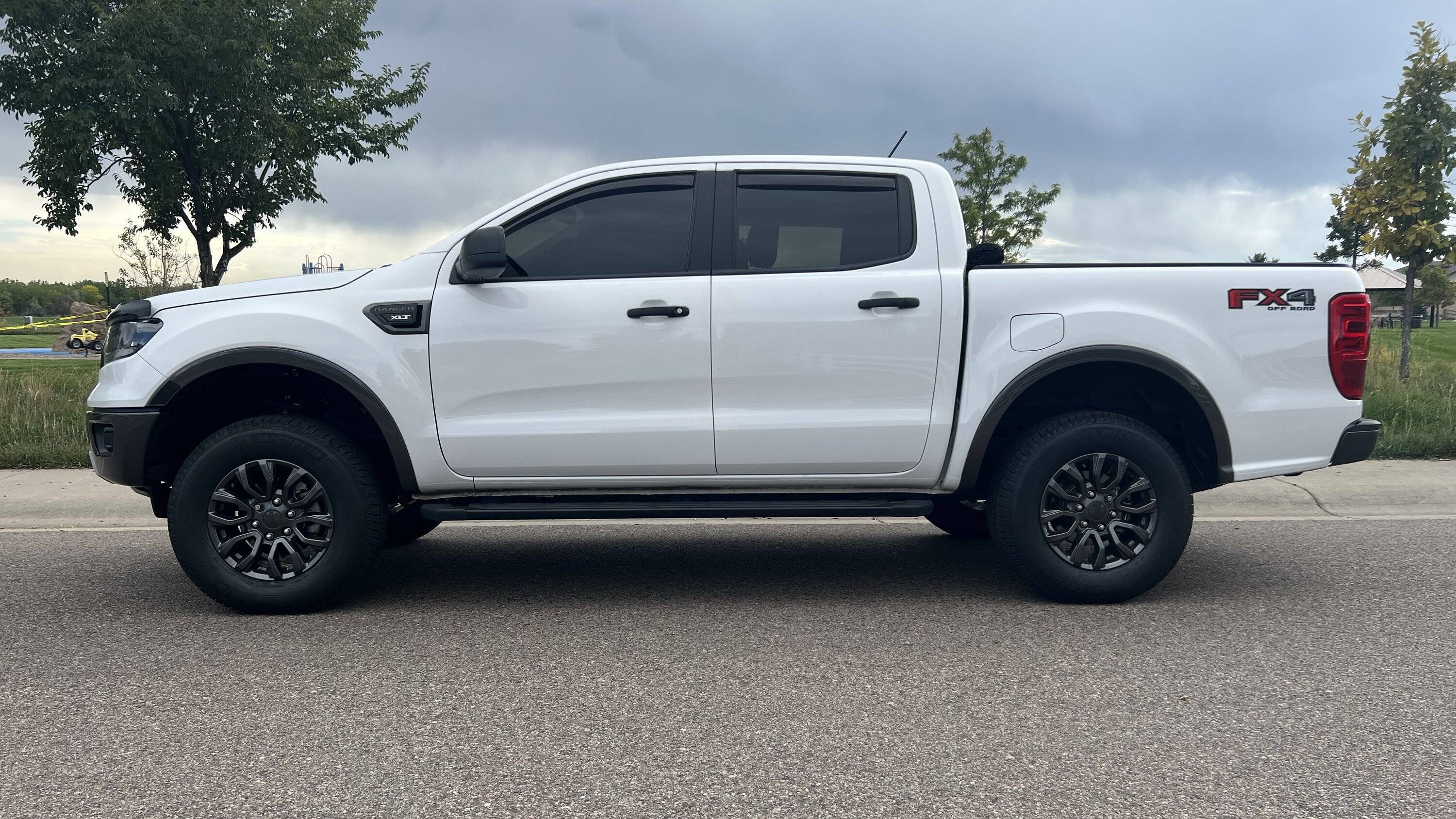

i know this is from a while back but you mentioned running the 285 70 17 in a ko2 stock with minimal rubbing. i have questions lol. the 265 70 17 looks so snug to me any chance you have a picture of the 285 70 17 on your ranger? did you have the stock wheels and offset? every time i look under my truck i feel like i am so close to the steering parts and sidewall of the front tires lol. I want to go to something in a 33 inch tire but not really wider. i was thinking something like a 255 80 17 but they are not cheap or easy to find in stock. any suggestions? thanks

The 285/70r17 BFG AT KO2s were about 1/8" away from the spindle. I don't have any pictures, but they fit. I rubbed on the crash bars in the front, only in reverse and only at full lock of the steering wheel. The top of the tire never gets closer than that, because there is no deflection of that part of the tire. 255/80r17 were a great tire for me. I went up even further though, to a 285/75r17 (34").
