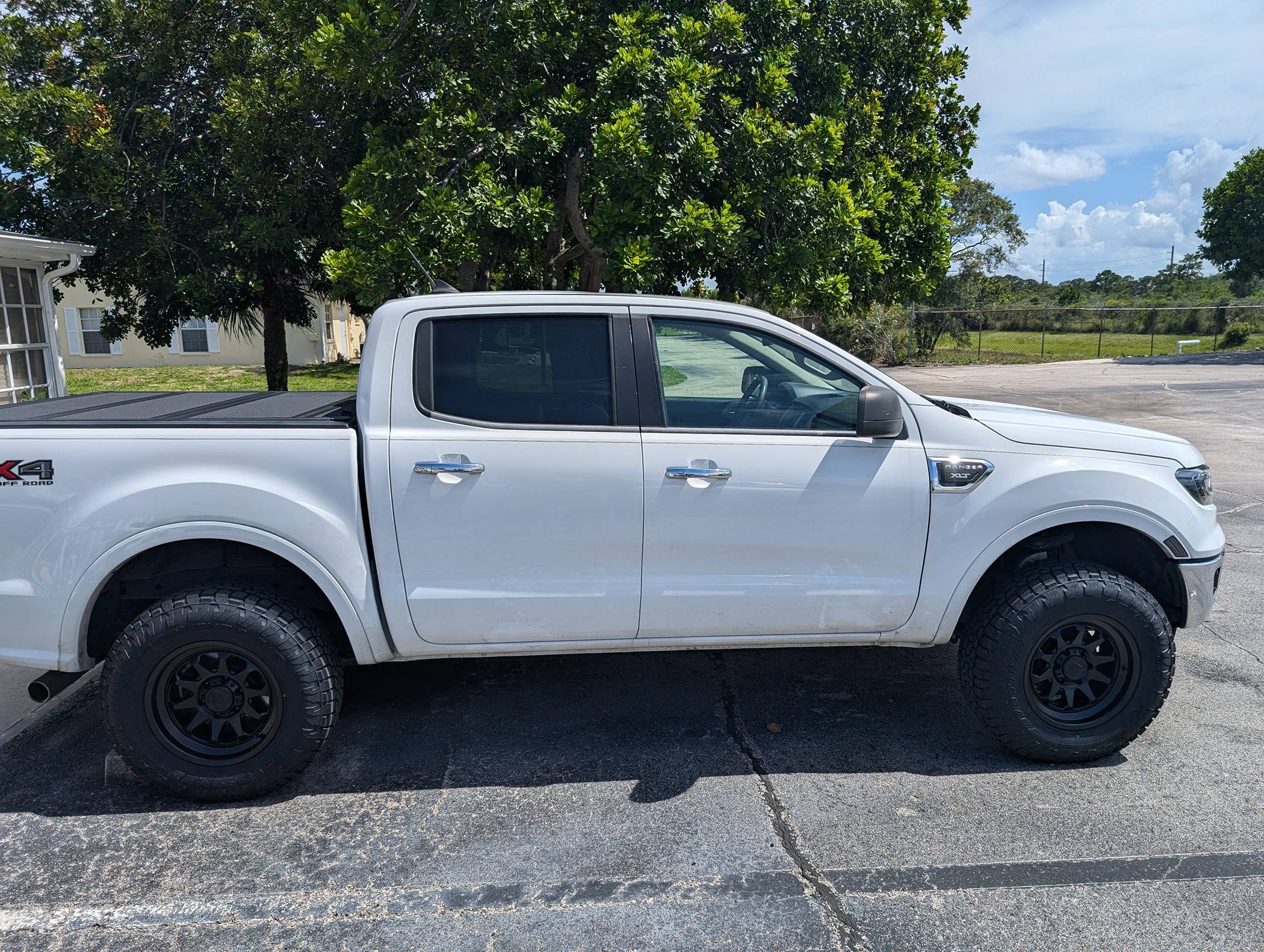

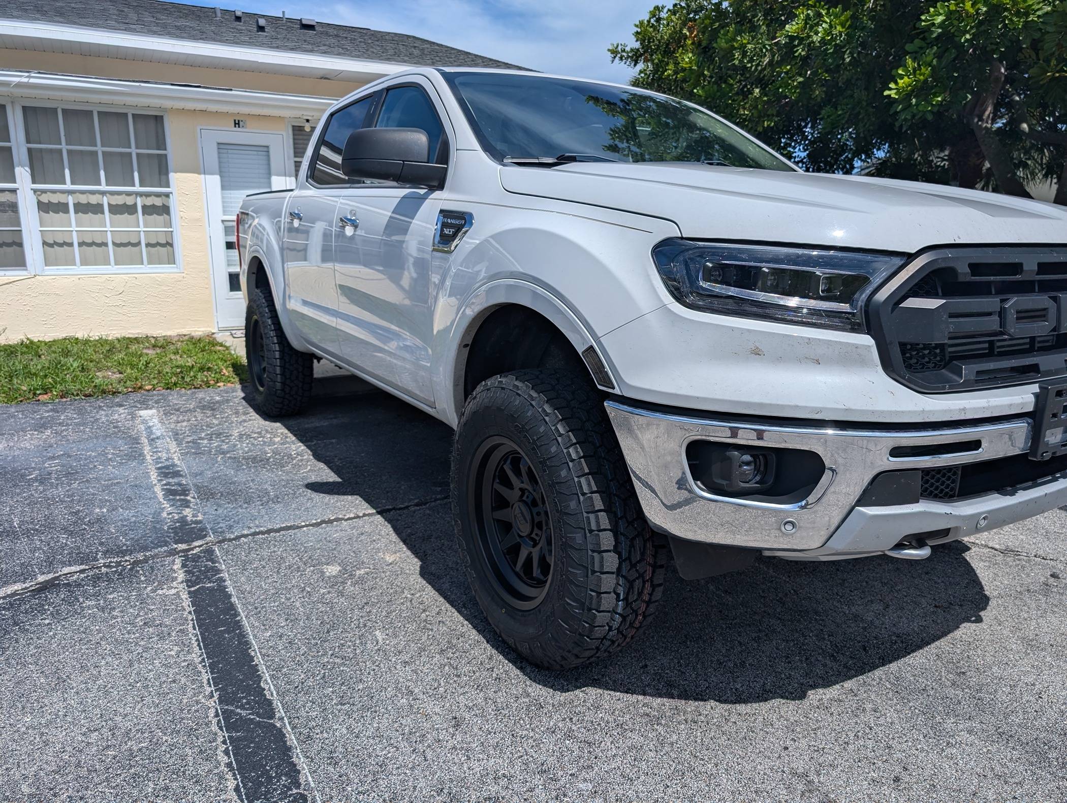

I just put on some 255/75/17's on a new 17x8.5 0 offset wheel. With a 2" leveling kit there is no rub at all with the factory crash bars.
