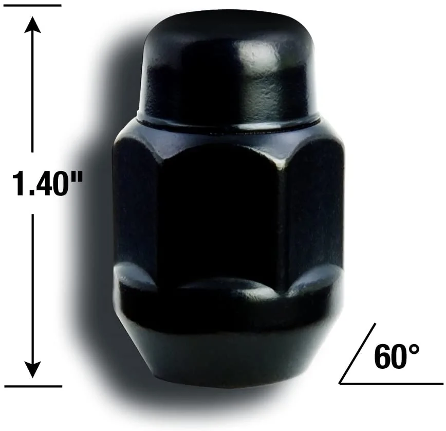

Gorilla Automotive 91137BCB Acorn Bulge Black Chrome Lug Nuts (12mm x 1.50 Thread Size)
will these work for stock tires on an XLT? 18 inch tires? A/S
These are the ones I ordered 71631NBC and they fit my wheels perfectly. The 60 degree flange uses the entire seat on the mag.
As far as I know the lug size is the same regardless of wheel or trim level.
Those are the locks I have as well. The 91137BCB are the matching nuts.
Lug size is the same it’s the 60 cone face that is larger. Reason I know is I ordered the others and when I was putting them on I noticed the seat wasn’t using the whole mag cone surface. Ordered the ones Inlisted and they use the whole cone.
