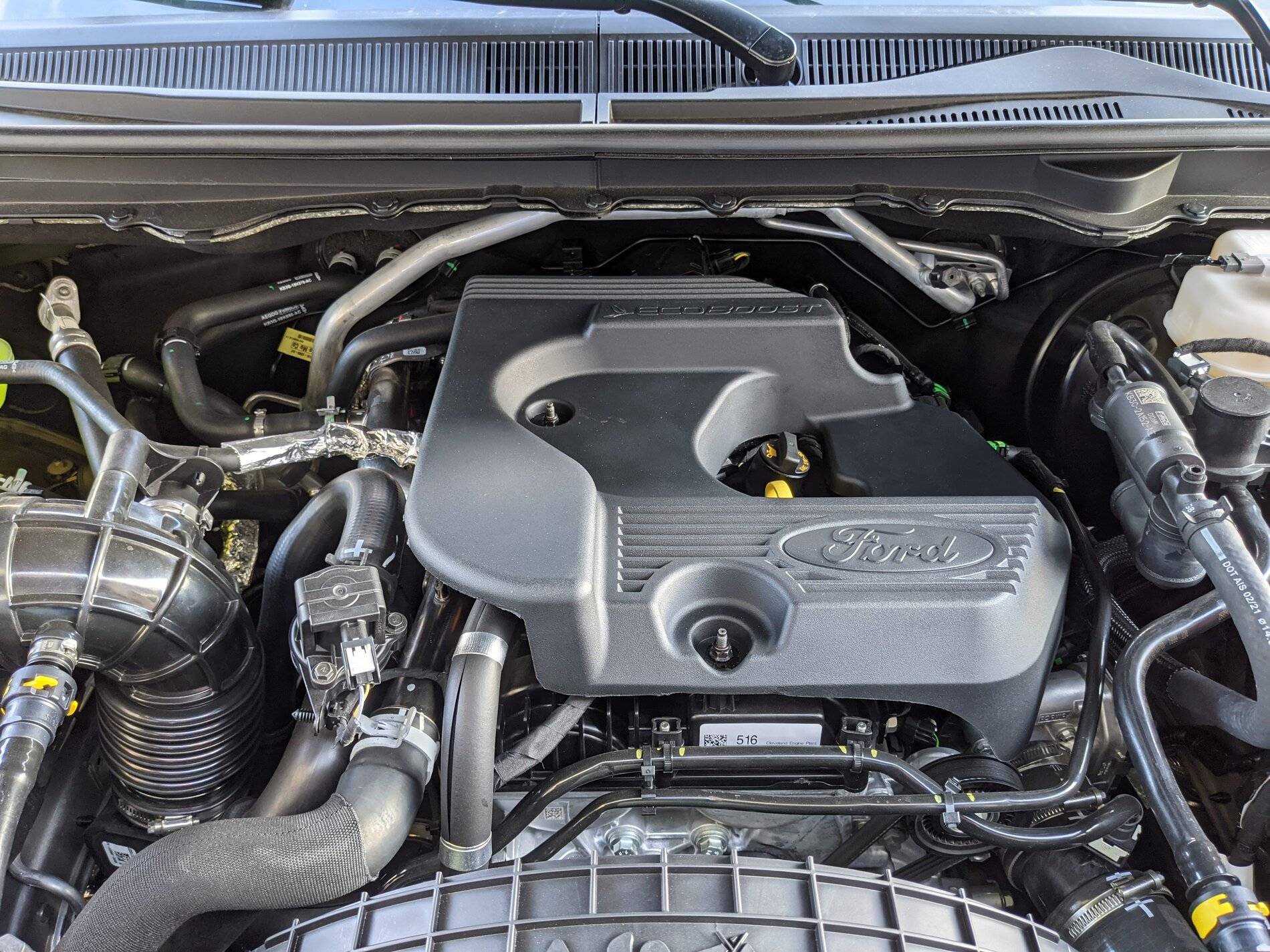

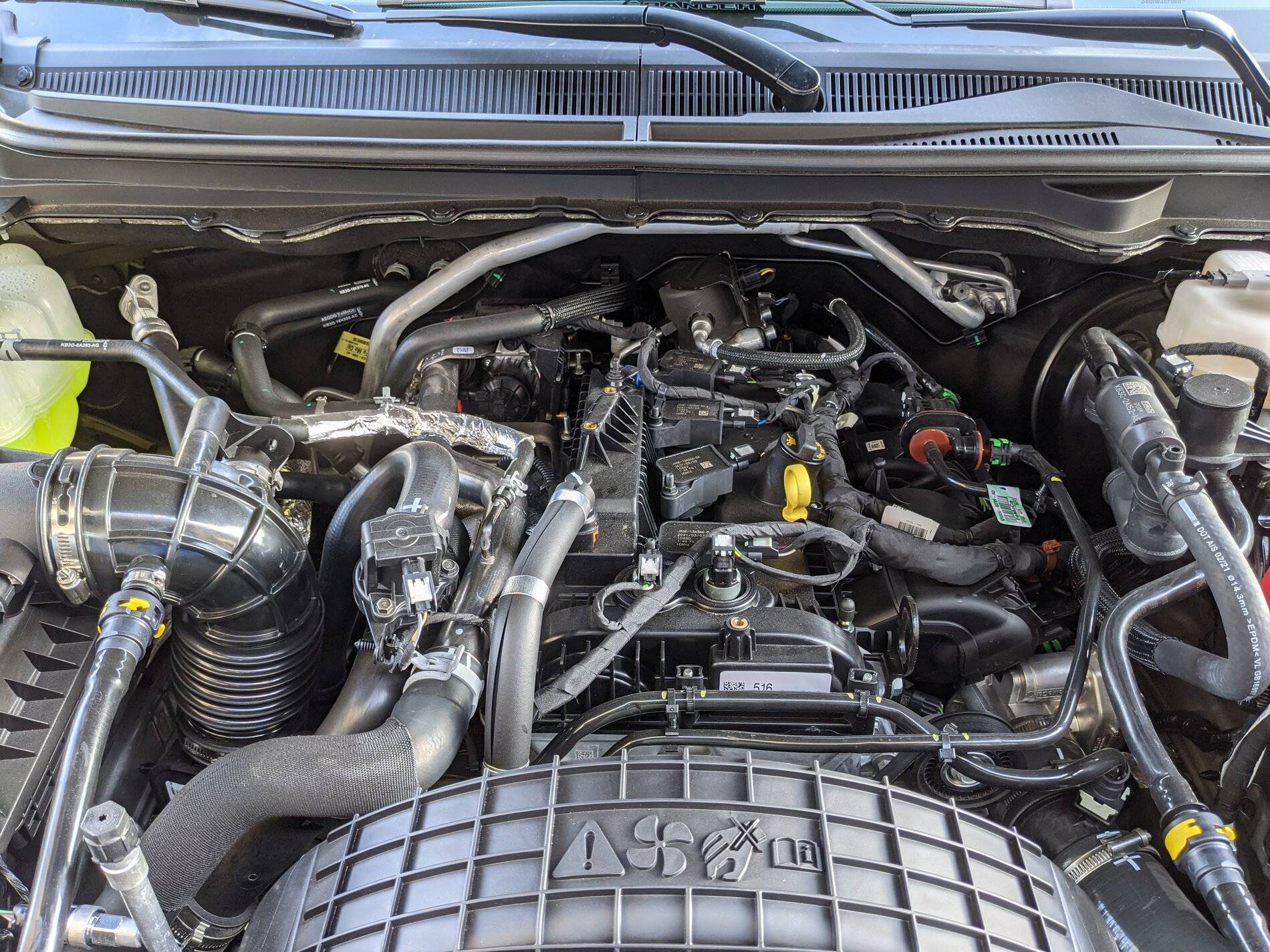

Engine cover
Before:
After:
Part - https://www.ebay.com/itm/313435943213
The link will probably not work soon but it was essentially:
NEW 2019-2021 Ford Ranger Lariat Engine Cover Installation Kit, OEM
When you get the kit rather than just the cover you get the two threaded studs necessary to mount the cover to.

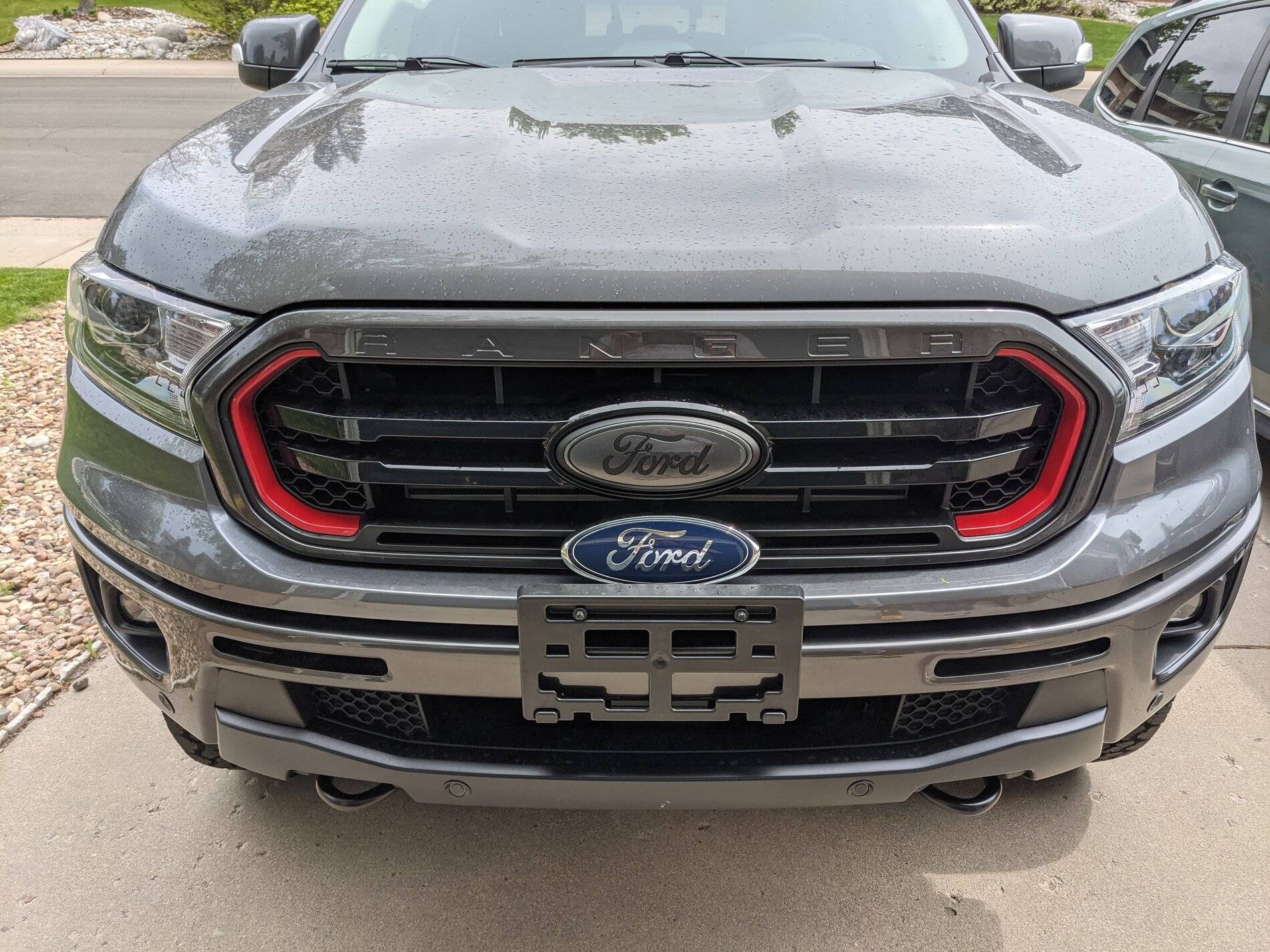

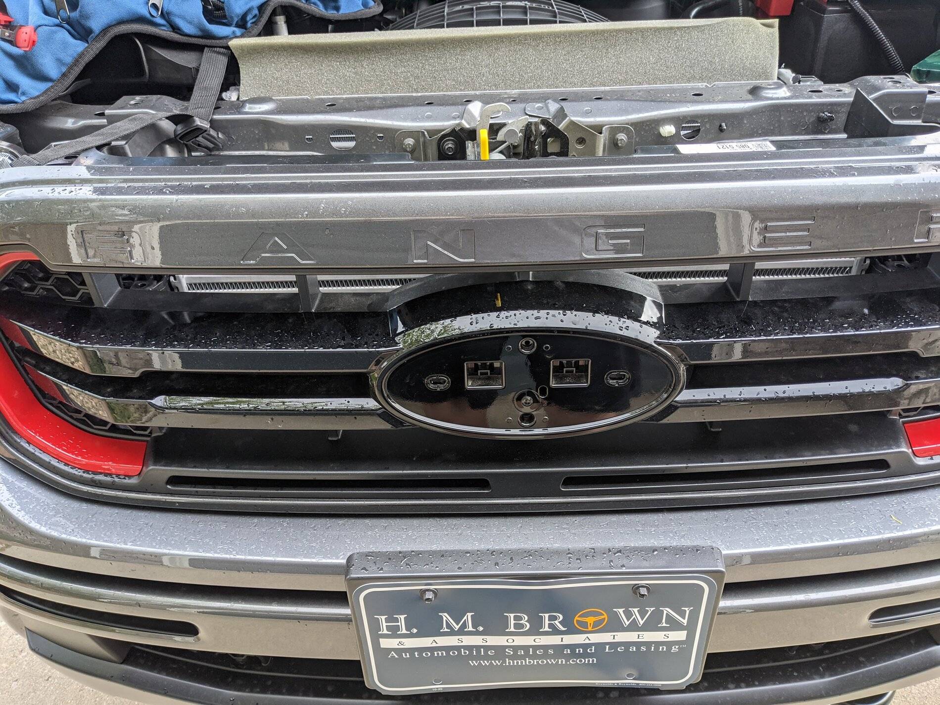

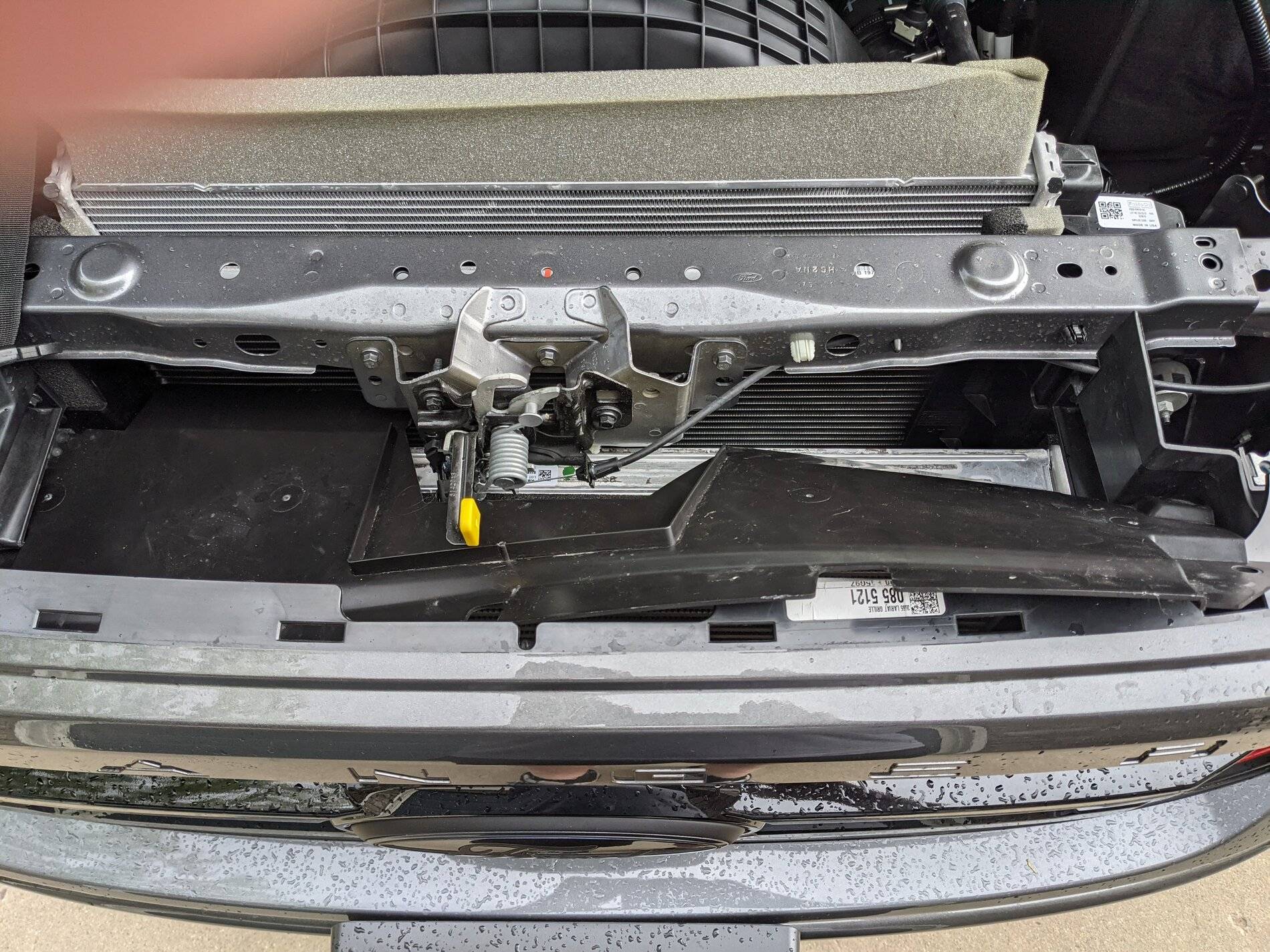

Today's project was replacing the front and rear emblems. The rear was easy, the front was a PITA due to the plastic shroud that I need to remove to access the back of the emblem.

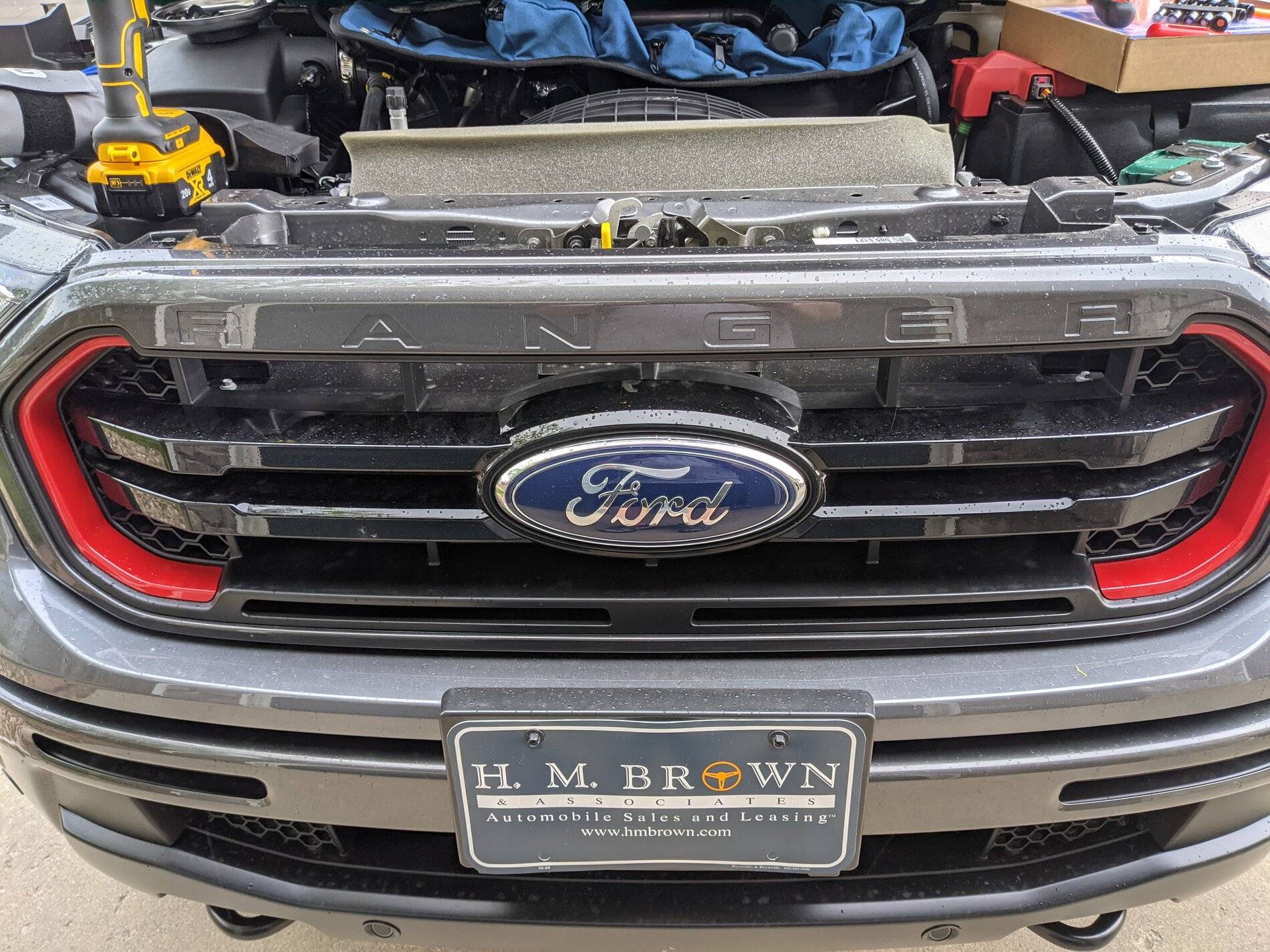

The front before:
The front during:

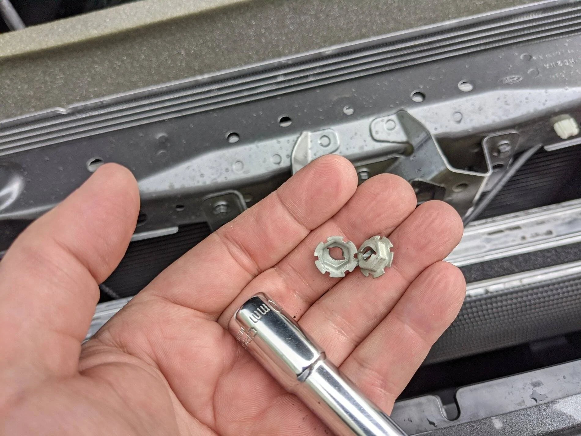

To get the emblem off easily you need to access the back and remove the nuts screwed onto the plastic threads. I followed the video here for instructions:
You only have to go as far as minute 3:00 where he removes the shroud before removing the grill. He makes it look so easy to remove the shroud but it was a major pain the in ass.
Here are the nuts on the back of the emblem that I reused. I was able to just remove them by hand with the 10 mm socket and tighten them back up by hand. Didn't want to strip anything.

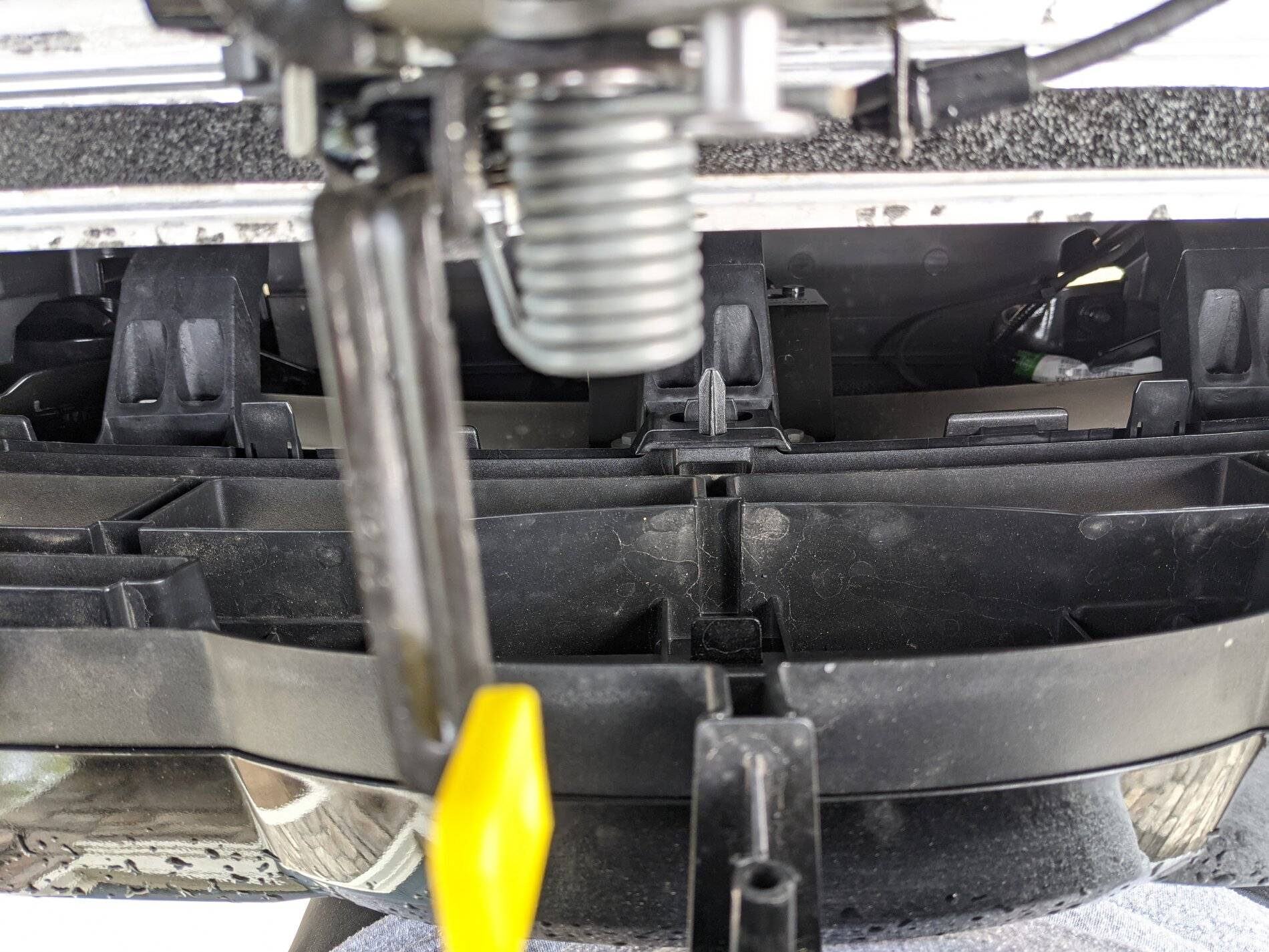

This is the shroud half way out:
With the shroud removed you have easy access:

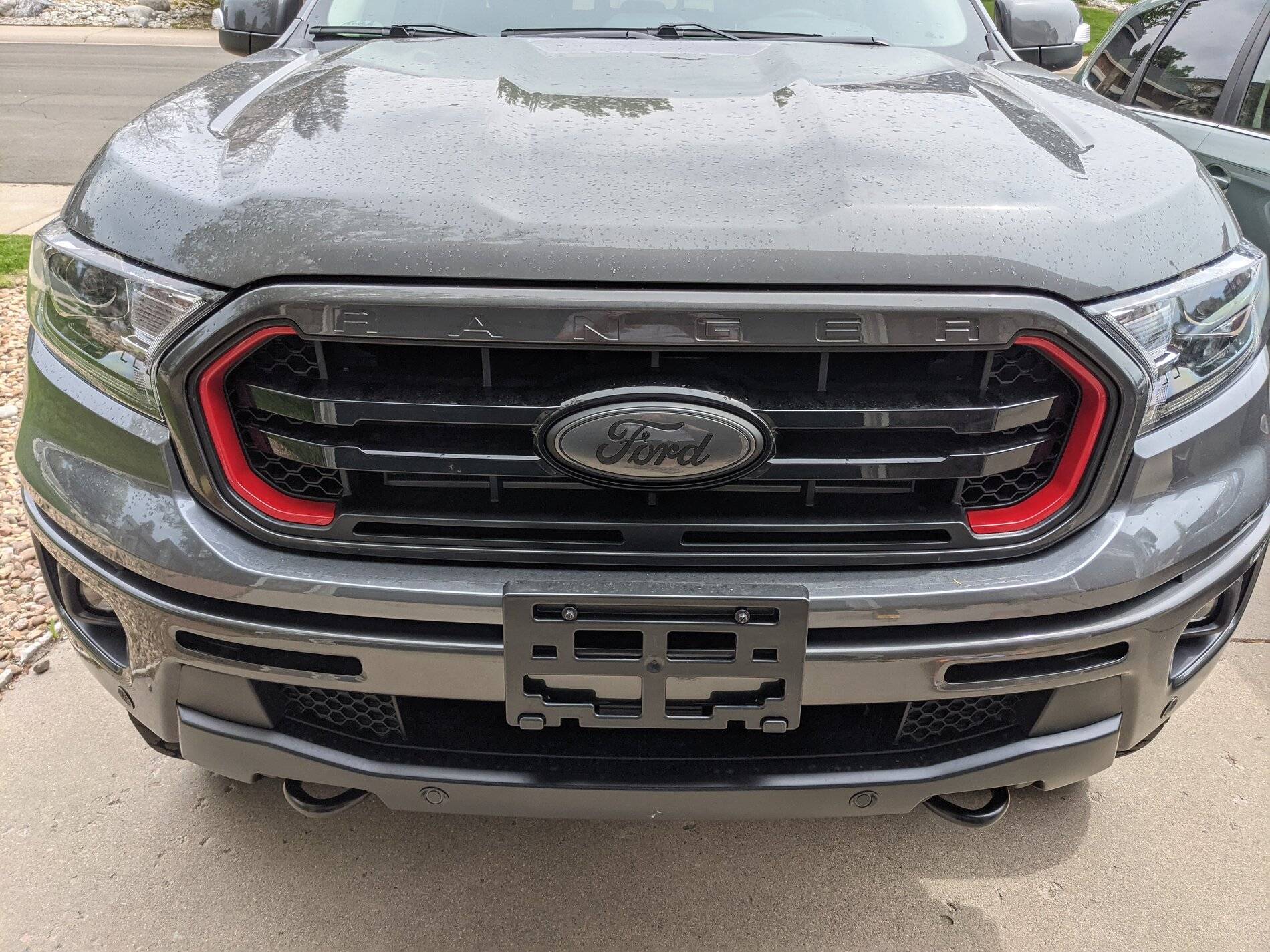

Comparison of new vs old:
Final:
I purchased the emblems here:
https://www.ebay.com/itm/293325610677
It was the complete set, front and back, with the camera housing. It was not cheap, but I like the way it turned out. Back emblem in next post.

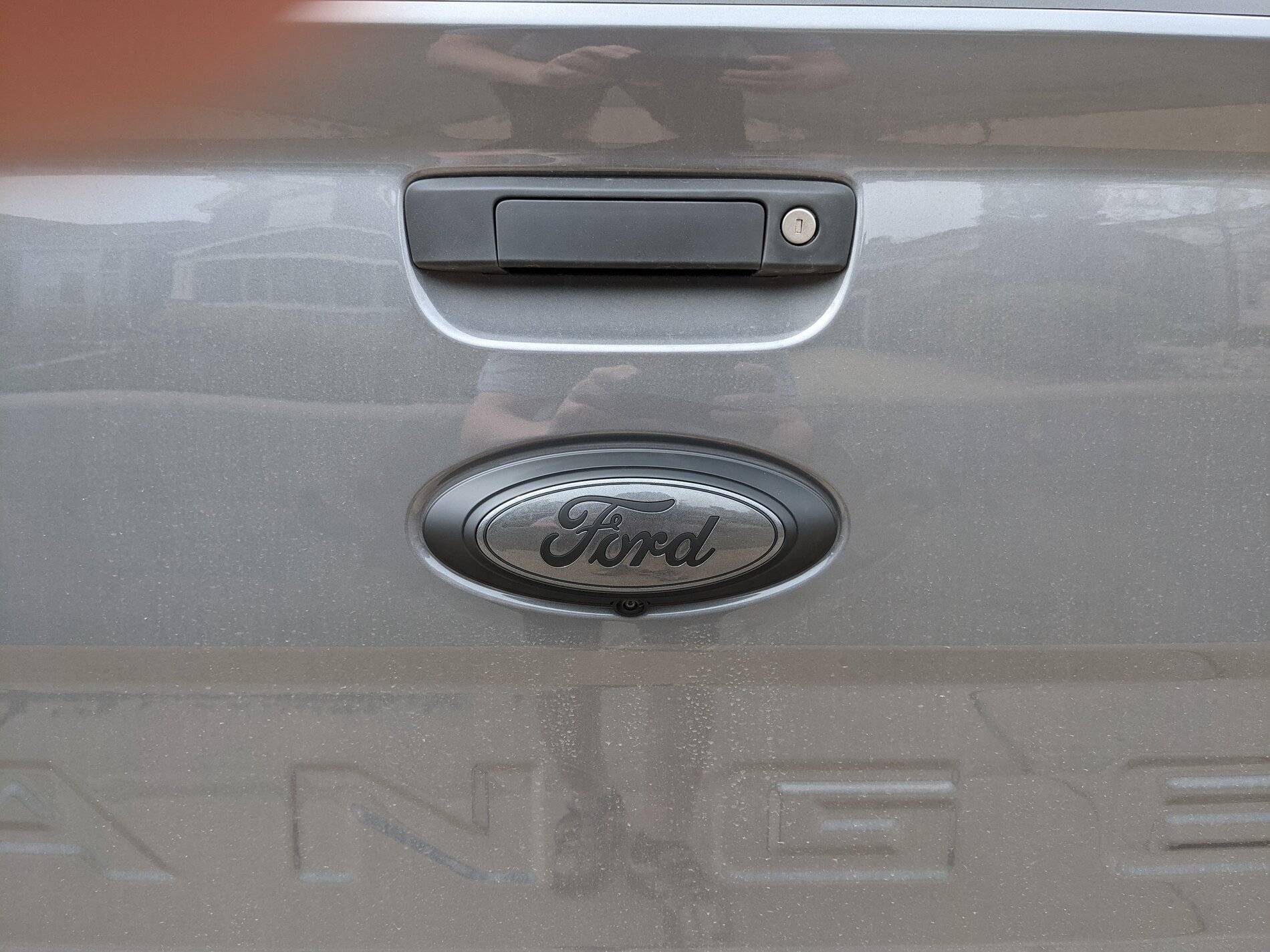

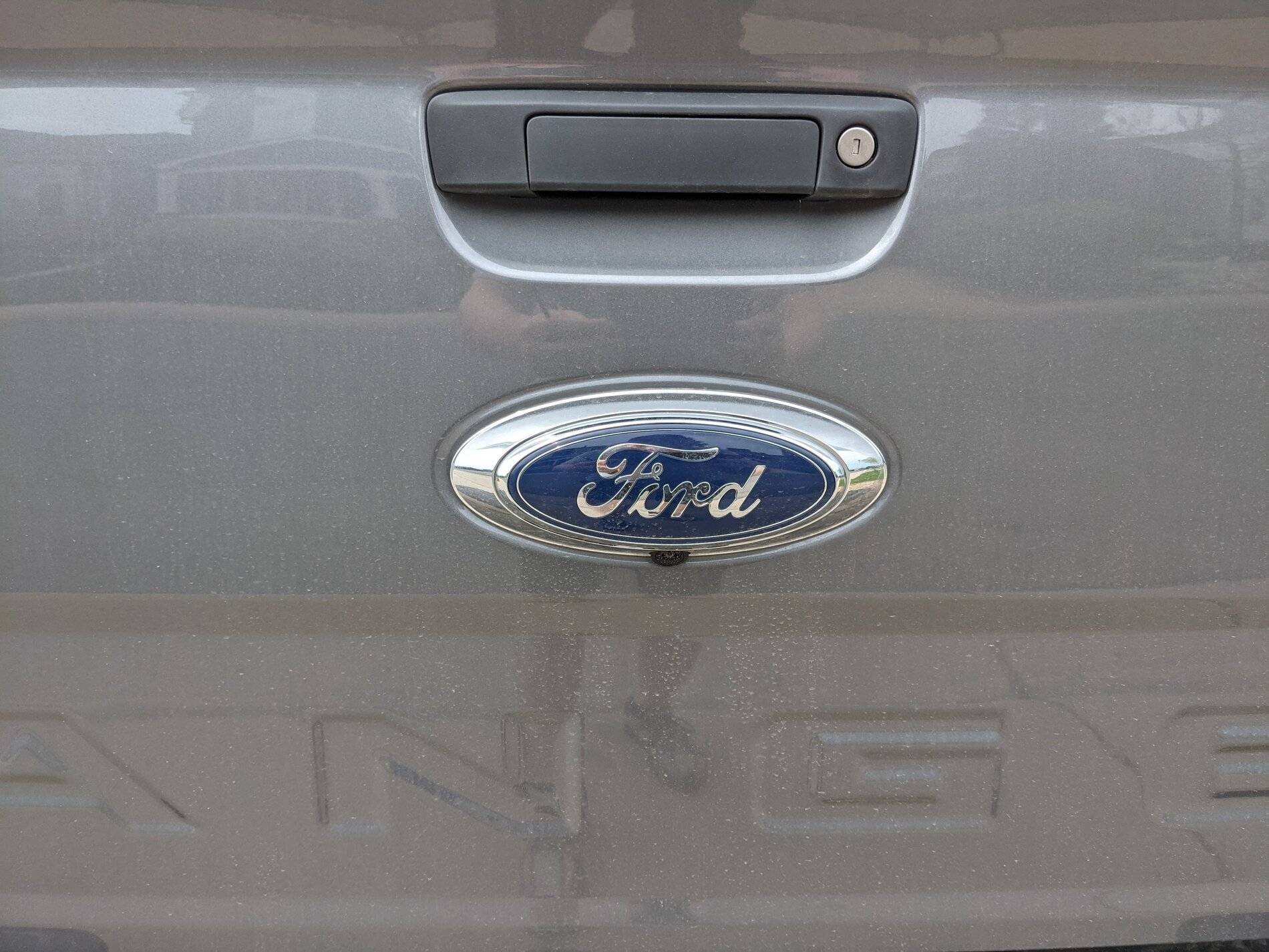

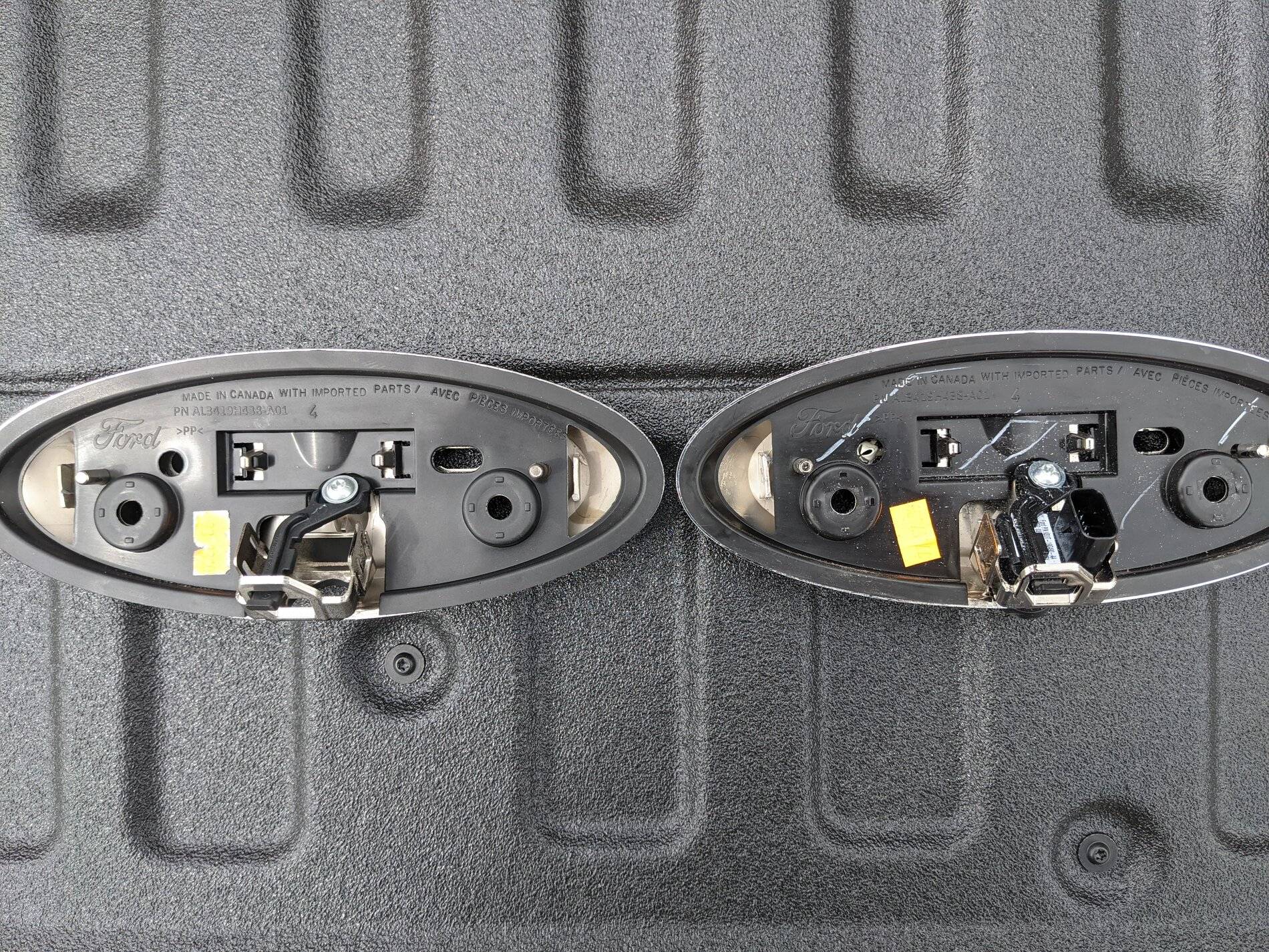

Now for the back emblem, this was super easy.
Before:
Popping off the back emblem from the housing was easy. There is a little gap on the bottom where you can stick in a small flat head screwdriver and open it a little. Then I inserted some plastic trim tools to gently pry it off. This gives you access to two bolts which hold the camera housing in place. Remove those, disconnect the camera, and it is off.
Here are the new and old camera housings side by side. You just need to move the camera from one to the other. Very easy.
Finished.
During this process I didn't break anything which I think is a near miracle. It really helps to have some tools made for the job. I purchased the kit below and used several of the tools to pop fasters, etc, without damaging anything.
https://www.amazon.com/gp/product/B07CQKMK8F/

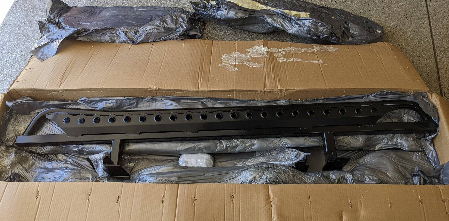

Look what the freight delivery dropped off today! Guess I will be busy this weekend.
Schweet! Looking forward to seeing how far out the step sticks out at the rear...
Heads Up.... Check the bag of fasteners to make sure they sent you the right one's.... (make sure the stick nuts match the bolt sizes).
Regrettably, these are not the correct sliders. When I went to install them this weekend they were obviously not meant for the Ranger and the wrong item was shipped. Thankfully customer service at Shrockworks was great and they should have the correct item out to me in a couple weeks and pick these up at the same time. I should have known on Wednesday when I opened this box because the rear of the slider is flared out, and the ranger sliders do not have this.
