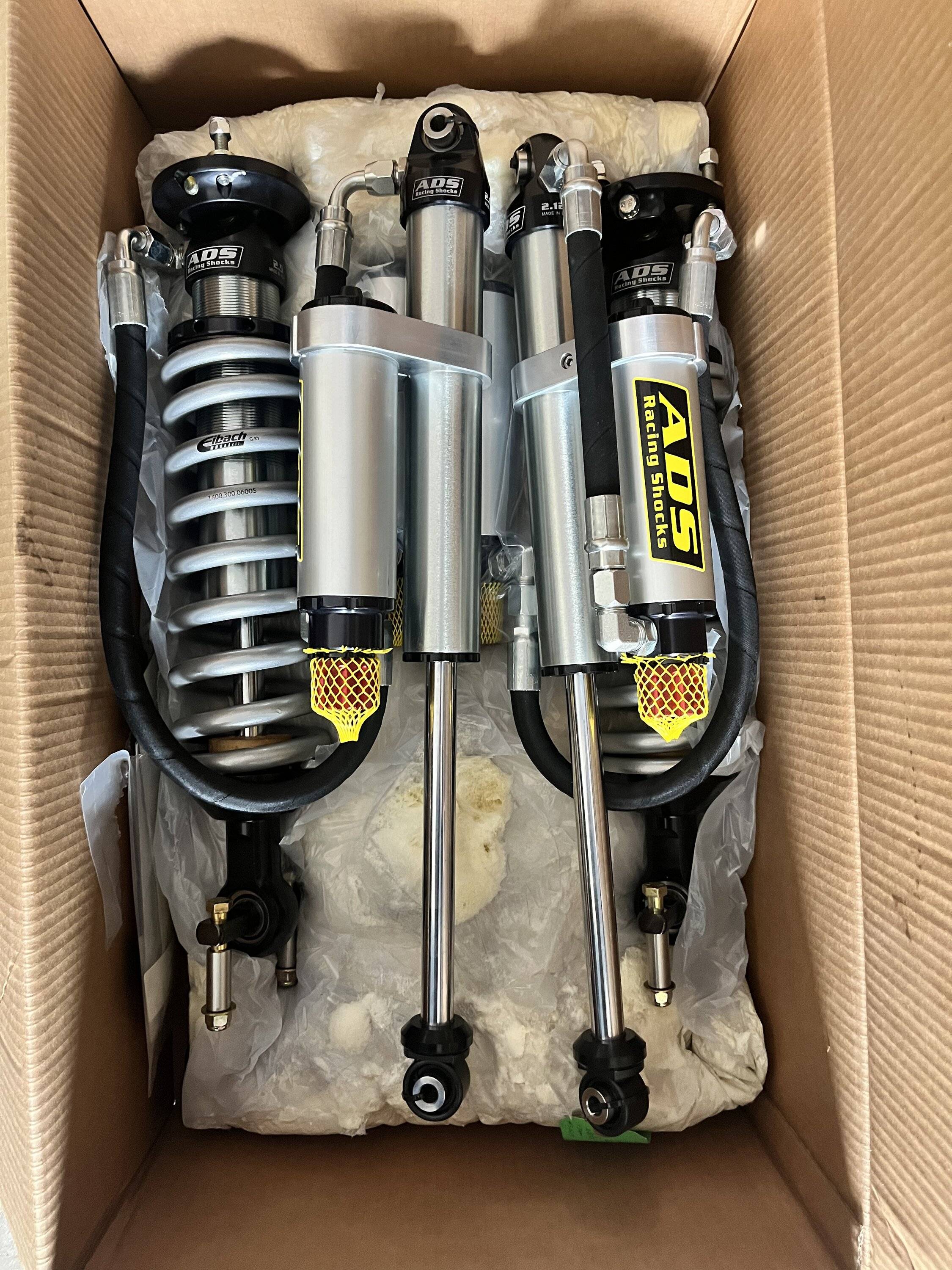

Yea I'm not sure if those shocks are long enough for the total travel you'll have.
Hence the new ADS extended travel 2.5” shock package. It will increase travel and provide far more dampening so I’m excited.

Is extended travel just 1 more inch over the non extended or more than an inch? When you install the deavers, you'll know if your shocks are long enough by letting the pack droop out without the lower end of the shock bolted up. If the lower shock mount on the shock body is above the mount on the rear end than the shock isn't long enough, of course. Either way it'll be a hell of a way better ride. I know some people have put super duty shocks on the ranger since they're longer with the icon or deaver springs since the springs droop out so much. I believe the general term "extended travel" is just an inch over stock in case someone raises the rear an inch with stock springs.

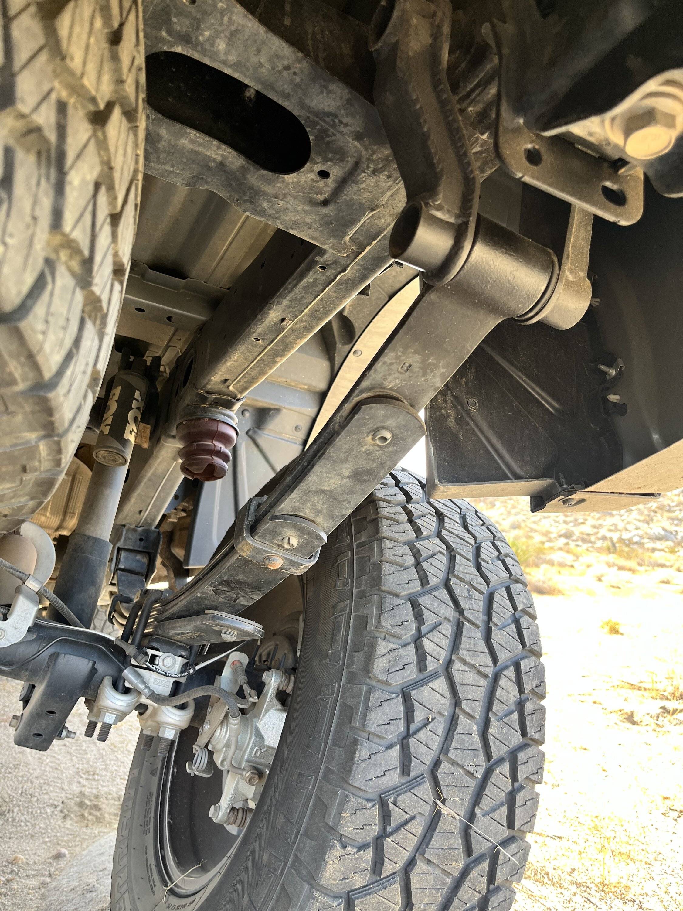

I just ordered the boxed shackles and then realized it uses stock bushings. Did you swap over the bushings? Thinking of throwing poly's in there.
