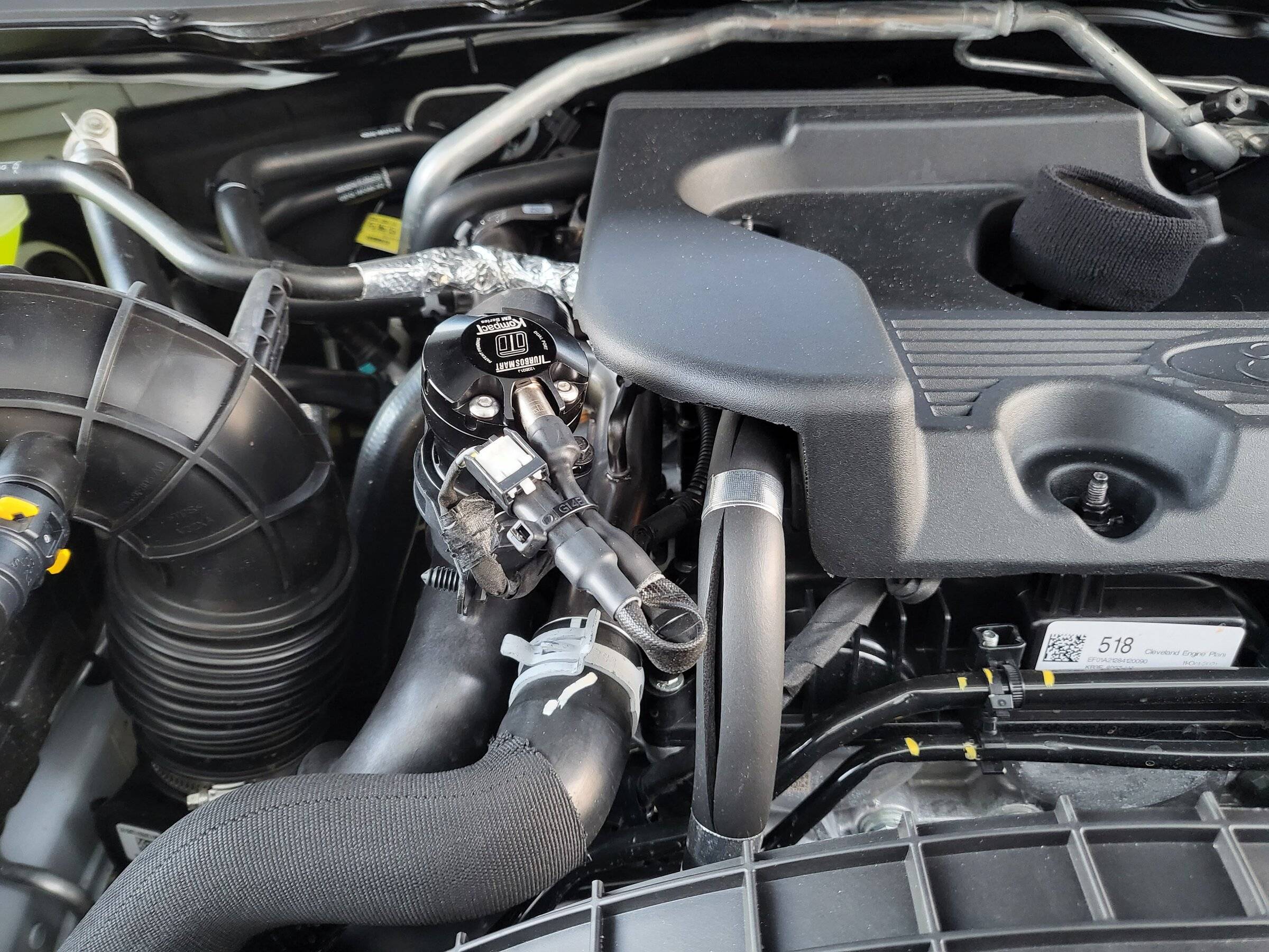

I put on the Turbo Smart BOV for a stronger BOV versus the factory diverter. I have no idea if the factory DV is strong enough for the Livernois tune, but I figured it would be good to upgrade it anyways.

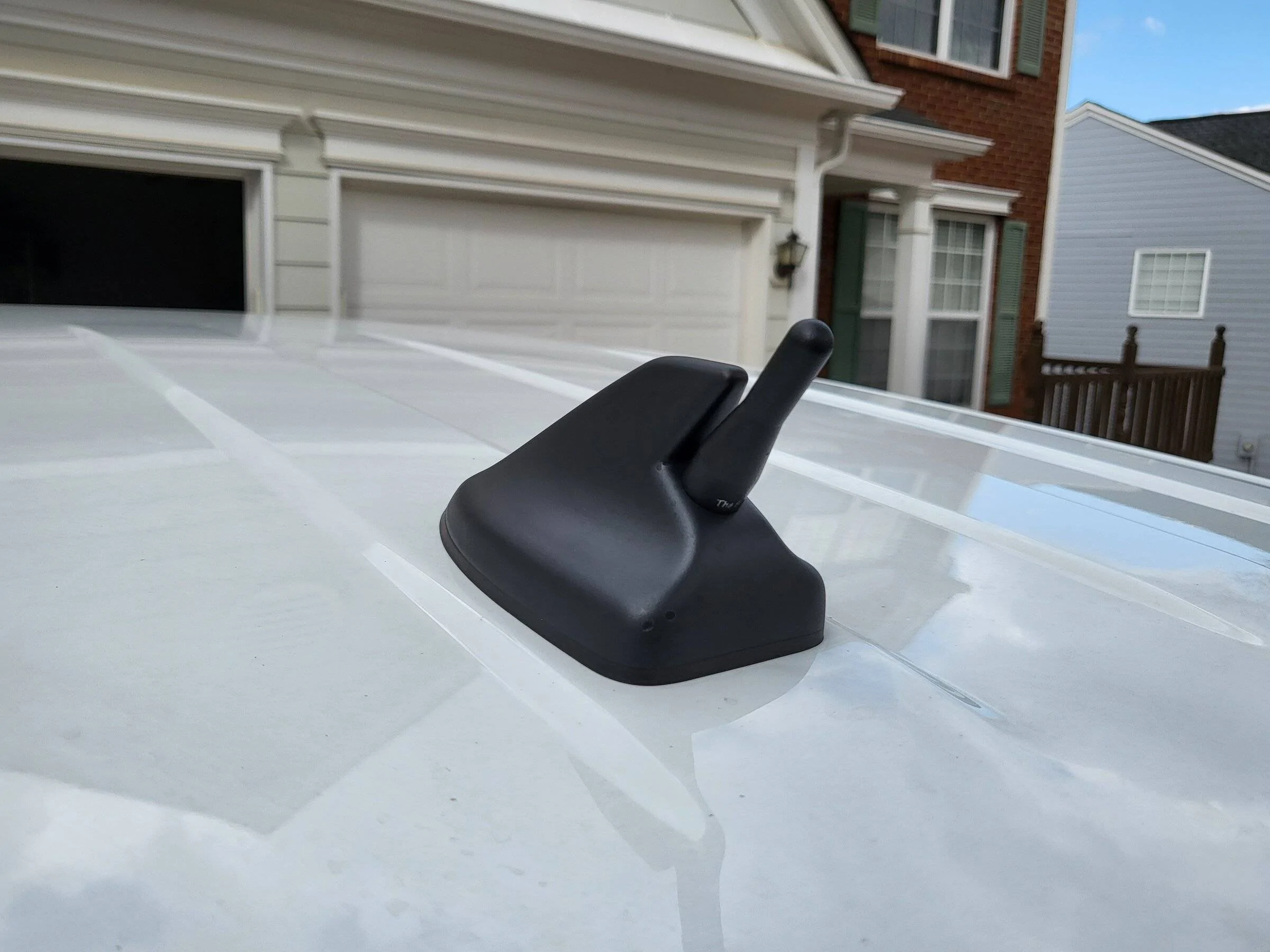

I also installed the Cravenspeed 2" stubby antenna. I have one on my Miata. They work great.

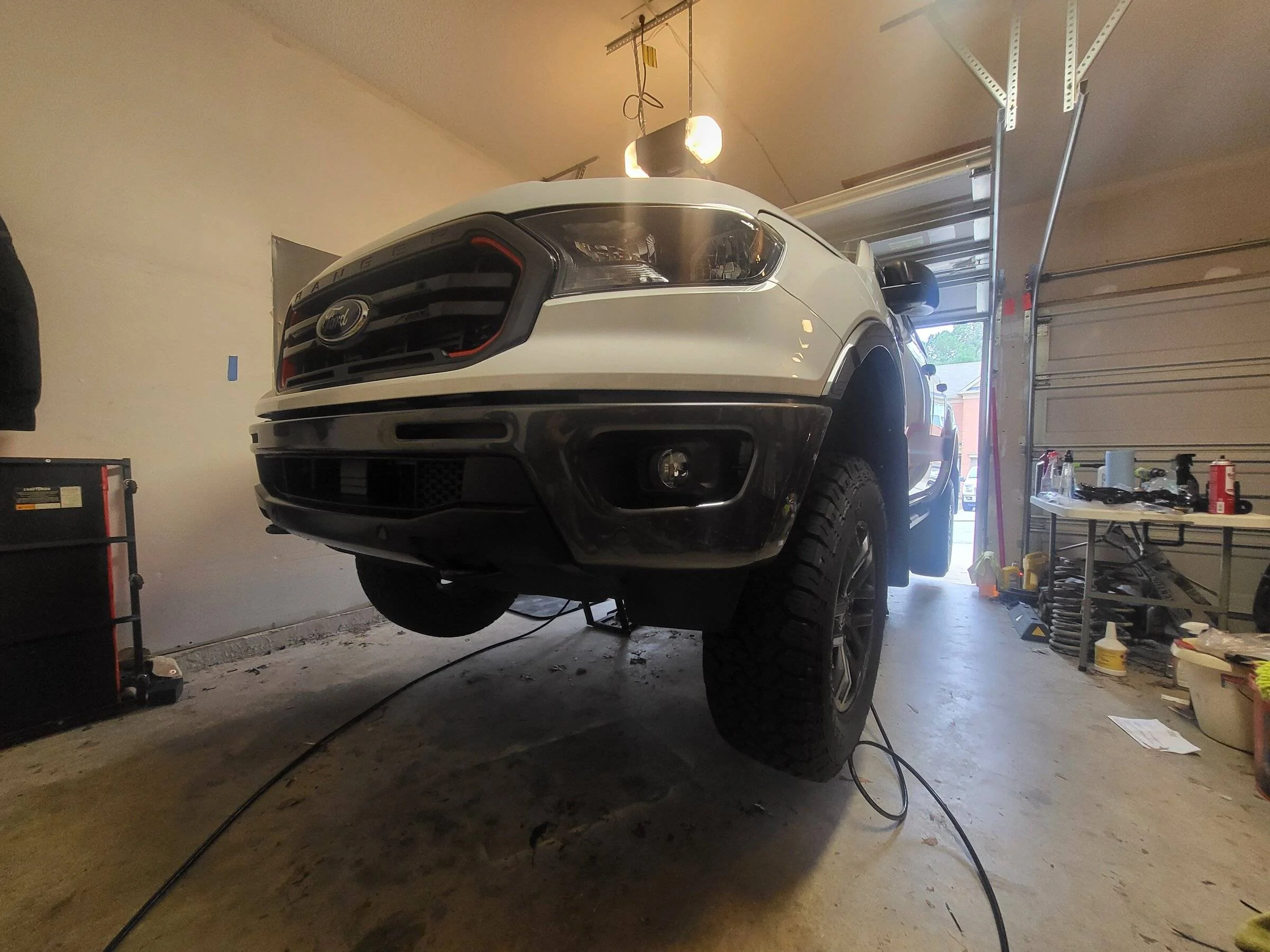

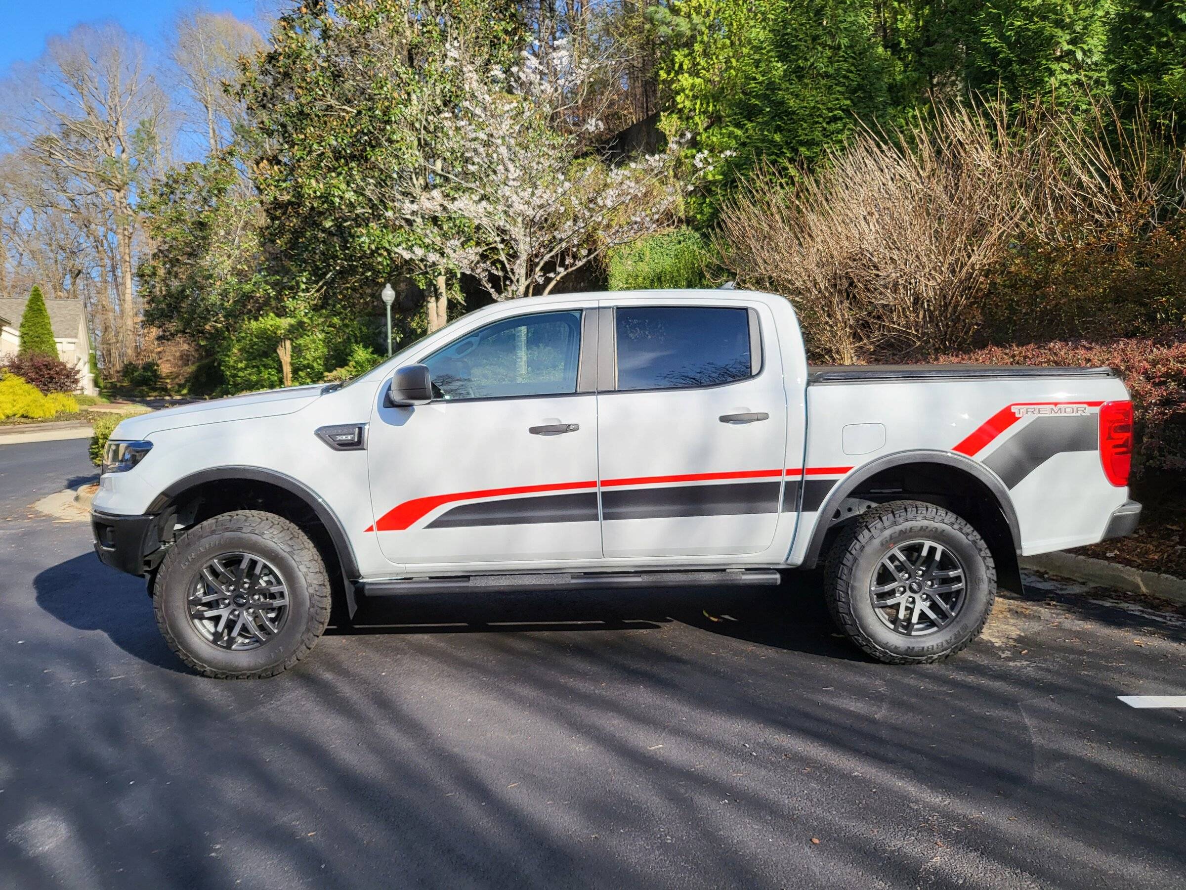

I installed the Ford Ranger Lifts 1" spacer. I was going to hold off until I upgraded to 2.5 Fox coils, but the rake started bugging me.
I like the how it looks now. The rear is about half an inch higher when unloaded.

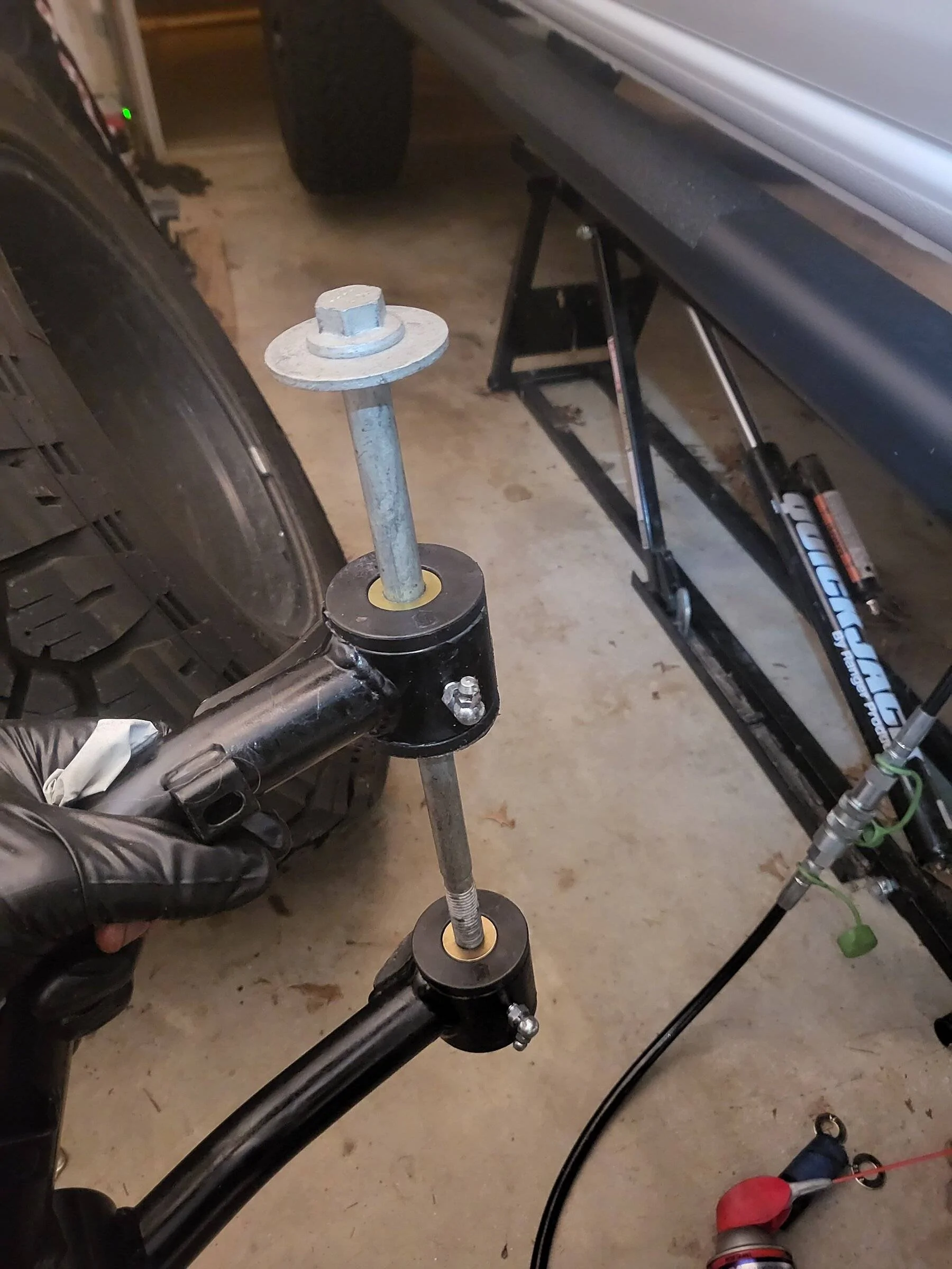

I hit a major snag with these ICON UCAs. One of the bushings had an incorrect inner diamater.
Still waiting for a replacement after a week.

Then 1" Faction Fab wheel spacers. No vibrations at highway speed, they seem to be top quality.
1" is perfect for the Tremor wheels. They put my offset at 16.6. I think 15-20mm offset is perfect with the Tremor flares.

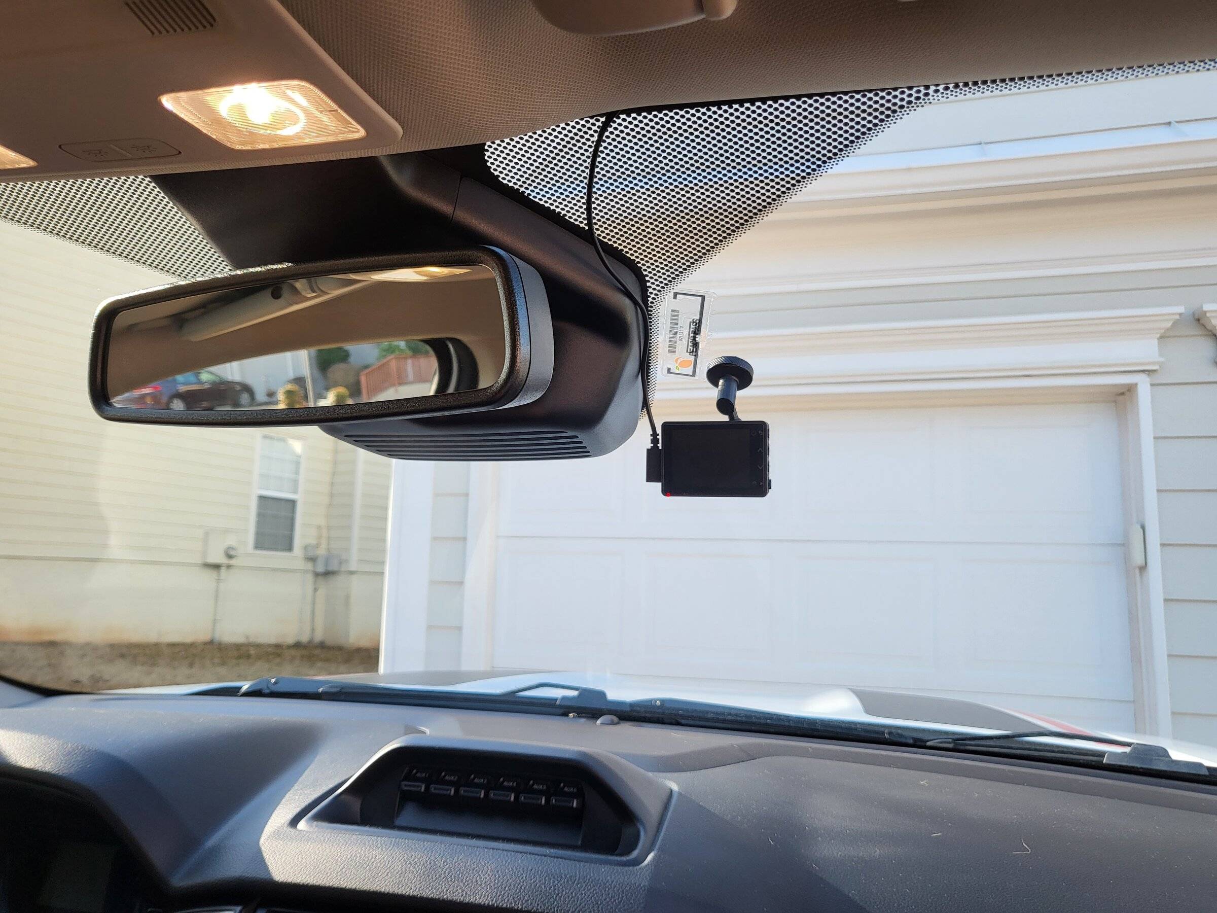

Installed a Garmin 67W dashcam. I don't feel like hardwiring it.
As a trick I tightened zip ties as tight as they go, then cut off the tails, for the wire running under the headliner. I did this so the wire doesn't pop out. Then I routed it down the passenger A pillar, between the dash and the A pillar, then zip tied the slack behind the glove box. It is plugged into the passenger side 12v outlet.
Very clean in person.

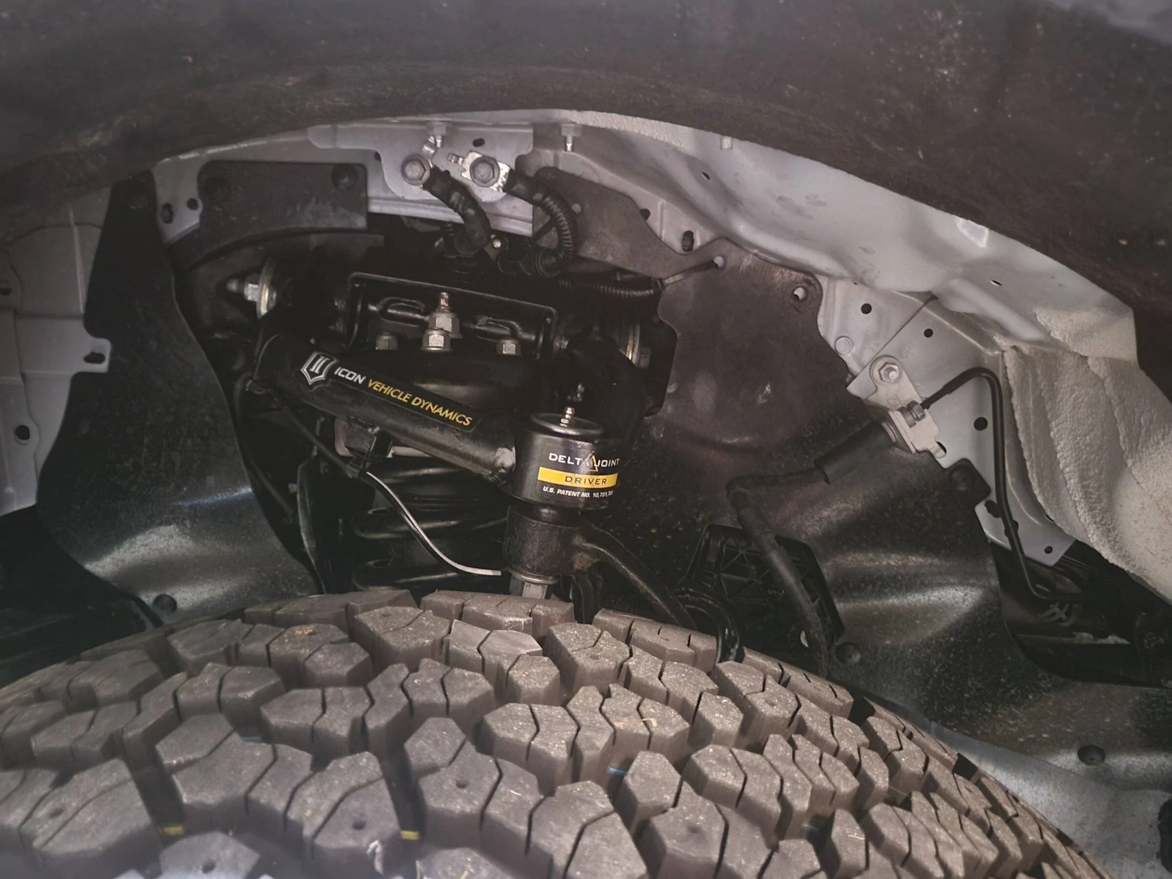

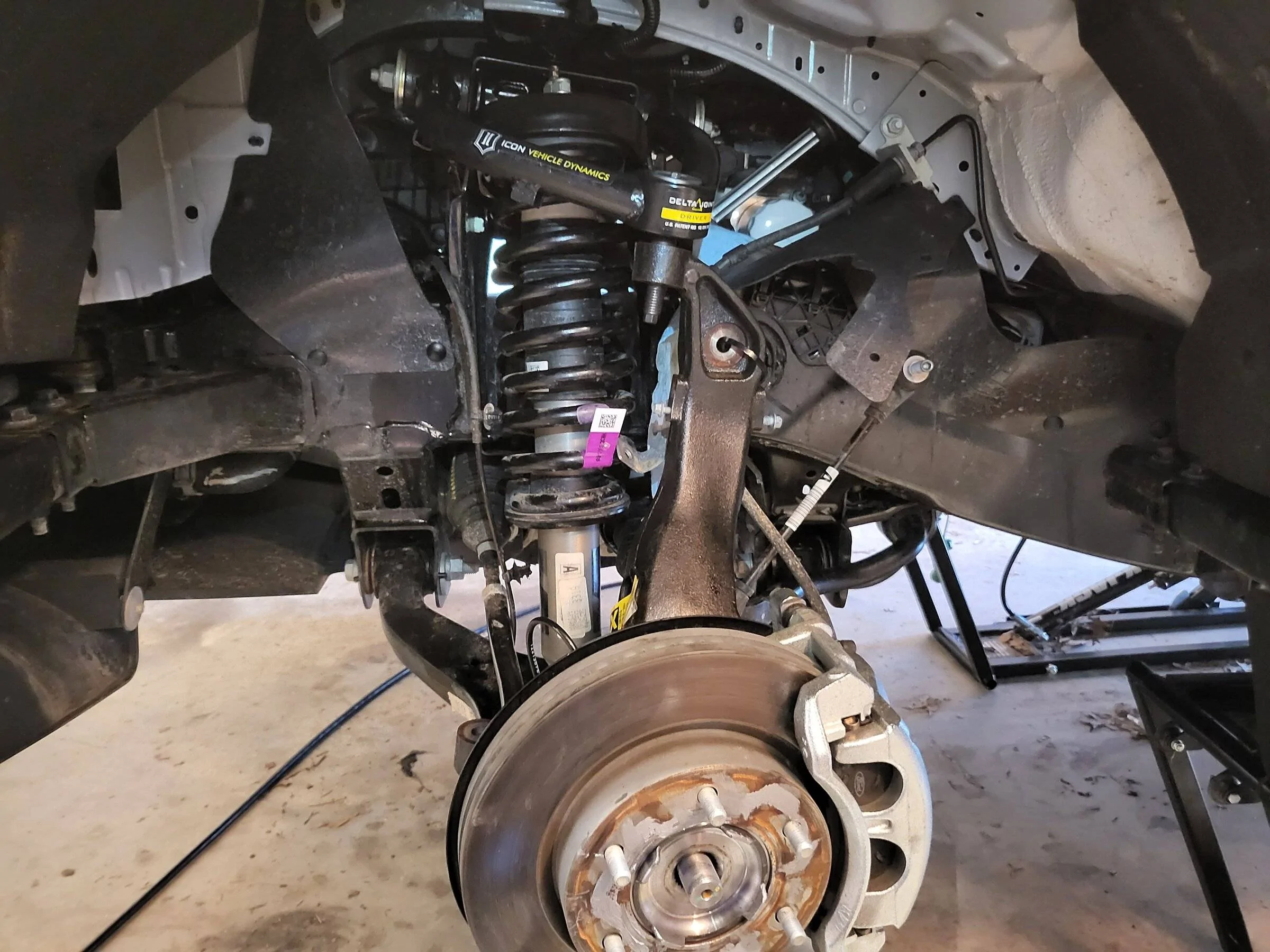

I finally got the correct bushing in the mail from ICON. Their customer service and priority is garbage.
Here are the torque specs in case anyone needs them
Upper balt joint 46 ft lbs OEM
Aftermarket UCA upper ball joint 60-66 ft lbs
sway end link on knuckle side 85 ft lbs
axle nut 221 ft lbs
coilover upper nuts 41 ft lbs
coilover lower nuts 66 ft lbs
brake hose 18nm or 159 inch lbs
tie rod nut 35 ft lbs
UCA long bolt 122 ft lbs (With suspension under load, place a jack under LCA)
On a slight hill.

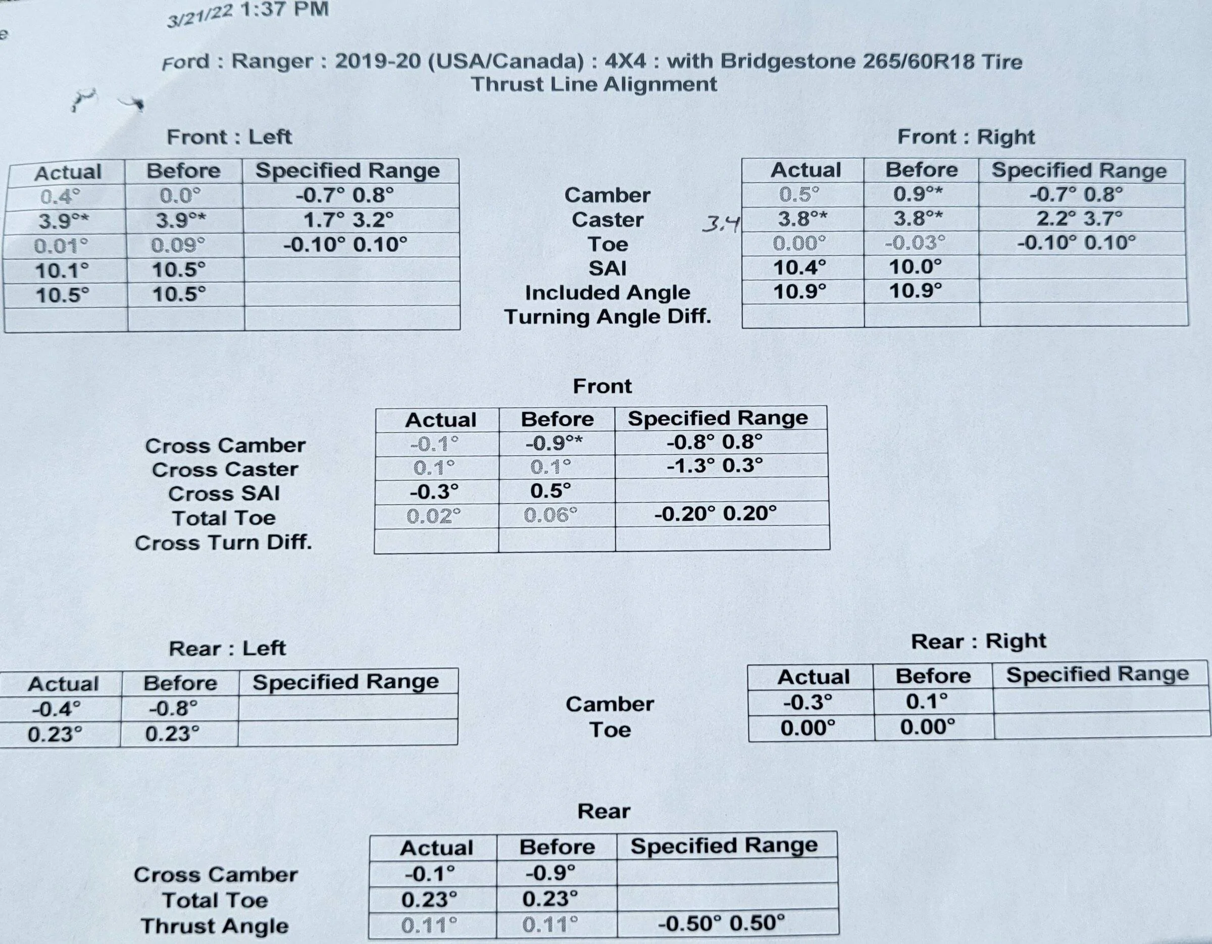

No issues with the alignment. Everything looks good. The shop didn't bother with pulling up the right specs, instead just going off of the actual numbers and range of adjustment left either way. The before numbers might not be 100% accurate, against they just focus on the resulting numbers. Our suspension is very straight forward.
Camber effects toe, so they were happy with basically zero toe with .4-.5 of positive camber. Caster is nice and healthy.
I went to my race shop, they specialize in GTRs, Japanese performance cars, and 1/2 mile shoot out cars.

Truck looks great! Did you install coilovers at the same time? Or were all these torque settings needed just for the UCAs.
Aonarch
Alec
Jan 21, 2022
731
1,795
North GA/ Montana
'21 Tremor, '16 Audi TT, '21 Ducati Hyper, '85 E30
I put a FRL 1" level, so I did remove the coilovers.
