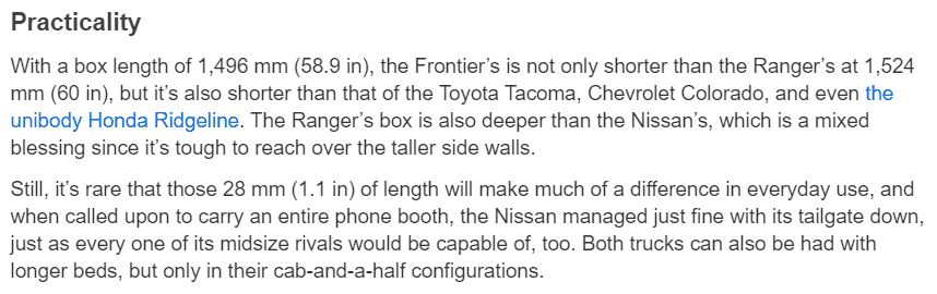

Taller sidewalls of 38mm. I guess thats all it takes......

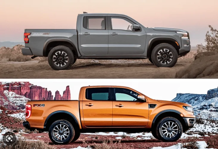

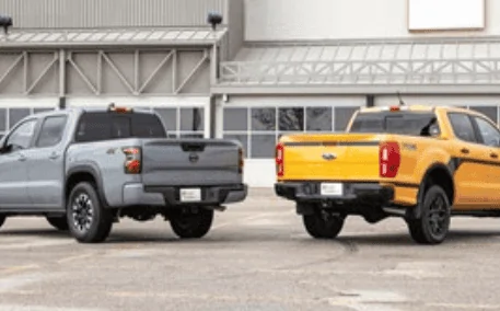

Notice that the picture of the Ranger is 'Photoshopped' lowered in the rear, by FORD! it's actually faked. The pics on the build it site are all doctored to make it look equal ride height. And it's not correctable. It can't be fixed while preserving functionality. Had to be a flaw. It's a great truck, except for the rear air azz problem. lol.
the top pic isn't a photoshop, but also note the lower pic of the Nissan is not on level ground.
Hard to find any pic of a true side by side. We can nitpick the photos back and forth all we want, it'll never change that your view is incorrect.

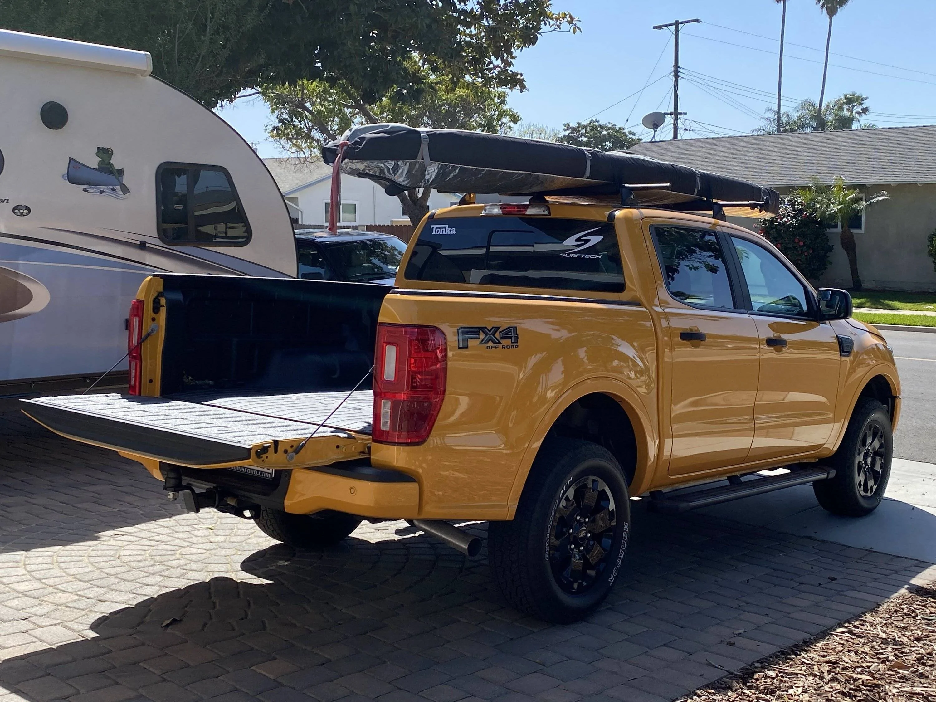

I have a few thoughts on this, as I HAVE lowered the back of my truck, first, I always level every truck I have owned, usually by lowering the rear not the front, but not always.
This truck was very tough to drop, it's design rules out shorter shackles and lowering blocks, the two most common parts for leaf spring drop, the Ranger can only be dropped from a spring de-arch, or whole axle flip, not a design flaw, just how's it's built.
I also lowered it for ease of loading my heavy ass ebike, I have a crap back and the ramp angle to the tailgate was the same as the 2010 Raptor I traded in(put lowered Deavers on it), even though the bed was lower, the rake made it about the same tailgate height, but after a mere 1.5" drop at the spring, it dropped the tailgate height about 4", doesn't sound like much but my ramp is only just over 5' long.
In defense of the OP, has something bugged you so bad you hyper focused on it? well until I lowered it, the stinkbug ass high stock Ranger look did that to me, especially when I would see a stock, level, Taco go by, but it didn't bug me enough to ditch the Ford for a Nissan, although the Frontier does look pretty good.
I know Ford did it for the tow/haul rating, it must have bugged even them as the website Ranger is photo shopped lower in the back, and they also move the wheels out further, which is BS in my opinion.
When I was searching for global springs, I did find a parts catalog reference for a "high frame" and a "low frame" in either a UK or AU catalog, if you notice in pictures of non US models they are not as raked, that's what set me on the search for alternate springs, I found them but still had to de-arch them to get it level.

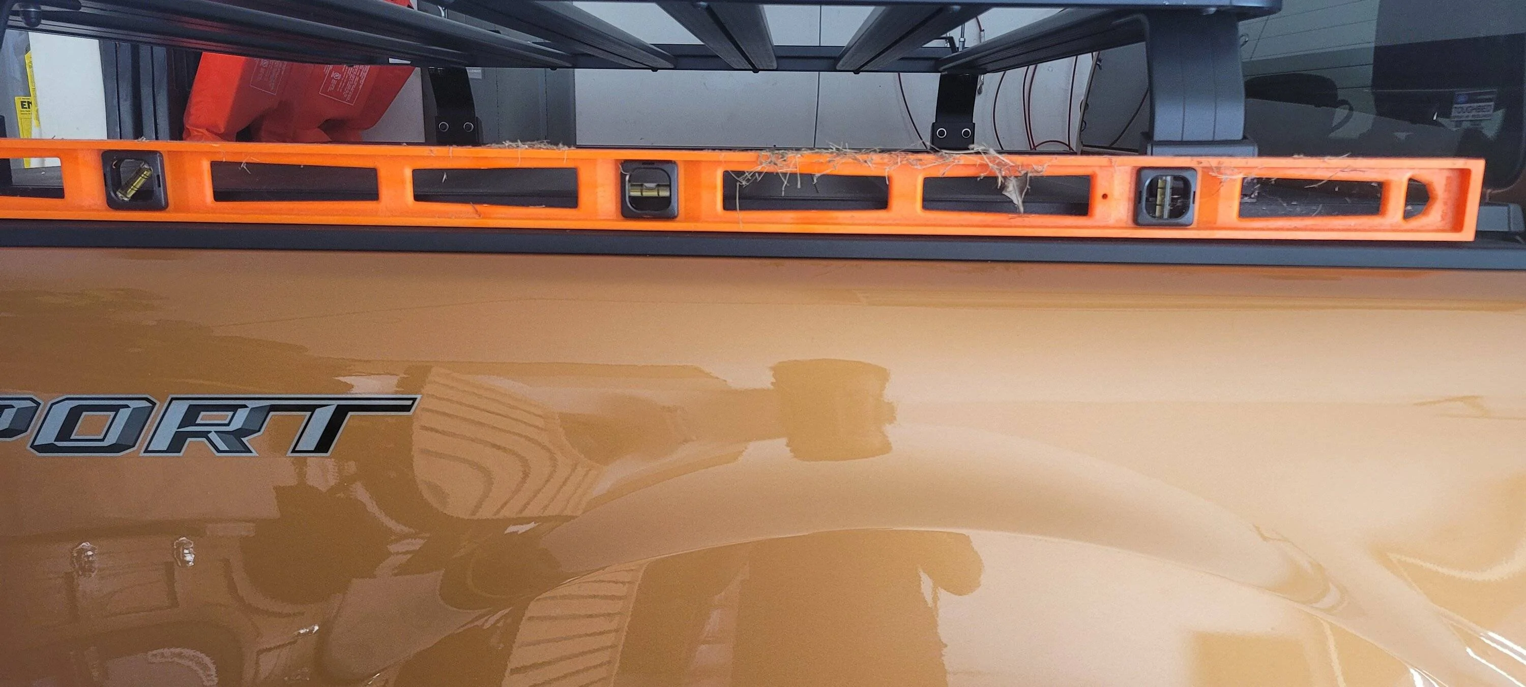

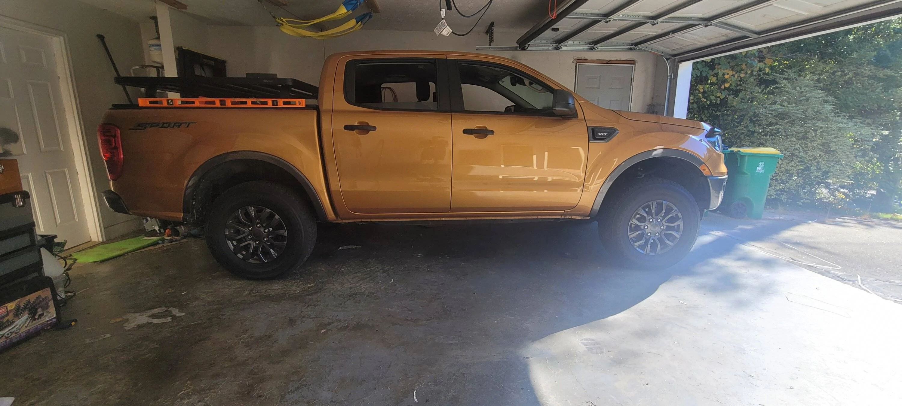

Should I go take a picture of my leveled ranger? Or am I just imagining that it is level. Also at 6'1" I have to say that the level of the bed it actually the ideal height.

I mean no protractor but that's gotta count for something. Does have the fox coilovers.
