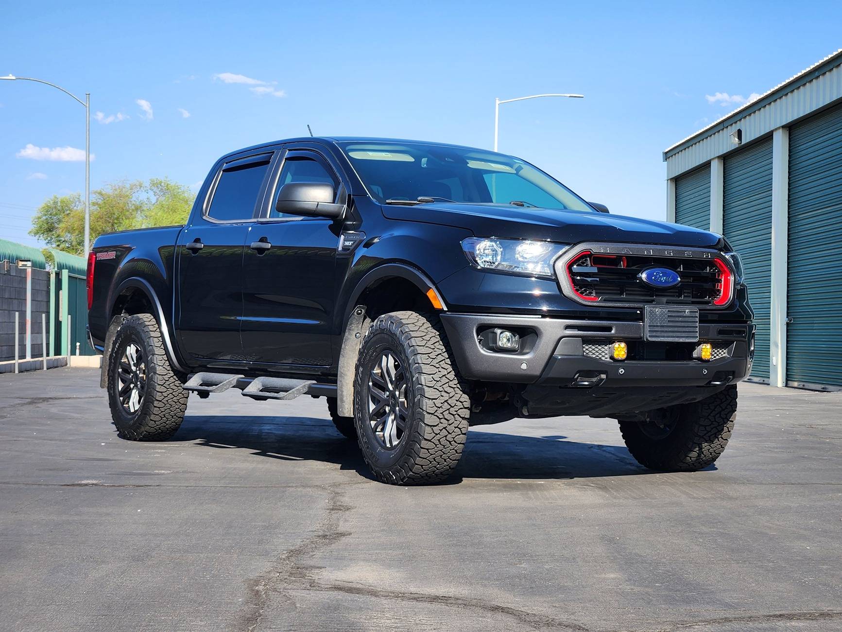

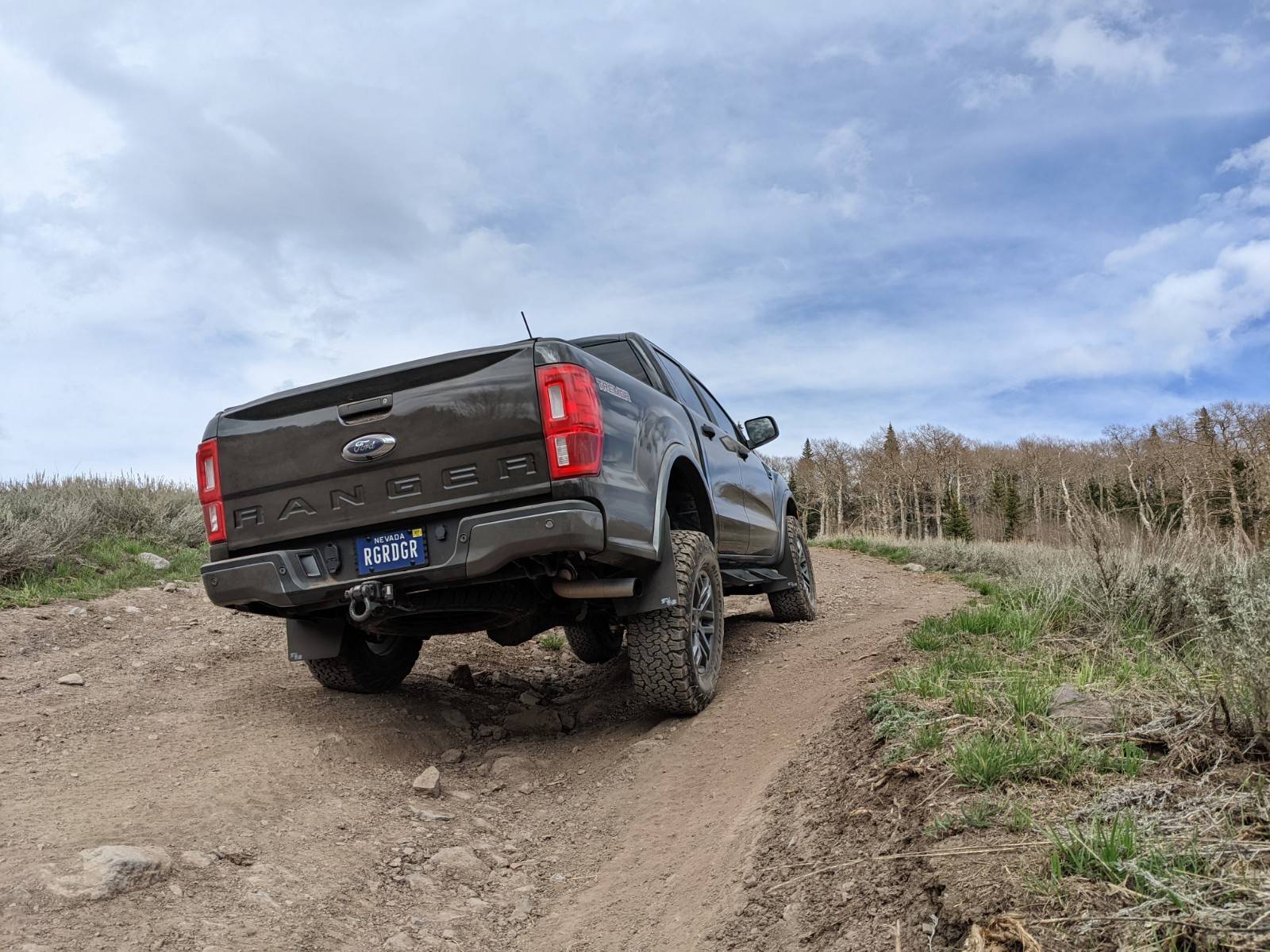

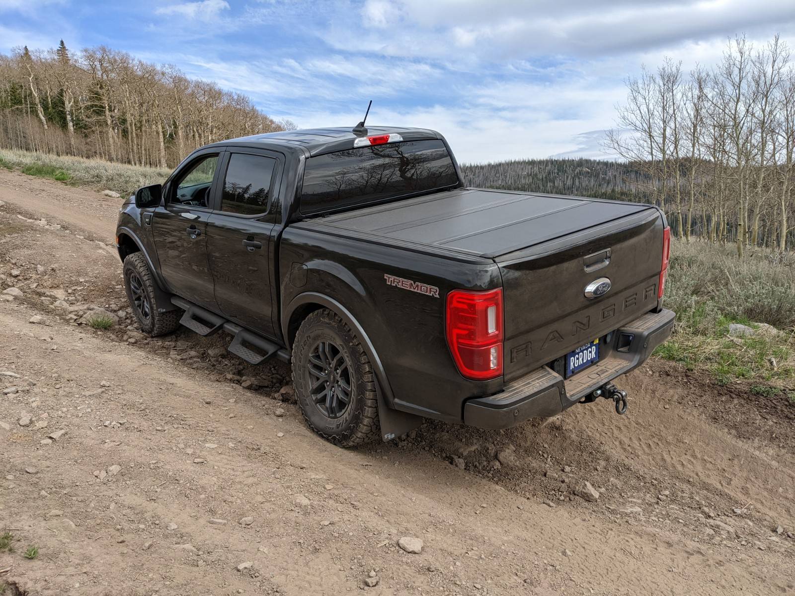

Keep in mind that the FX4 still uses 31's from the factory. It's the same for non FX4 package trucks. The Tremor has 32's from the factory along with front struts that lift it up by 2 inches in the front. The rear has different leaf springs than non Tremor Rangers. It only lifted about .08 at best.
Keep in mind I had my Ranger next to a tremor once(can't remember if I still had 32's or switched to 33's already) and my truck was not that much higher than it(maybe 0.5 in the front) and the rear was much higher due to the Old Man EMU lift. With the way the Tremor is from the Factory there really isn't much else to do at this time.
Yeah I couldn't remember if it was a 1.5" or 2" from Ford but thankfully the 1" spacer has held up well (not prematurely wearing things) since it has at least 55k miles on it.
I know the Tremor package got some hate but I saw it as such a great deal when it came out. Shocks, rear multi-leaf, dash switches and interior alone sold me. Plus the style points with fender flares, red accents, different drive shaft and other little changes were icing on the cake.
