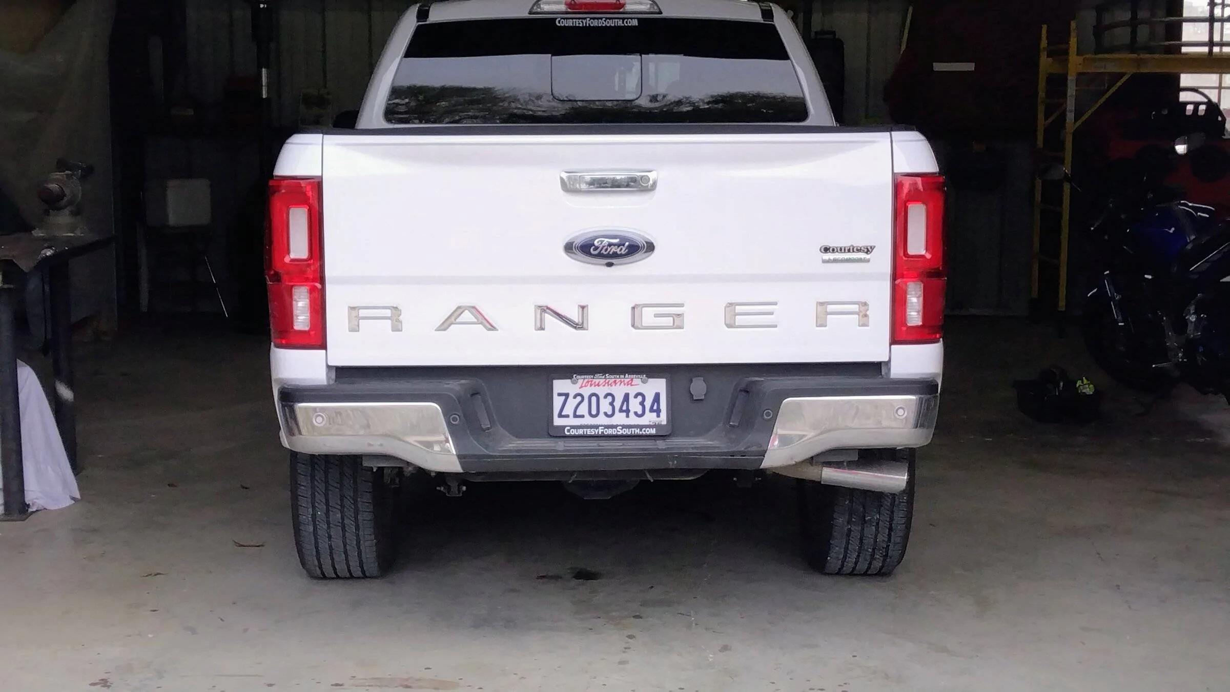

Yes! I just recently noticed a lean on my truck. I'm posting a pic so you can see. I've done nothing to the suspension on my truck. I'm pissed. I've only
got 17k miles
got 17k miles
you might want to look into ordering some of Fords "fix" leaf spring plates. your local ford dealer can order them. i ordered two from memphis, tn factory. you could have ford put one or two on your left rear depending on how bad your lean is
***the factory leaf spring plate "fix" is part#: KB3Z5798A $68.00 a piece
