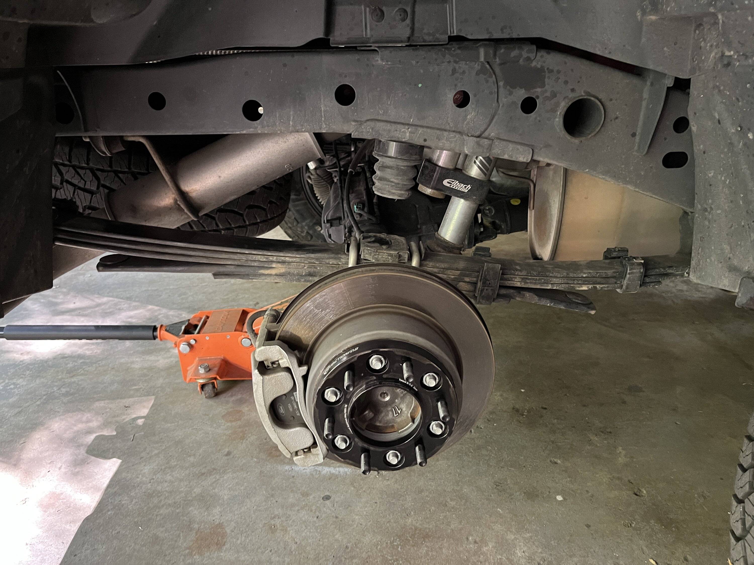

so today after loading up for camping- springs got a solid w shape to them. springs are wrapping themselves around the overload.
Alittle unsure of it. i emailed deaver for suggestions

That can be normal, the overload is there just for that, but if the load exceeds the spring rating then the overload does most of the work, but the name says it all.
The springs can heavily lay on the overloads, but if the spring lays on the ends of the overload and still droops down, so the spring is bend over the end of the overload, that would concern me.
I will say the guy at Deavers is no dummy, they are one of the better spring shops I have been in, he may suggest an additional leaf or two.

more recent observations- sitting almost 3/4” to 1” lower on drivers side. something is up.
i’m going to dig in it this weekend.
might be time to swap to a pair of tremors or just spend the money on deavers.

My tremor leaf pack is sitting lower on drivers side about the same. Noisy as heck too so I took the isolator pads out and put in some neoprene rubber to quiet them down

i found my problem. damn garage floor was a shit pour. floor ain’t level.
i also recently upgraded to tremor springs- got new ones from the dealer. I do feel they are a bit softer, but definitely don’t have the droop the globals do.
